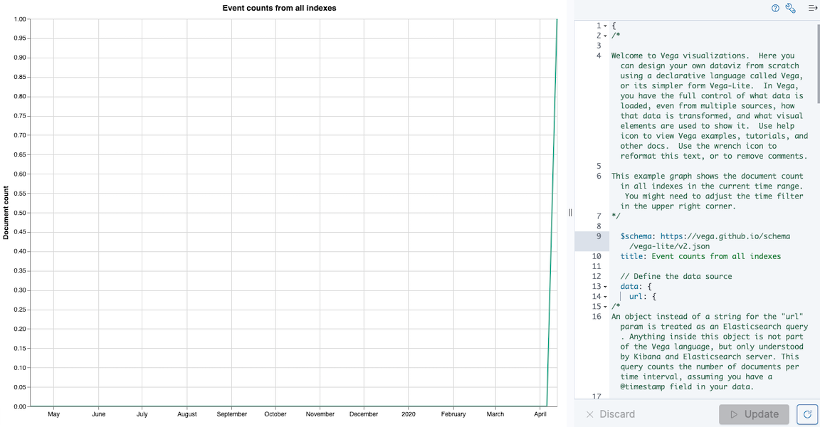

When you first open the Vega editor in Kibana, you will see a pre-populated line chart which shows the total number of documents across all your indices within the time range.
The text editor contains a Vega-Lite spec written in HJSON, which is similar to JSON but optimized for human editing. HJSON supports:

Small steps
editAlways work on Vega in the smallest steps possible, and save your work frequently. Small changes will cause unexpected results. Click the "Save" button now.
The first step is to change the index to one of the sample data sets. Change
index: _all
to:
index: kibana_sample_data_ecommerce
Click "Update". The result is probably not what you expect. You should see a flat line with 0 results.
You’ve only changed the index, so the difference must be the query is returning no results. You can try the Vega debugging process, but intuition may be faster for this particular problem.
In this case, the problem is that you are querying the field @timestamp,
which does not exist in the kibana_sample_data_ecommerce data. Find and replace
@timestamp with order_date. This fixes the problem, leaving you with this spec:

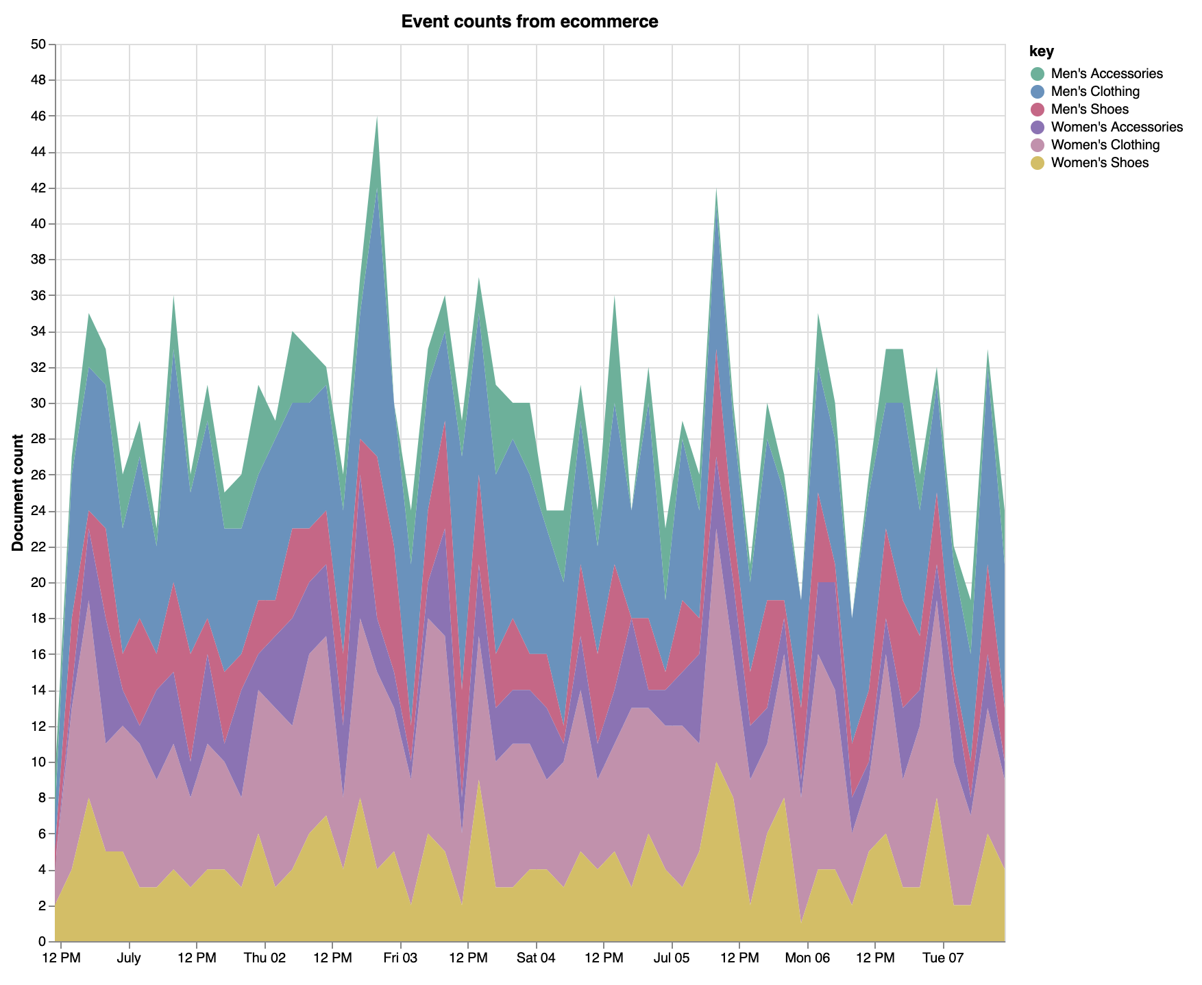

Now, let’s make the visualization more interesting by adding another aggregation to create a stacked area chart. To verify that you have constructed the right query, it is easiest to use the Kibana Dev Tools in a separate tab from the Vega editor. Open the Dev Tools from the Management section of the navigation.
This query is roughly equivalent to the one that is used in the default Vega-Lite spec. Copy it into the Dev Tools:

At this point, you have a stacked area chart that shows the top categories, but the chart is still missing some common features that we expect from a Kibana visualization. Let’s add hover states and tooltips next.

The final result of this tutorial is this spec:
Expand final Vega-Lite spec
