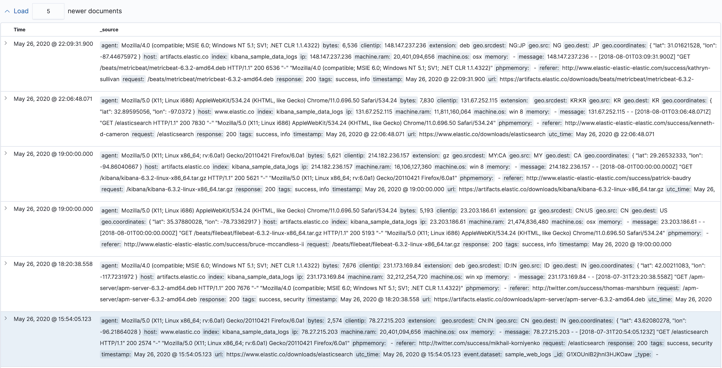

Once you’ve narrowed your search to a specific event, you might want to inspect the documents that occurred immediately before and after the event. With the Context view, you can do just that for index patterns that contain time-based events.
To open the Context view, click the expand icon (<) in the document table, and then click View surrounding documents.
The documents are sorted by the time field specified in the index pattern and displayed using the same set of columns as the Discover view from which the context was opened. The anchor document is highlighted in blue.
Context View

Change the number of surrounding documentsedit
By default, the five newest and oldest documents are listed. To increase the number of documents that surround the anchor document, click Load. Five documents are added with each click.
