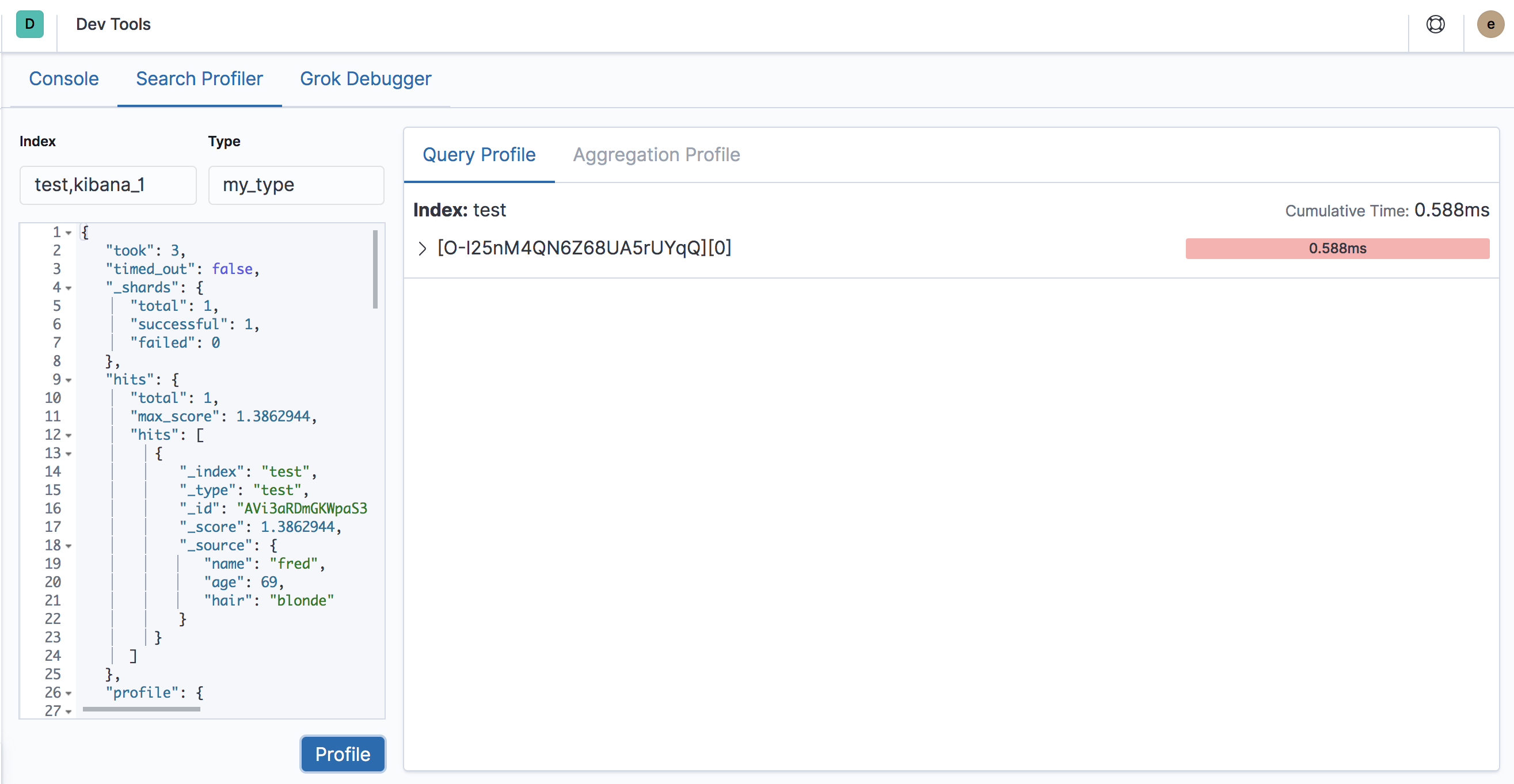

Index and type filteringedit
By default, all queries executed by the Search Profiler are sent to GET /_search. It searches across your entire cluster (all indices, all types).
If you need to query a specific index or type (or several), you can use the Index and Type filters.
In the following example, the query is executed against the indices test and kibana_1 and the type my_type. This is equivalent making a request to GET /test,kibana_1/my_type/_search.
Filtering by index and type
