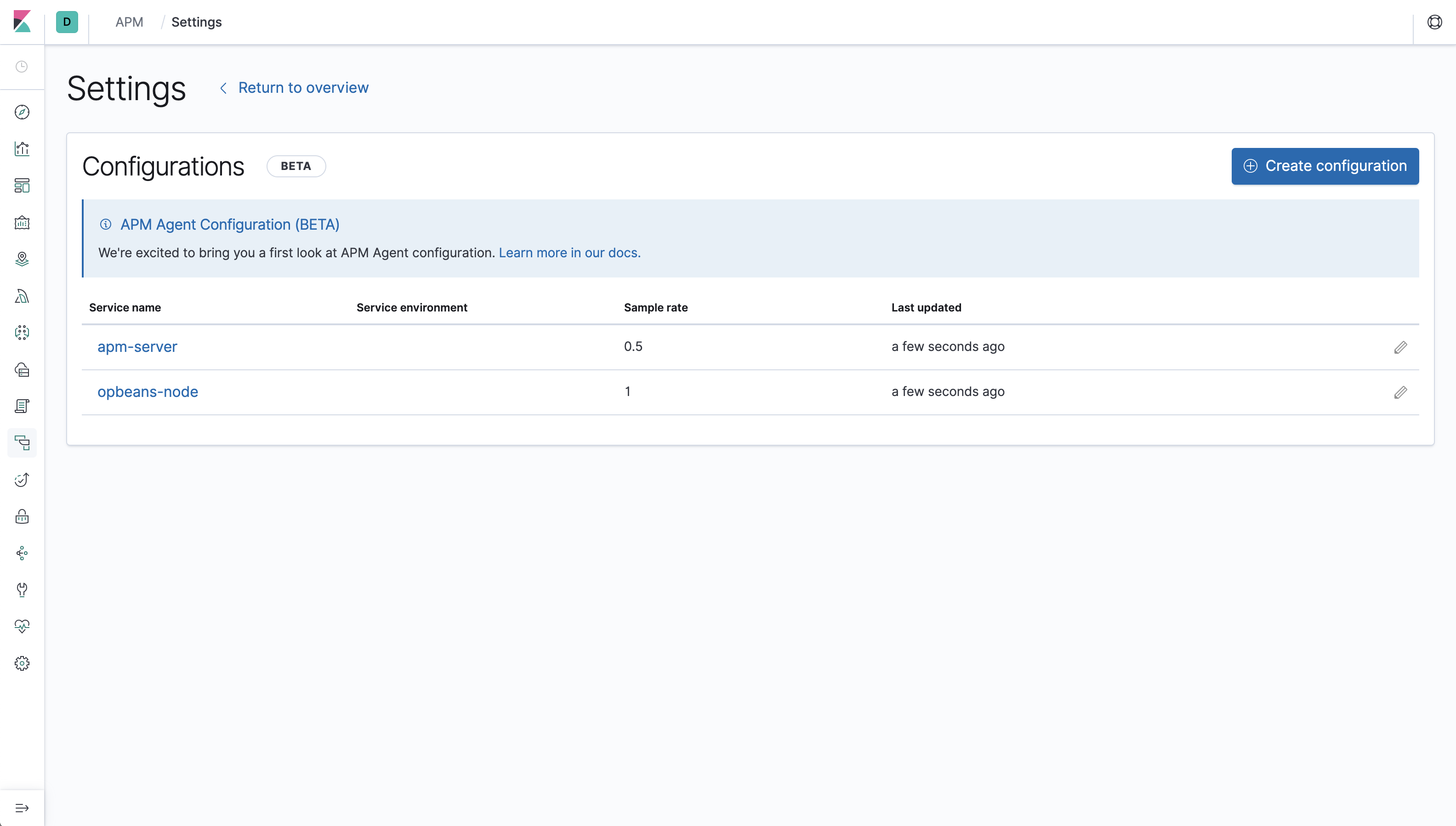

[beta] This functionality is in beta and is subject to change. The design and code is less mature than official GA features and is being provided as-is with no warranties. Beta features are not subject to the support SLA of official GA features. APM Agent configuration allows you to fine-tune your agent configuration directly in Kibana. Best of all, changes are automatically propagated to your APM agents so there’s no need to redeploy.
To get started, simply choose the service and environment you wish to configure.
![APM Agent configuration in Kibana](apm/images/apm-agent-configuration.png)
As this feature is in Beta, a limited number of configuration settings are supported. We recommend you watch your agent logs to confirm that configuration has been applied. If you have feedback, please reach out in our Discuss forum.
