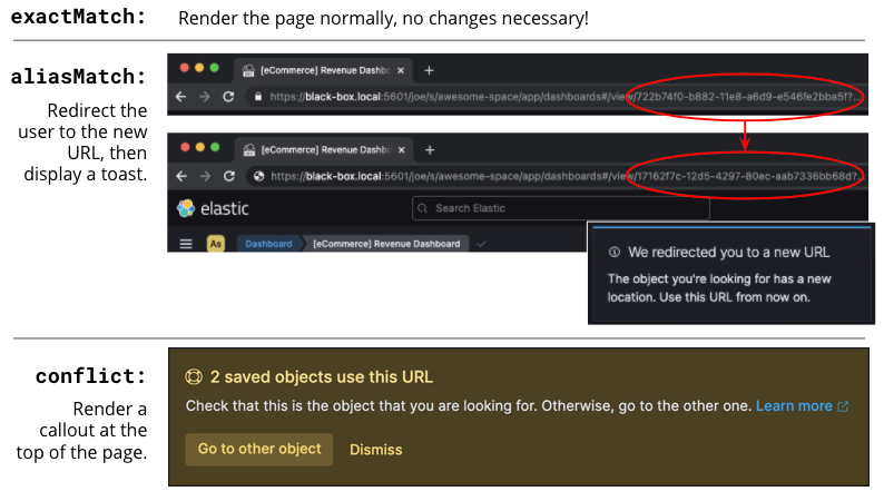

Update your client-side code to correctly handle the three different
resolve()
outcomes
The Spaces plugin API exposes React components and functions that you should use to render your UI in a consistent manner for end-users. Your UI will need to use the Core HTTP service and the Spaces plugin API to do this.
Your page should change according to the outcome:
![Sharing Saved Objects resolve outcomes overview](images/sharing-saved-objects-step-3.png)
See an example of this in step 3 of the POC!

5. Why are there three different resolve outcomes?edit
The resolve()
function checks both if an object with the given ID exists, and if an object has an alias with the given ID.
If only the former is true, the outcome is an
'exactMatch'
— we found the exact object we were looking for. -
If only the latter is true, the outcome is an
'aliasMatch'
— we found an alias with this ID, that pointed us to an object with a different ID. -
Finally, if both conditions are true, the outcome is a
'conflict'
— we found two objects using this ID. Instead of returning an error in this situation, in the interest of usability, we decided to return the most correct match, which is the exact match. By informing the consumer that this is a conflict, the consumer can render an appropriate UI to the end-user explaining that this might not be the object they are actually looking for.

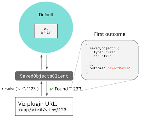

Outcome 1
When you resolve an object with its current ID, the outcome is an 'exactMatch'
![Sharing Saved Objects resolve outcome 1 (exactMatch)](images/sharing-saved-objects-faq-resolve-outcomes-1.png)
This can happen in the Default space and in non-Default spaces.

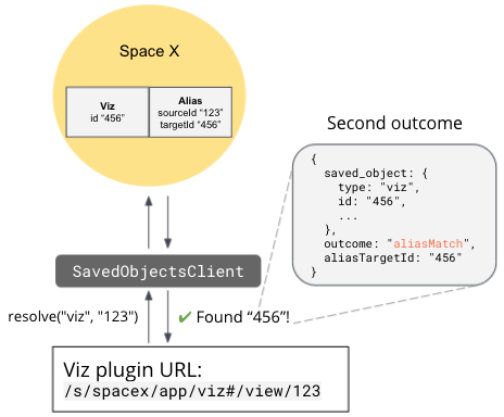

Outcome 2
When you resolve an object with its old ID (the ID of its alias), the outcome is an 'aliasMatch'
![Sharing Saved Objects resolve outcome 2 (aliasMatch)](images/sharing-saved-objects-faq-resolve-outcomes-2.png)
