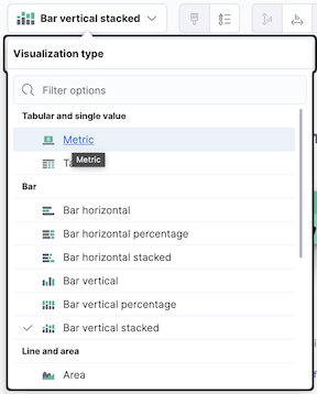

  1. Open the Visualization type dropdown, then select Metric.

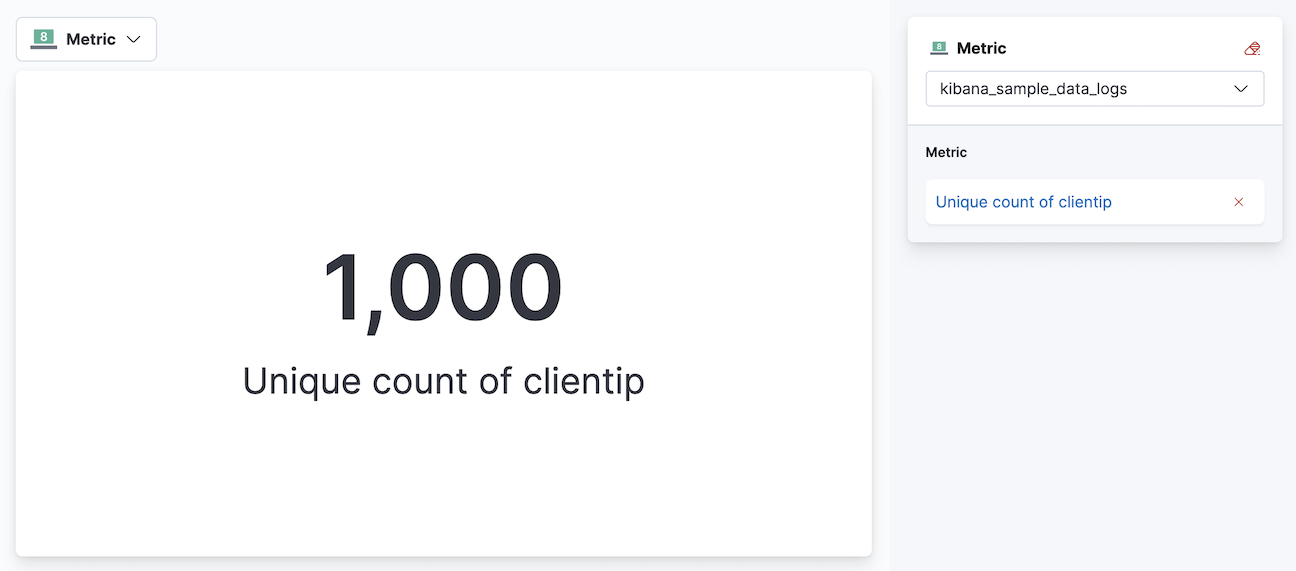

  2. From the Available fields list, drag clientip to the workspace or layer pane.
    Metric visualization of the clientip field
    In the layer pane, Unique count of clientip appears because the editor automatically applies the Unique count function to the clientip field. Unique count is the only numeric function that works with IP addresses.
  3. In the layer pane, click Unique count of clientip.

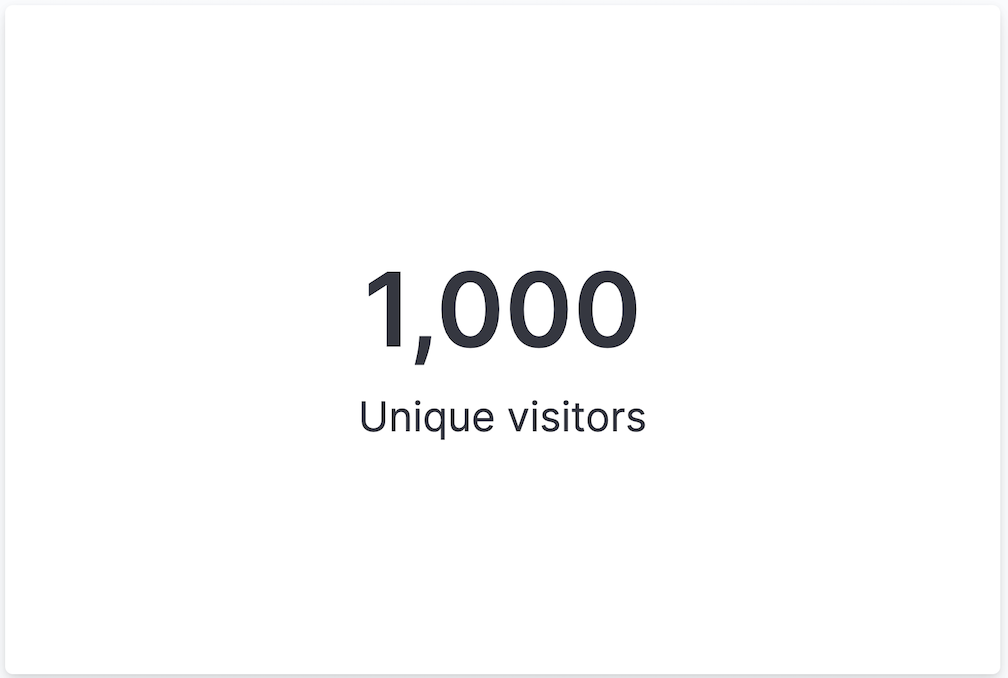

    1. In the Display name field, enter Unique visitors.
    2. Click Close.
      Metric visualization that displays number of unique visitors
  4. Click Save and return.
    [No Title] appears in the visualization panel header. Since the visualization has its own Unique visitors label, you do not need to add a panel title.

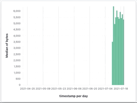

  2. From the Available fields list, drag bytes to the workspace.
    The visualization editor creates a bar chart with the timestamp and Median of bytes fields.
  3. To zoom in on the data, click and drag your cursor across the bars.
    Zoom in on the data

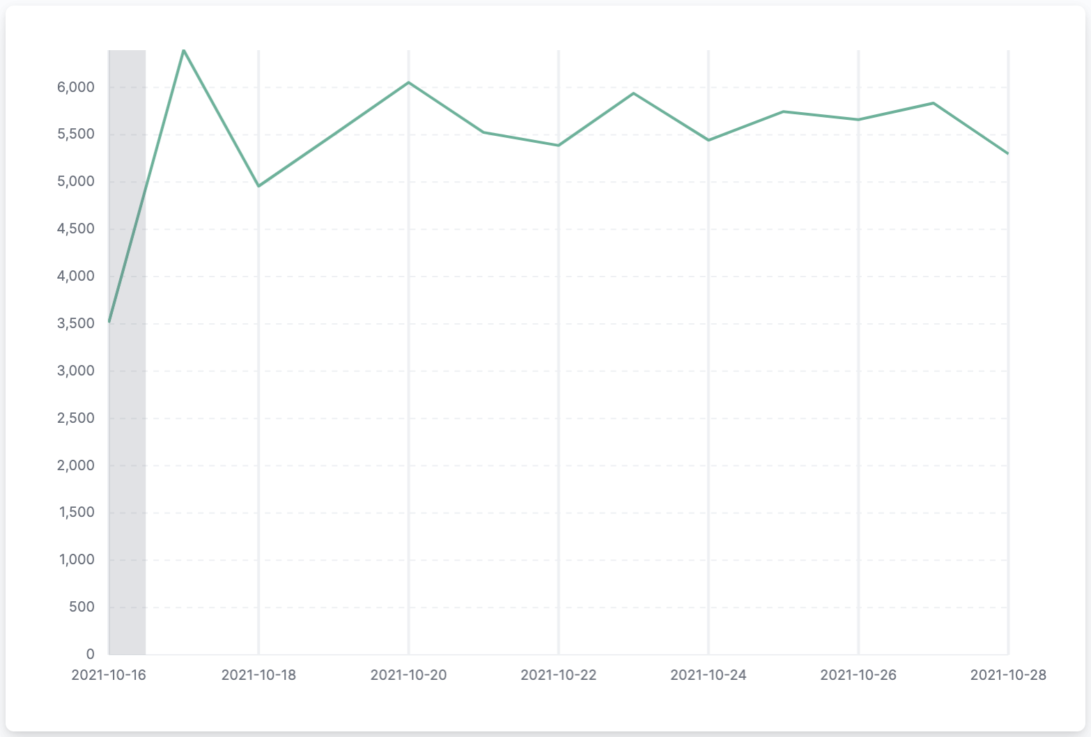

To emphasize the change in Median of bytes over time, change the visualization type to Line with one of the following options:
  • In the Suggestions, click the line chart.
  • In the editor toolbar, open the Visualization type dropdown, then select Line.
  • In the layer pane, open the Layer visualization type menu, then click Line.
To increase the minimum time interval:
  1. In the layer pane, click timestamp.
  2. Select Customize time interval.
  3. Change the Minimum interval to 1 days, then click Close.
    You can increase and decrease the minimum interval, but you are unable to decrease the interval below the Advanced Settings.

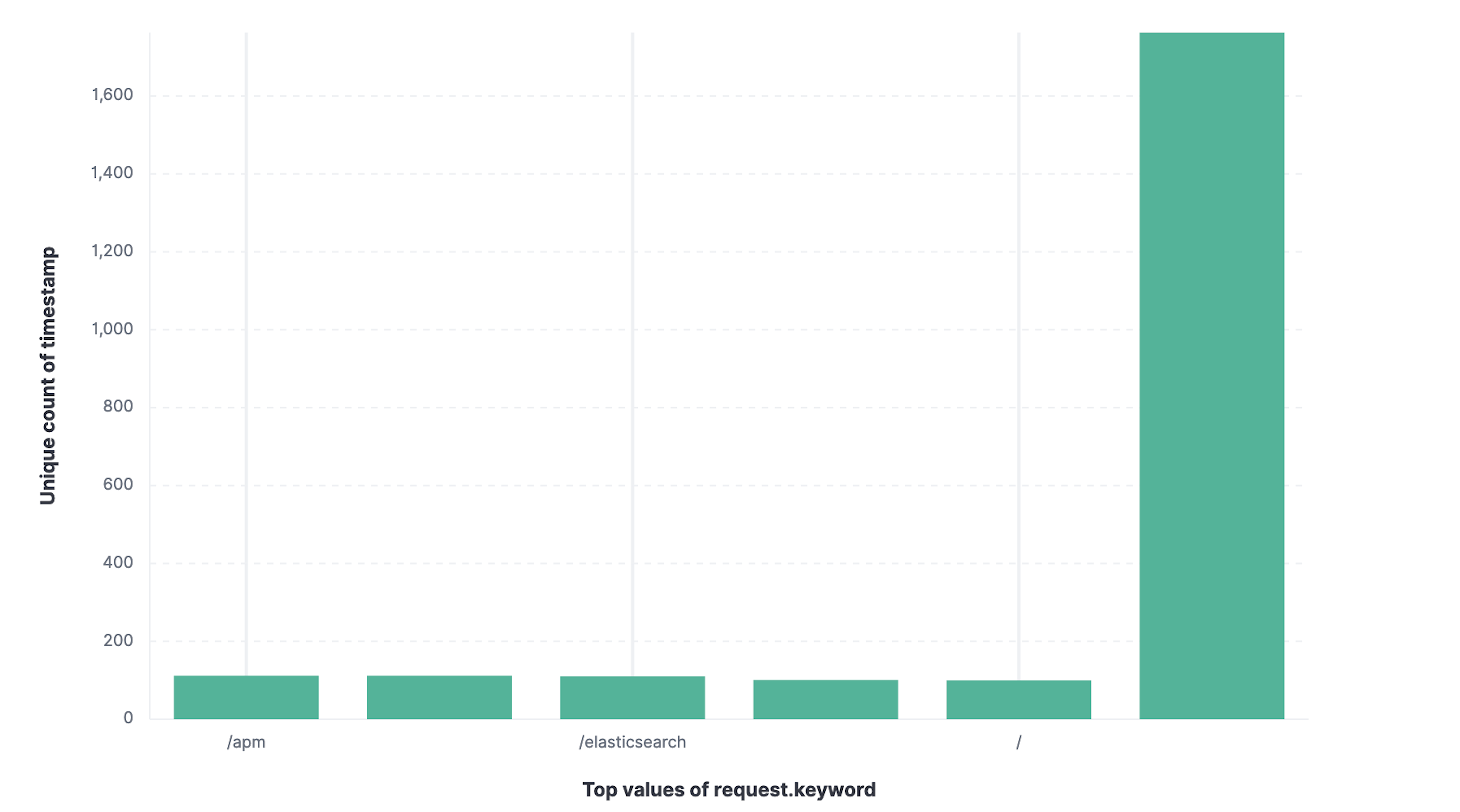

Create a visualization that displays the most frequent values of request.keyword on your website, ranked by the unique visitors. To create the visualization, use Top values of request.keyword ranked by Unique count of clientip, instead of being ranked by Count of records.
The Top values function ranks the unique values of a field by another function. The values are the most frequent when ranked by a Count function, and the largest when ranked by the Sum function.
  1. On the dashboard, click Create visualization.
  2. From the Available fields list, drag clientip to the Vertical axis field in the layer pane.
    The visualization editor automatically applies the Unique count function. If you drag clientip to the workspace, the editor adds the field to the incorrect axis.
  3. Drag request.keyword to the workspace.
    Vertical bar chart with top values of request.keyword by most unique visitors
    When you drag a text or IP address field to the workspace, the editor adds the Top values function ranked by Count of records to show the most frequent values.

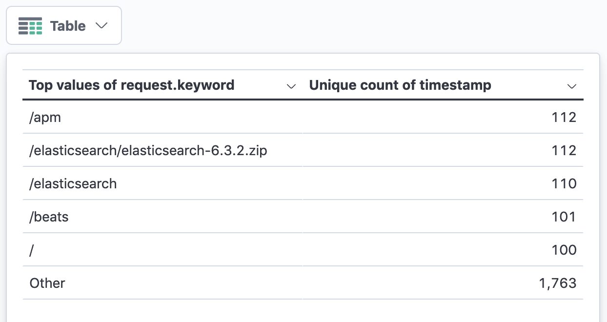

The chart labels are unable to display because the request.keyword field contains long text fields. You could use one of the Suggestions, but the suggestions also have issues with long text. The best way to display long text fields is with the Table visualization.

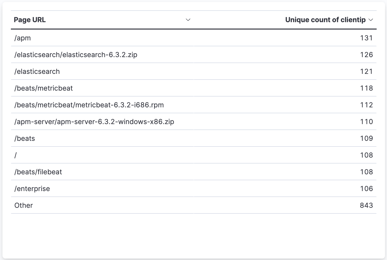

  1. Open the Visualization type dropdown, then select Table.
    Table with top values of request.keyword by most unique visitors
  2. In the layer pane, click Top values of request.keyword.
    1. In the Number of values field, enter 10.
    2. In the Display name field, enter Page URL.
    3. Click Close.
      Table that displays the top field values
  3. Click Save and return.
    Since the table columns are labeled, you do not need to add a panel title.

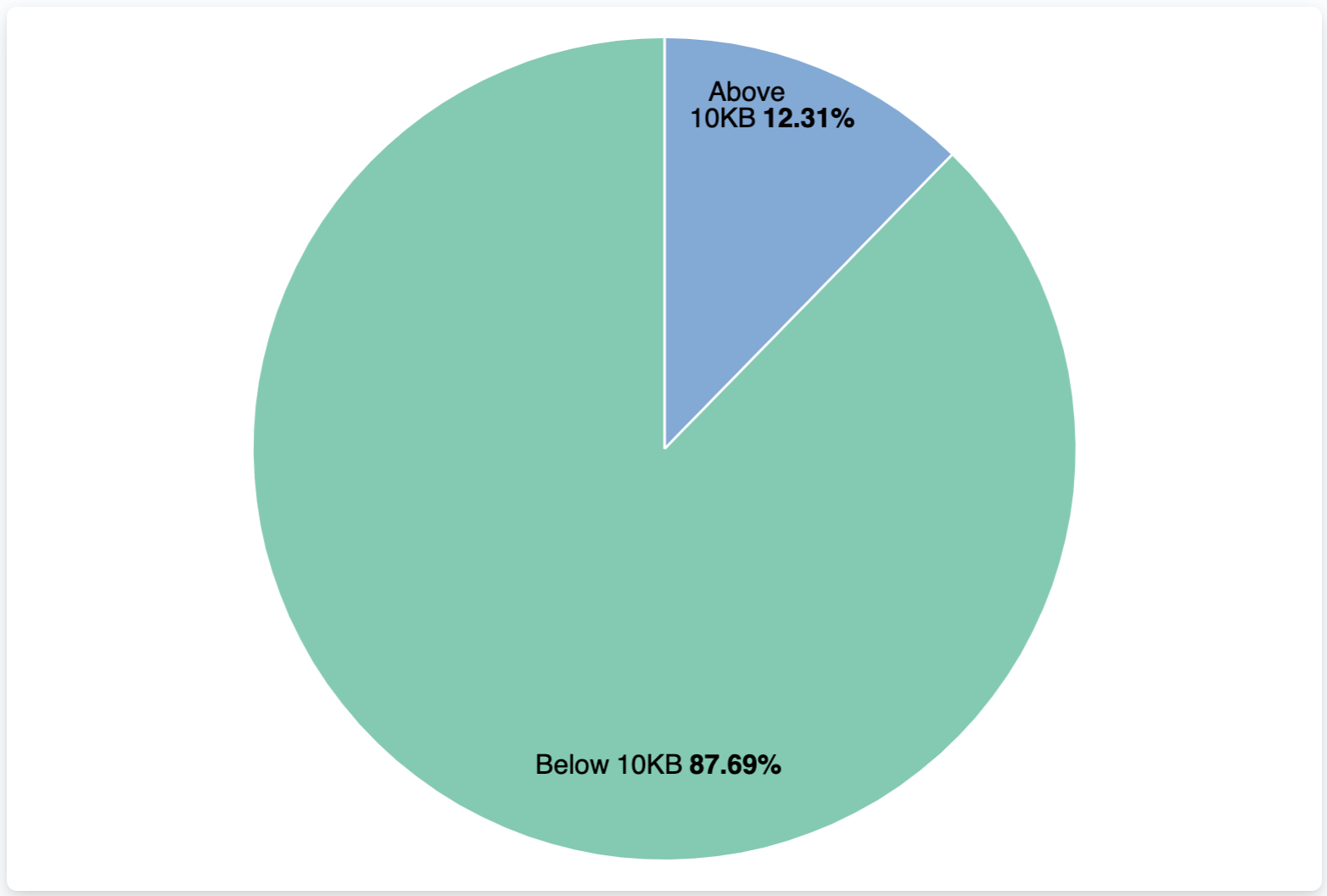

Create a proportional visualization that helps you determine if your users transfer more bytes from documents under 10KB versus documents over 10Kb.
  2. From the Available fields list, drag bytes to the Vertical axis field in the layer pane.
  3. Click Median of bytes, click the Sum function, then click Close.
  4. From the Available fields list, drag bytes to the Break down by field in the layer pane.

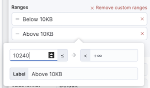

To select documents based on the number range of a field, use the Intervals function. When the ranges are non numeric, or the query requires multiple clauses, you could use the Filters function.
Specify the file size ranges:
  1. In the layer pane, click bytes.
  2. Click Create custom ranges, enter the following in the Ranges field, then press Return:
    • Ranges010240
    • LabelBelow 10KB
  3. Click Add range, enter the following, then press Return:
    • Ranges10240+∞
    • LabelAbove 10KB
      Custom ranges configuration
  4. From the Value format dropdown, select Bytes (1024), then click Close.
To display the values as a percentage of the sum of all values, use the Pie chart.
  1. Open the Visualization Type dropdown, then select Pie.
    Pie chart that compares a subset of documents to all documents
  2. Click Save and return.

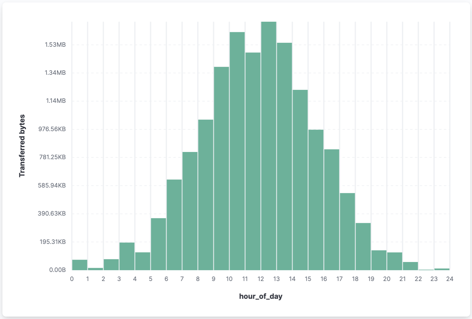

The distribution of a number can help you find patterns. For example, you can analyze the website traffic per hour to find the best time for routine maintenance.
  2. From the Available fields list, drag bytes to Vertical axis field in the layer pane.
  3. In the layer pane, click Median of bytes.
    1. Click the Sum function.
    2. In the Display name field, enter Transferred bytes.
    3. From the Value format dropdown, select Bytes (1024), then click Close.
  4. From the Available fields list, drag hour_of_day to Horizontal axis field in the layer pane.
  5. In the layer pane, click hour_of_day, then slide the Intervals granularity slider until the horizontal axis displays hourly intervals.
    Bar chart that displays the distribution of a number field
  6. Click Save and return.

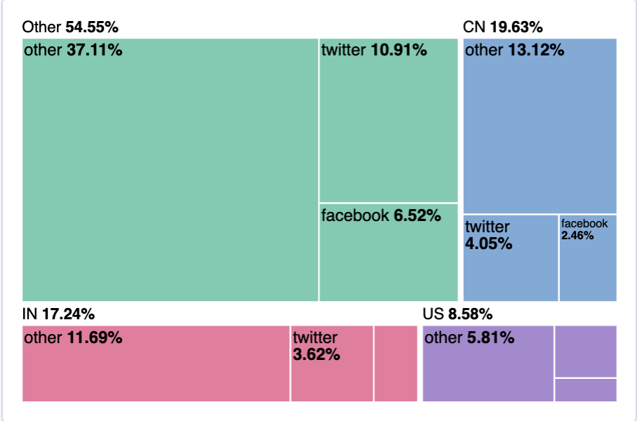

Create a multi-level chartedit

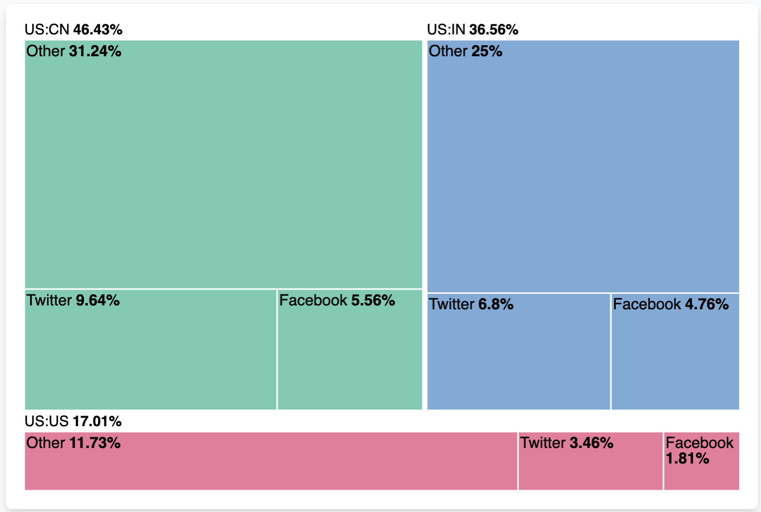

Table and Proportion visualizations support multiple functions. For example, to create visualizations that break down the data by website traffic sources and user geography, apply the Filters and Top values functions.
  2. Open the Visualization type dropdown, then select Treemap.
  3. From the Available fields list, drag Records to the Size by field in the layer pane.
  4. In the editor, click Add or drag-and-drop a field for Group by.
Create a filter for each website traffic source:
  1. From Select a function, click Filters.
  2. Click All records, enter the following in the query bar, then press Return:
    • KQLreferer : *facebook.com*
    • LabelFacebook
  3. Click Add a filter, enter the following in the query bar, then press Return:
    • KQLreferer : *twitter.com*
    • LabelTwitter
  4. Click Add a filter, enter the following in the query bar, then press Return:
    • KQLNOT referer : *twitter.com* OR NOT referer: *facebook.com*
    • LabelOther
  5. Click Close.
Add the user geography grouping:
  1. From the Available fields list, drag geo.srcdest to the workspace.
  2. To change the Group by order, drag Top values of geo.srcdest in the layer pane so that appears first.
    Treemap visualization
Remove the documents that do not match the filter criteria:
  1. In the layer pane, click Top values of geo.srcdest.
  2. Click Advanced, then deselect Group other values as "Other", the click Close.
Add a panel title:
  1. Open the panel menu, then select Edit panel title.
  2. In the Panel title field, enter Page views by location and referrer, then click Save.
