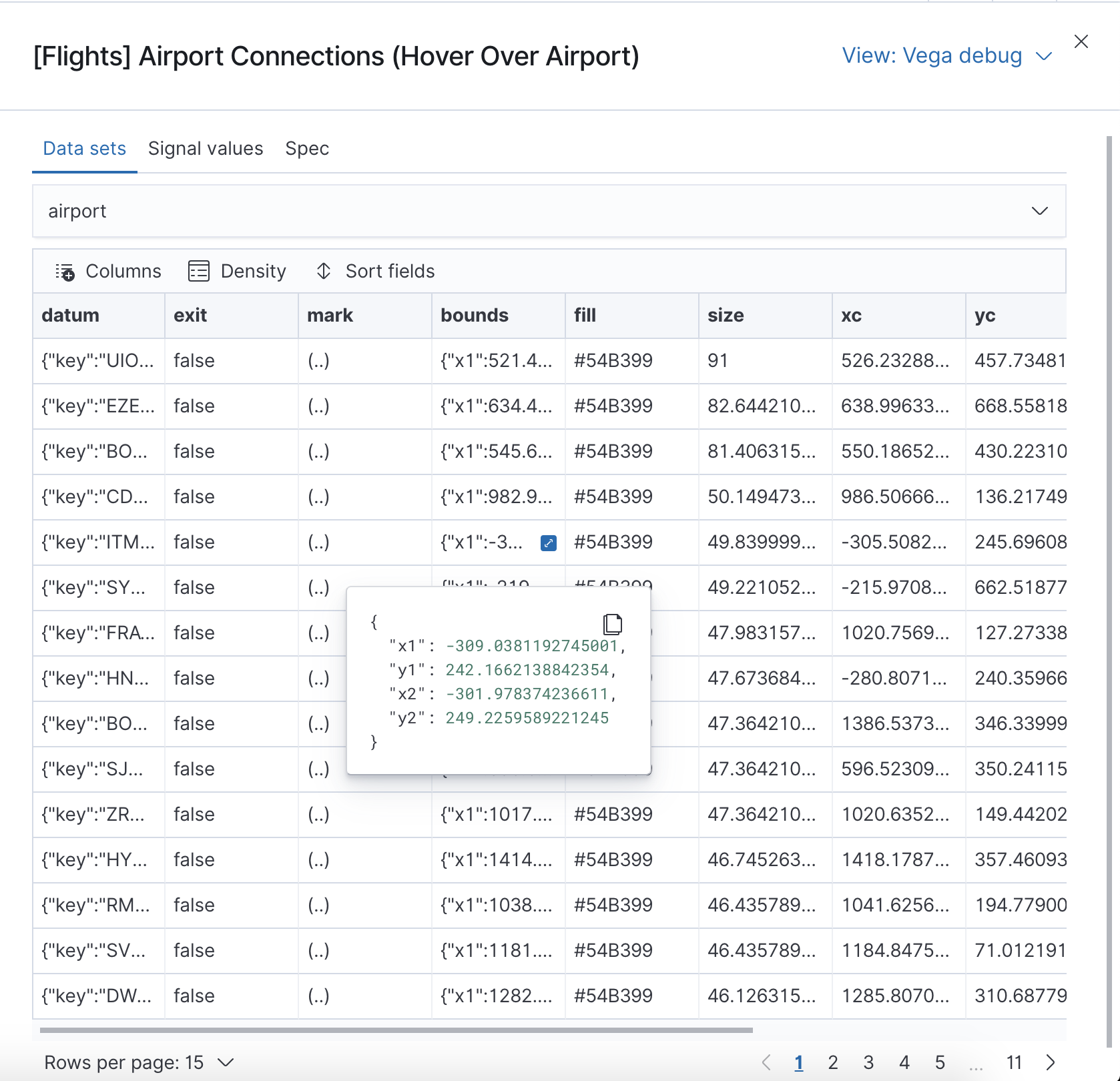

To generate the data, Vega-Lite uses the source_0 and data_0. source_0 contains the results from the Elasticsearch query, and data_0 contains the visually encoded results that are shown on the chart. To debug the warning, compare source_0 and data_0.
  1. In the toolbar, click Inspect.
  2. From the View dropdown, select Vega debug.
  3. From the dropdown, select source_0.
    Table for data_0 with columns key
  4. To compare to the visually encoded data, select data_0 from the dropdown.
    Table for data_0 where the key is NaN instead of a string
    key is unable to convert because the property is category (Men's Clothing, Women's Clothing, etc.) instead of a timestamp.

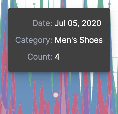

With the Vega-Lite spec, you can add hover states and tooltips to the stacked area chart with the selection block.
In the Vega-Lite spec, add the encoding block, then click Update:
  encoding: {
    tooltip: [{
      field: buckets.key
      type: temporal
      title: "Date"
      field: key
      type: nominal
      title: "Category"
      field: buckets.doc_count
      type: quantitative
      title: "Count"
When you hover over the area series on the stacked area chart, a multi-line tooltip appears, but is unable to indicate the nearest point. To indicate the nearest point, add a second layer.

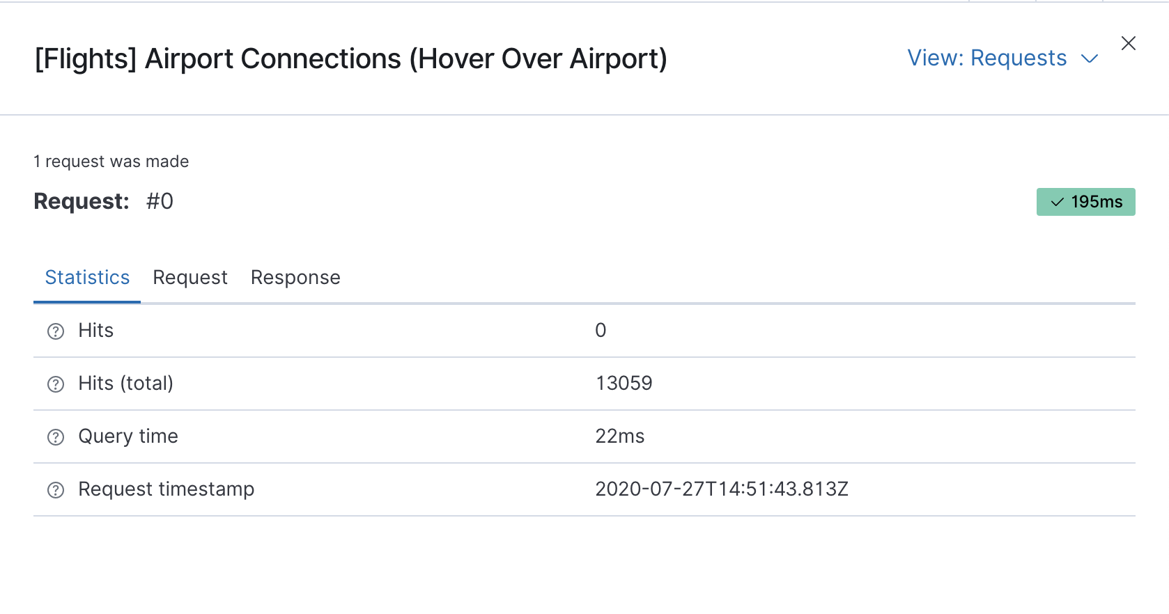

Inspect Elasticsearch requestsedit
Vega uses the Elasticsearch search API to get documents and aggregation results from Elasticsearch. To troubleshoot these requests, click Inspect, which shows the most recent requests. In case your specification has more than one request, you can switch between the views using the View dropdown.
vega tutorial inspect requests
Vega debuggingedit
With the Vega debug view, you can inspect the Data sets and Signal Values runtime data.
The runtime data is read from the runtime scope.
vega tutorial inspect data sets
To debug more complex specs, access to the view variable. For more information, refer to the Vega browser debugging process.

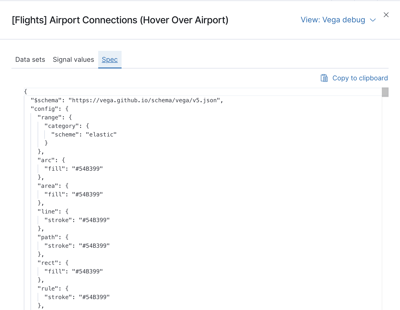

Asking for help with a Vega specedit
Because of the dynamic nature of the data in Elasticsearch, it is hard to help you with Vega specs unless you can share a dataset. To do this, click Inspect, select the Vega debug view, then select Spec.
vega tutorial getting help
To copy the response, click Copy to clipboard. Paste the copied data to gist.github.com, possibly with a .json extension. Use the [raw] button, and share that when asking for help.
