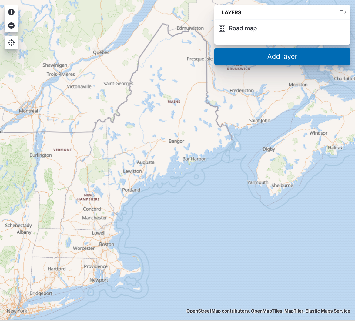

- Create a new map.
Zoom in on the New England area in the northeast United States.
You’re adding flight paths to this area, and this sets up the map for a good view of the data.

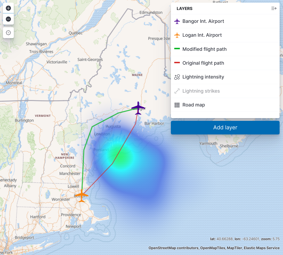

With your new lightning heat map layer, your map should look like this:

When you’ve finished, again be sure to save your work .
Your final map might look like this:
