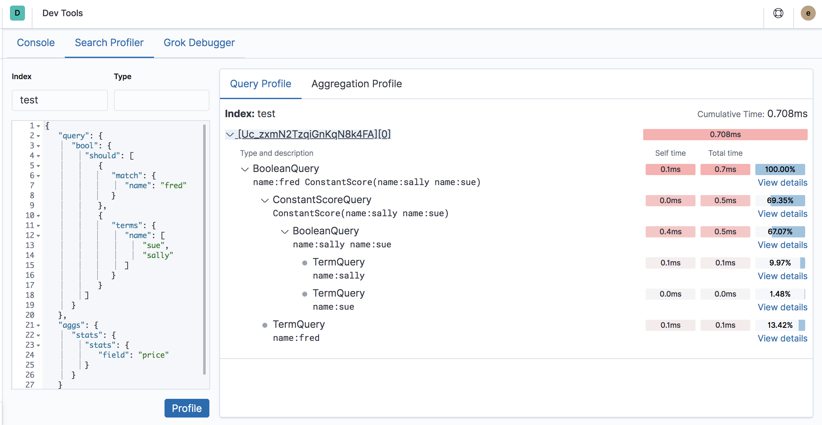

Replace the default
match_all
query in the query editor with a query that has two sub-query components and includes a simple aggregation, like the example below.{ "query": { "bool": { "should": [ { "match": { "name": "fred" } }, { "terms": { "name": [ "sue", "sally" ] } } ] } }, "aggs": { "stats": { "stats": { "field": "price" } } } }
- Click Profile to profile the query and visualize the results.
Select the shard to view the query details.
The detail view contains a row for each query component:
The top-level
BooleanQuery
component corresponds to the bool in the query. -
The second
BooleanQuery
corresponds to the terms query, which is internally converted to aBoolean
of should clauses. It has two child queries that correspond to "sue" and "sally" from the terms query. -
The
TermQuery
that’s labeled with "name:fred" corresponds to match: fred in the query.
If you look at the time columns, you can see that "Self time" and "Total time" are no longer identical on all the rows. Self time represents how long the query component took to execute. Total time is the time a query component and all its children took to execute. Therefore, queries like the Boolean queries often have a larger total time than self time.
