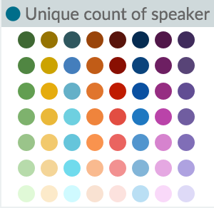

You can customize the colors of your visualization by clicking the color dot next to each label to display the color picker.
