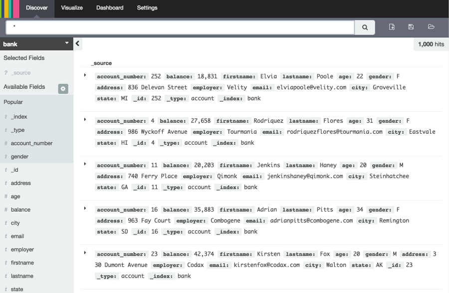

editClick the Discover tab to display Kibana’s data discovery functions:
Right under the tab itself, there is a search box where you can search your data. Searches take a specific query syntax that enable you to create custom searches, which you can save and load by clicking the buttons to the right of the search box.
Beneath the search box, the current index pattern is displayed in a drop-down. You can change the index pattern by selecting a different pattern from the drop-down selector.

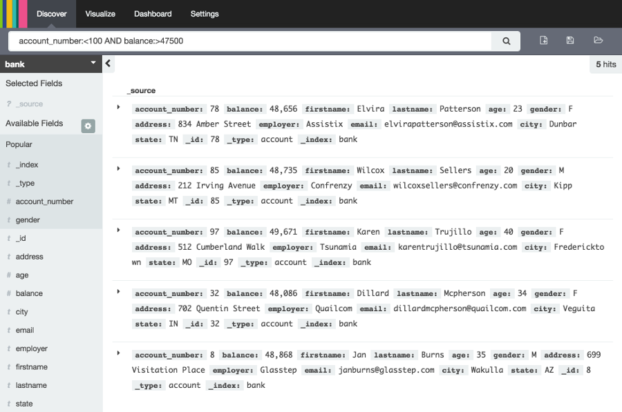

Try selecting the ba* index pattern and putting the following search into the search box:
account_number:<100 AND balance:>47500
This search returns all account numbers between zero and 99 with balances in excess of 47,500.
If you’re using the linked sample data set, this search returns 5 results: Account numbers 8, 32, 78, 85, and 97.

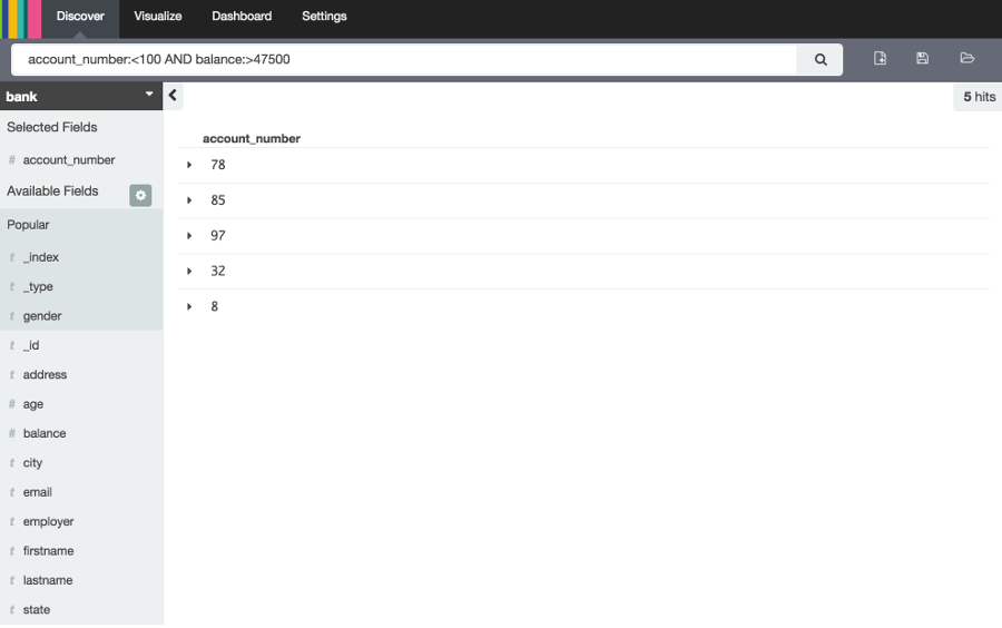

To narrow the display to only the specific fields of interest, highlight each field in the list that displays under the
index pattern and click the Add button. Note how, in this example, adding the account_number field changes the
display from the full text of five records to a simple list of five account numbers:
