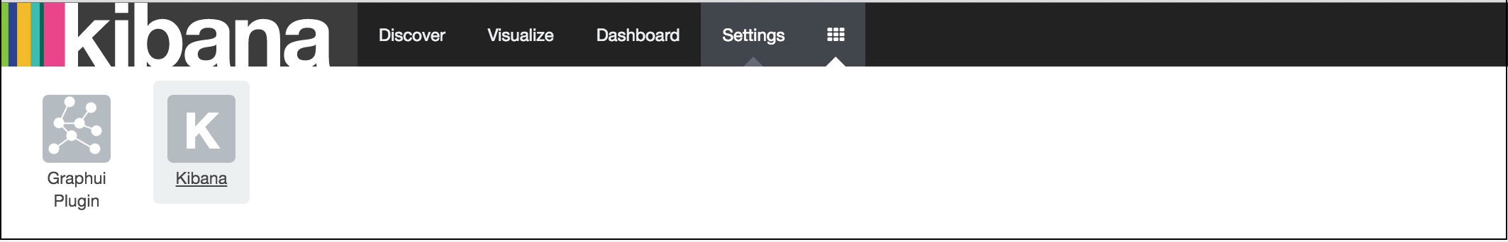

  6. To verify your Graph installation, point your web browser at http://localhost:5601/ to open Kibana, click the App Switcher icon in the Kibana menu bar, and select Graph.
    Accessing Graph
