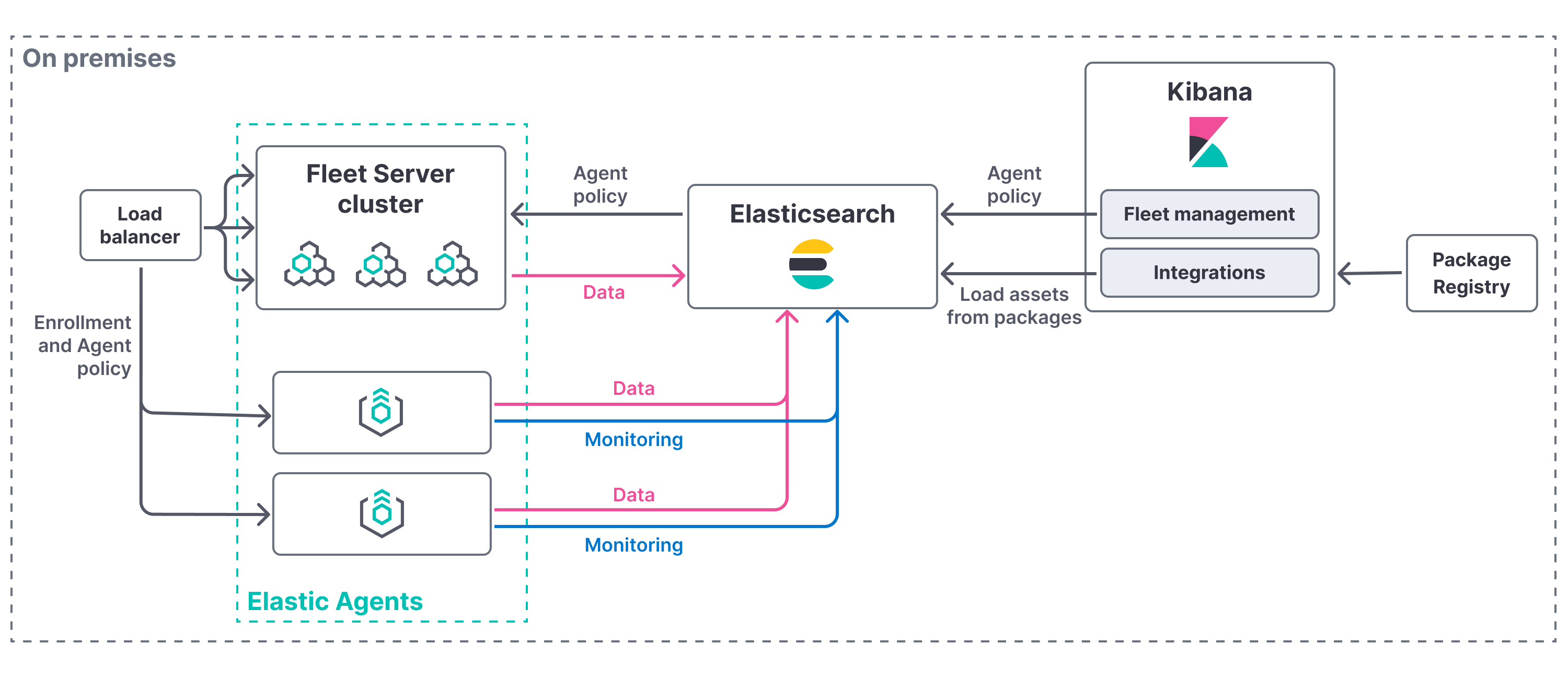

When using this approach, it’s recommended that you provision multiple instances of the Fleet Server and use a load balancer to better scale the deployment. You also have the option to use your organization’s certificate to establish a secure connection from Fleet Server to Elasticsearch.
![Fleet Server on-premises deployment model](images/fleet-server-on-prem-deployment.png)

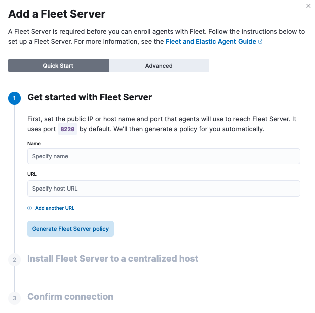

- In Fleet, open the Agents tab.
- Click Add Fleet Server.
This opens in-product instructions to add a Fleet Server using one of two options: Quick Start or Advanced.
Use Quick Start if you want Fleet to generate a Fleet Server policy and enrollment token for you. The Fleet Server policy will include a Fleet Server integration plus a system integration for monitoring Elastic Agent. This option generates self-signed certificates and is not recommended for production use cases.
