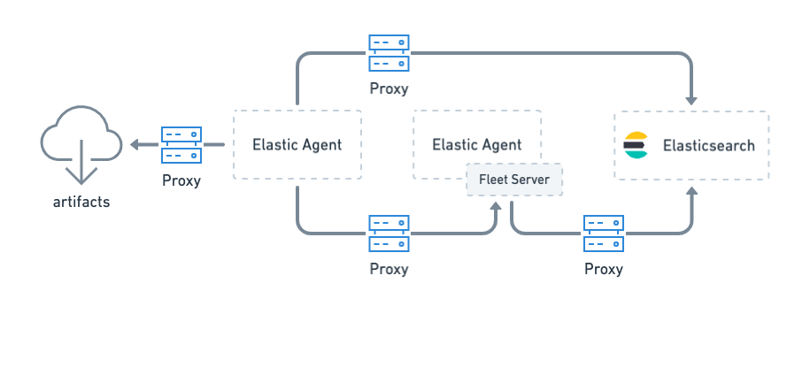

Configure proxy settings for Elastic Agent when it must connect through a proxy server to:
  • Download artifacts from artifacts.elastic.co for subprocesses or binary upgrades
  • Send data to Elasticsearch
  • Retrieve agent policies from Fleet Server
  • Retrieve agent policies from Elasticsearch (only needed for agents running Fleet Server)
Image showing connections between Elastic Agent

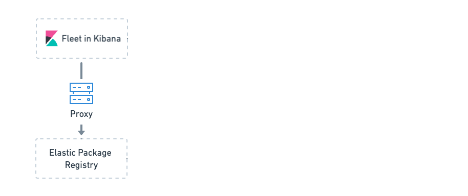

If Fleet is unable to access the Elastic Package Registry because Kibana is behind a proxy server, you may also need to set the registry proxy URL in the Kibana configuration.
Image showing connections between Fleet and the Elastic Package Registry

Set the proxy URL of the Elastic Package Registryedit
Fleet might be unable to access the Elastic Package Registry because Kibana is behind a proxy server.
Also your organization might have network traffic restrictions that prevent Kibana from reaching the public Elastic Package Registry (EPR) endpoints, like epr.elastic.co, to download package metadata and content. You can route traffic to the public endpoint of EPR through a network gateway, then configure proxy settings in the Kibana configuration file, kibana.yml. For example:
xpack.fleet.registryProxyUrl: your-nat-gateway.corp.net
