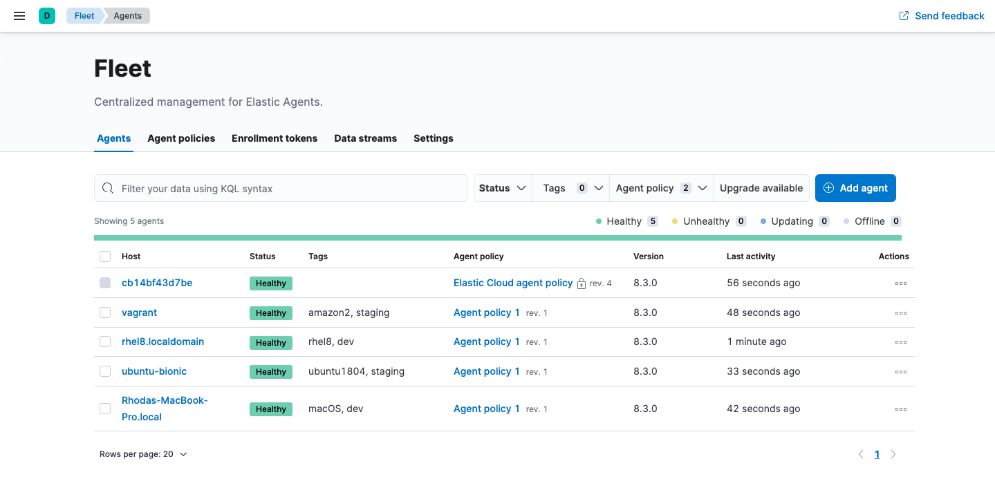

To confirm that Elastic Agent is installed and running, go to the Agents tab in Fleet.
If the status hangs at Enrolling, make sure the elastic-agent process
is running.
