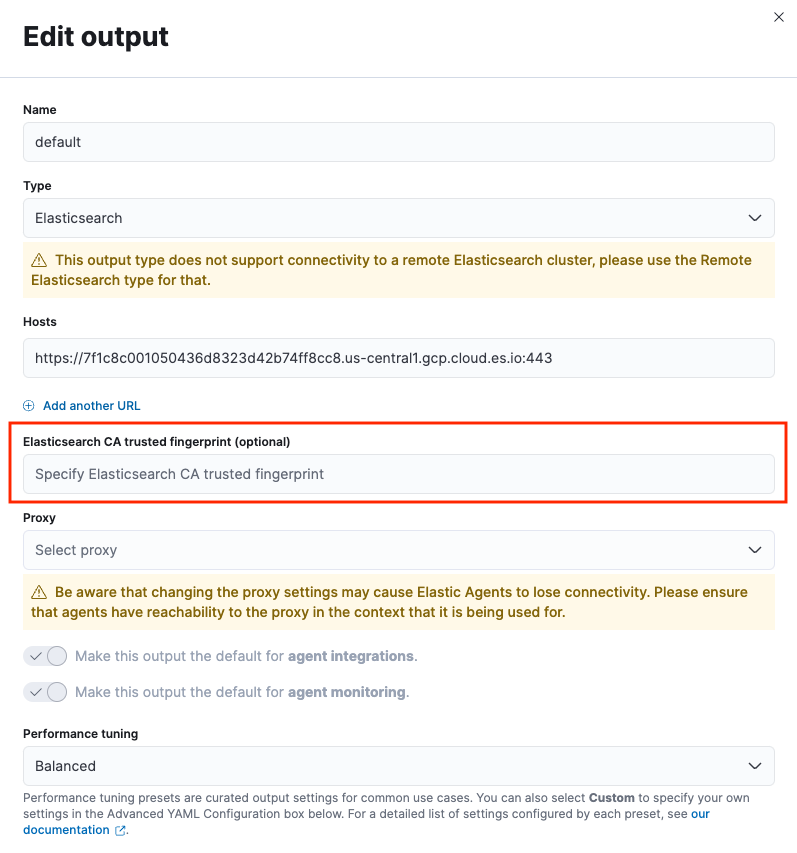

- In Fleet open the Settings tab.
- In the Outputs section, click the edit button for the Elasticsearch output that requires a certificate rotation.
In the Elasticsearch CA trusted fingerprint field, add the new trusted fingerprint to use. This is the SHA-256 fingerprint (hash) of the certificate authority used to self-sign Elasticsearch certificates. This fingerprint will be used to verify self-signed certificates presented by Elasticsearch.
If this certificate is present in the chain during the handshake, it will be added to the
certificate_authoritieslist and the handshake will continue normally.
