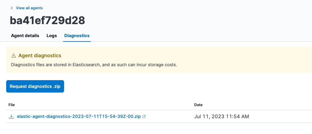

Get the diagnostics bundle through Fleet
Fleet provides the ability to remotely generate and gather an Elastic Agent’s diagnostics bundle.
An agent can gather and upload diagnostics if it is online in a Healthy
or Unhealthy
state. The diagnostics are sent to Fleet Server which in turn adds it into Elasticsearch. Therefore, this works even with Elastic Agents that are not using the Elasticsearch output.
To download the diagnostics bundle for local viewing:
- In Kibana, go to Management → Fleet → Agents.
- In the Host column, click the agent’s name.
- Click the Diagnostics tab.
Click the Request diagnostics .zip button.
Any in-progress or previously collected bundles for the Elastic Agent will be listed on this page.
Note that the bundles are stored in Elasticsearch and will be removed after 30 days.
