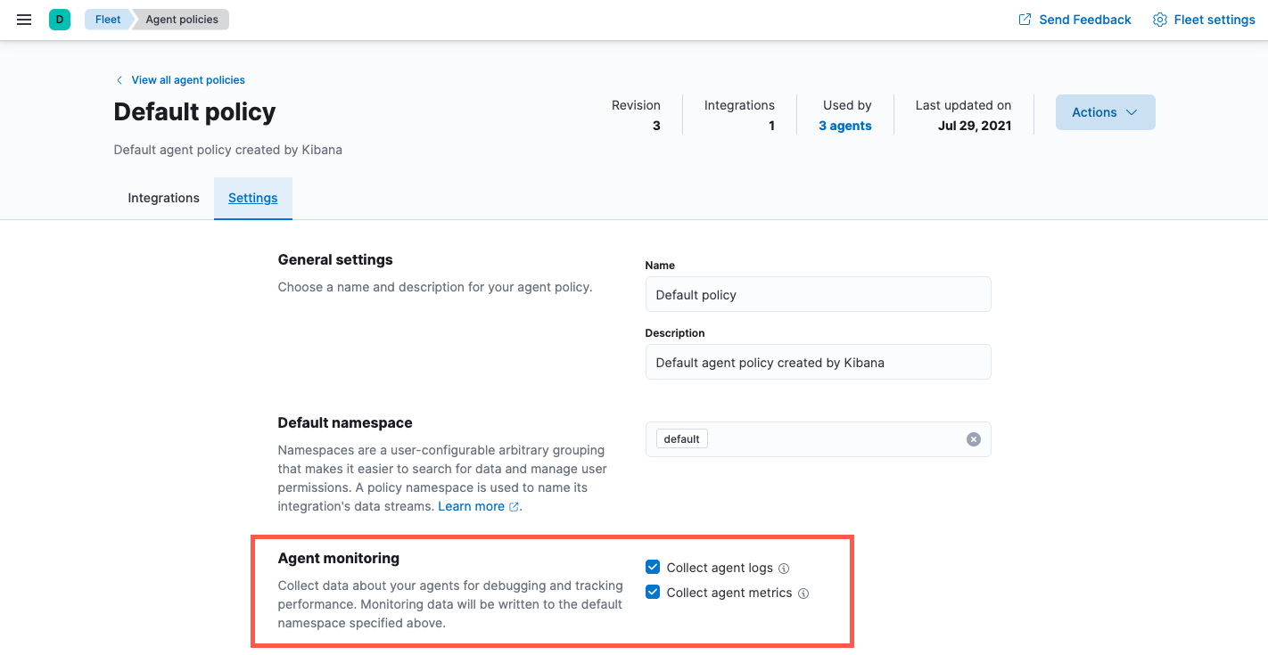

You configure the collection of agent metrics in the agent policy. If metrics collection is selected (the default), all Elastic Agents enrolled in the policy will send metrics data to Elasticsearch (the output is configured globally).
The following image shows the Agent monitoring settings for the default agent policy:
![Screen capture of agent monitoring settings in the default agent policy](images/agent-monitoring-settings.png)

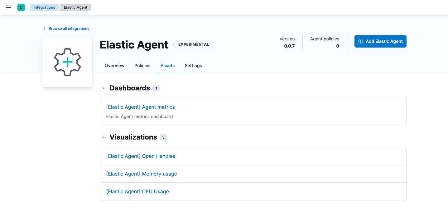

There are also pre-built dashboards for agent metrics that you can access under Assets in the Elastic Agent integration:
![Screen capture of Elastic Agent monitoring assets](images/agent-monitoring-assets.png)

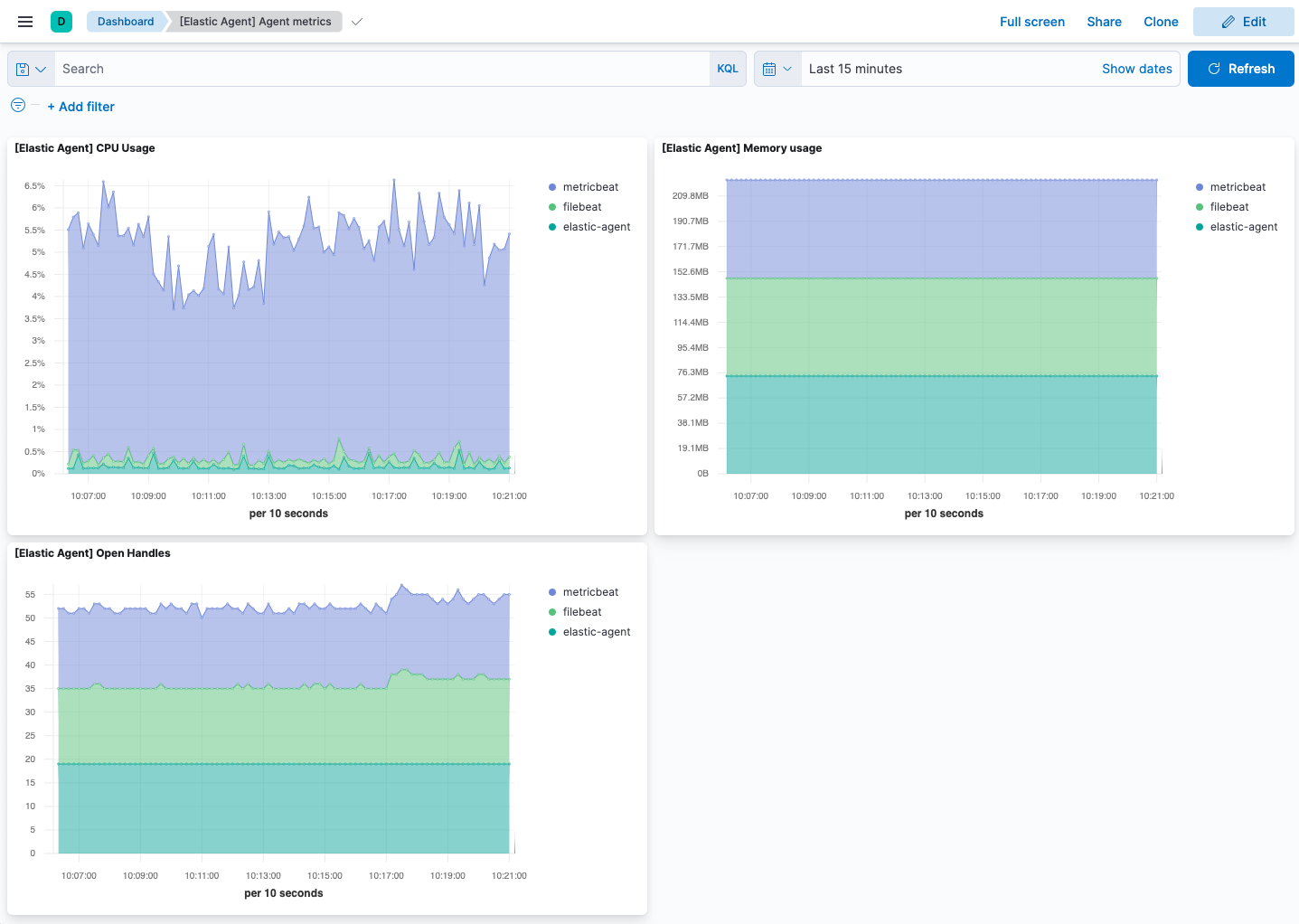

The [Elastic Agent] Agent metrics dashboard shows an aggregated view of agent metrics:
![Screen capture showing Elastic Agent metrics](images/agent-metrics-dashboard.png)
