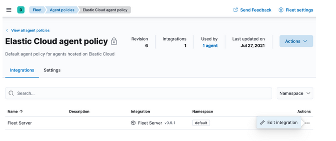

Next modify the Fleet Server configuration by editing the agent policy:
- In Fleet, click Agent Policies. Click on the Elastic Cloud agent policy to edit it.
Open the Actions menu and select Edit integration.

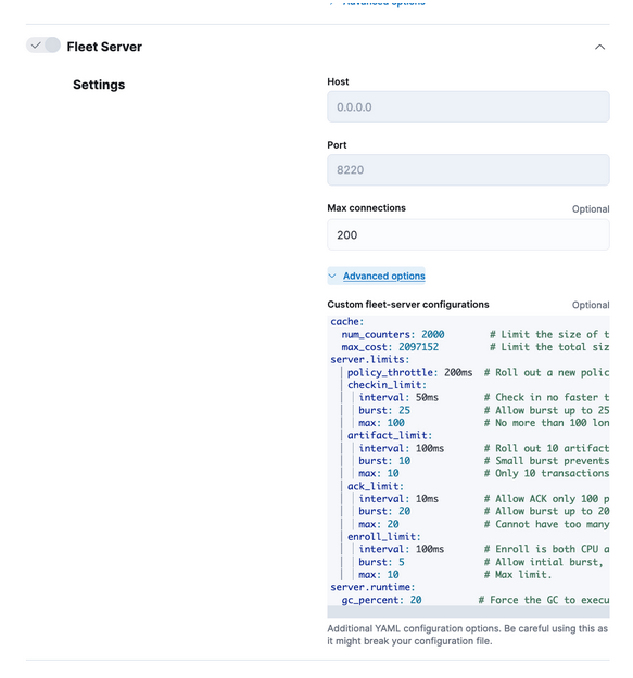

Under Fleet Server, modify Max Connections and other advanced settings as described in Scaling recommendations (Elastic Cloud).
Advanced Fleet Server optionsedit
The following advanced settings are available to fine tune your Fleet Server deployment.
cache
num_counters
- Size of the hash table. Best practice is to have this set to 10x max connections.
max_cost
- Total size of the cache.
server.limits
policy_throttle
- How often a new policy is rolled out to the agents.
checkin_limit.interval
- How fast the agents can check in to the Fleet Server.
checkin_limit.burst
Burst of check-ins allowed before falling back to the rate defined by
interval
checkin_limit.max
- Maximum number of agents.
artifact_limit.max
- Maximum number of agents that can call the artifact API concurrently. It allows the user to avoid overloading the Fleet Server from artifact API calls.
artifact_limit.interval
- How often artifacts are rolled out. Default of 100ms allows 10 artifacts to be rolled out per second.
artifact_limit.burst
- Number of transactions allowed for a burst, controlling oversubscription on outbound buffer.
ack_limit.max
- Maximum number of agents that can call the Ack API concurrently. It allows the user to avoid overloading the Fleet Server from Ack API calls.
ack_limit.interval
- How often an acknowledgment (ACK) is sent. Default value of 10ms enables 100 ACKs per second to be sent.
ack_limit.burst
Burst of ACKs to accommodate (default of 20) before falling back to the rate
defined in
interval
enroll_limit.max
- Maximum number of agents that can call the Enroll API concurrently. This setting allows the user to avoid overloading the Fleet Server from Enrollment API calls.
enroll_limit.interval
- Interval between processing enrollment request. Enrollment is both CPU and RAM intensive, so the number of enrollment requests needs to be limited for overall system health. Default value of 100ms allows 10 enrollments per second.
enroll_limit.burst
Burst of enrollments to accept before falling back to the rate defined by
interval
