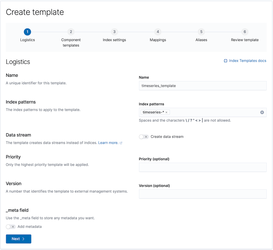

You can use the Kibana Create template wizard to add the template. To access the wizard, open the menu and go to Stack Management > Index Management. In the Index Templates tab, click Create template.
The create template request for the example template looks like this:
PUT _index_template/timeseries_template { "index_patterns": ["timeseries-*"], "template": { "settings": { "number_of_shards": 1, "number_of_replicas": 1, "index.lifecycle.name": "timeseries_policy", "index.lifecycle.rollover_alias": "timeseries" } } }
