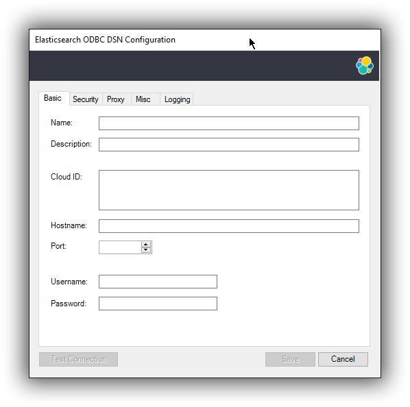

2.1 Launch Elasticsearch SQL ODBC Driver DSN Editoredit
Click on the System DSN tab, then on the Add…​ button:
Add a new DSNadministrator system add
A new window will open, listing all available installed drivers. Click on Elasticsearch Driver, to highlight it, then on the Finish button:
Launch the DSN Editoradministrator launch editor
This action closes the previously opened second window and open a new one instead, Elasticsearch SQL ODBC Driver’s DSN Editor:
Elasticsearch SQL ODBC Driver DSN Editordsn editor basic
This new window has three tabs, each responsible for a set of configuration parameters, as follows.
2.2 Connection parametersedit
This tab allows configuration for the following items:
  • Name
    This is the name the DSN will be referred by.
    The characters available for this field are limited to the set permitted for a Registry key.
    Example: localhost
  • Description
    This field allows a arbitrary text; generally used for short notes about the configured connection.
    Example: Clear-text connection to the local [::1]:9200.
  • Cloud ID
    The Cloud ID is a string that simplifies the configuration when connecting to Elastic’s Cloud Elasticsearch Service; it is obtained from within the Cloud console of each Elasticsearch cluster and encodes the connection parameters to that cluster.
    When this field is provisioned, the Hostname, Port and the security settings are provisioned as well and their respective inputs disabled.
  • Hostname
    This field requires an IP address or a resolvable DNS name of the Elasticsearch instance that the driver will connect to.
    Example: ::1
  • Port
    The port on which the Elasticsearch listens on.
    If left empty, the default 9200 port number will be used.
  • Username, Password
    If security is enabled, these fields will need to contain the credentials of the access user.
At a minimum, the Name and Hostname fields must be provisioned, before the DSN can be saved.

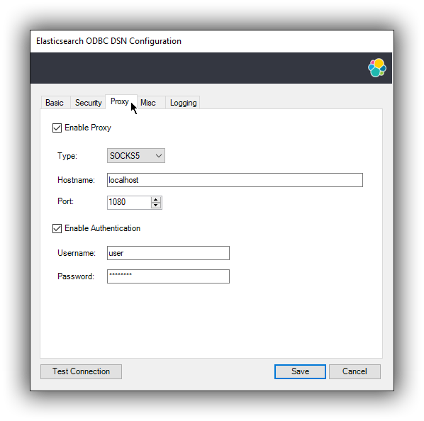

2.4 Proxy parametersedit
If connecting to the Elasticsearch node needs to go through a proxy, the following parameters need to be configured:
  • Type
    What kind of protocol to use when connecting to the proxy host. This also mandates how the Elasticsearch node you want to connect to over the proxy needs to be specified under 2.2 Connection parameters:
    • HTTP, SOCKS4A, SOCKS5H: either IP address or host name is accepted; the proxy will resolve the DNS name;
    • SOCKS4, SOCKS5: Elasticsearch node location needs to be provided as an IP address;
  • Port
    The TCP port the proxy is listening for connections on.
  • Username
    The user part of the credentials used to authenticate to the proxy.
  • Password
    The password part of the credentials for the proxy.
Proxy parametersdsn editor proxy

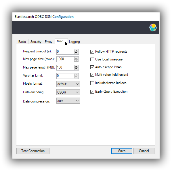

2.5 Connection parametersedit
The connection configuration can further be tweaked by the following parameters.
  • Request timeout (s)
    The maximum time (in seconds) a request to the server can take. This can be overridden by a larger statement-level timeout setting. The value 0 means no timeout.
  • Max page size (rows)
    The maximum number of rows that Elasticsearch SQL server should send the driver for one page. This corresponds to the SQL search API’s fetch_size parameter. A 0 value indicates a server default.
  • Max page length (MB)
    The maximum size (in megabytes) that an answer can grow to, before being rejected as too large by the driver. This is concerning the HTTP answer body of one page, not the cumulated data volume that a query might generate.
  • Varchar limit
    The maximum width of the string columns. If this setting is greater than zero, the driver will advertise all the string type columns as having a maximum character length equal to this value and will truncate any longer string to it. The string types are textual fields (TEXT, KEYWORD etc.) and some specialized fields (IP, the GEOs etc.). Note that no interpretation of the value is performed before truncation, which can lead to invalid values if the limit is set too low. This is required for those applications that do not support column lengths as large as Elasticsearch fields can be.
  • Floats format
    Controls how the floating point numbers will be printed, when these are converted to string by the driver. Possible values given to this parameter:
    • scientific: the exponential notation (ex.: 1.23E01);
    • default: the default notation (ex.: 12.3);
    • auto: the driver will choose one of the above depending on the value to be printed. Note that the number of decimals is dependent on the precision (or ODBC scale) of the value being printed and varies with the different floating point types supported by Elasticsearch SQL. This setting is not effective when the application fetches from the driver the values as numbers and then does the conversion subsequently itself.
  • Data encoding
    This value controls which data format to encode the REST content in. Possible values are:
    • CBOR: use the Concise Binary Object Representation format. This is the preferred encoding, given its more compact format.
    • JSON: use the JavaScript Object Notation format. This format is more verbose, but easier to read, especially useful if troubleshooting.
  • Data compression
    This setting controls if and when the REST content - encoded in one of the above formats - is going to be compressed. The possible values are:
    • on: enables the compression;
    • off: disables the compression;
    • auto: enables the compression, except for the case when the data flows through a secure connection; since in this case the encryption layer employs its own data compression and there can be security implications when an additional compression is enabled, the setting should be kept to this value.
  • Follow HTTP redirects
    Should the driver follow HTTP redirects of the requests to the server?
  • Use local timezone
    This setting controls the timezone of:
    • the context in which the query will execute (especially relevant for functions dealing with timestamp components);
    • the timestamps received from / sent to the server.
      If disabled, the UTC timezone will apply; otherwise, the local machine’s set timezone.
  • Auto-escape PVAs
    The pattern-value arguments make use of _ and % as special characters to build pattern matching values. Some applications however use these chars as regular ones, which can lead to Elasticsearch SQL returning more data than the app intended. With the auto escaping, the driver will inspect the arguments and will escape these special characters if not already done by the application.
  • Multi value field lenient
    This setting controls the behavior of the server in case a multi-value field is queried. In case this is set and the server encounters such a field, it will pick a value in the set - without any guarantees of what that will be, but typically the first in natural ascending order - and return it as the value for the column. If not set, the server will return an error. This corresponds to the SQL search API’s field_multi_value_leniency parameter.
  • Include frozen indices
    If this parameter is true, the server will include the frozen indices in the query execution. This corresponds to Elasticsearch SQL’s request parameter index_include_frozen
  • Early query execution
    If this configuration is set, the driver will execute a statement as soon as the application submits it for preparation - i.e. early - and is functionally equivalent to a direct execution. This will only happen if the query lacks parameters. Early execution is useful with those applications that inspect the result before actually executing the query. Elasticsearch SQL lacks a preparation API, so early execution is required for interoperability with these applications.
Connection parametersdsn editor misc

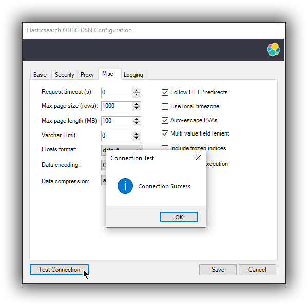

2.7 Testing the connectionedit
Once the Hostname, the Port (if different from implicit default) and the SSL options are configured, you can test if the provided parameters are correct by pressing the Test Connection button. This will instruct the driver to connect to the Elasticsearch instance and perform a simple SQL test query. (This will thus require a running Elasticsearch instance with the SQL plugin enabled.)
Connection testingdsn editor conntest
When connection testing, all the configured parameters are taken into account, including the logging configuration. This will allow early detection of potential file/directory access rights conflicts.
See Alternative logging configuration section further for an alternative way of configuring the logging.
