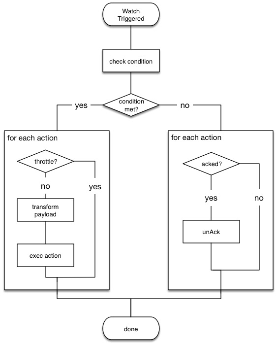

When the Watcher service is stopped, the scheduler stops with it. Trigger engines use a separate thread pool from the one used to execute watches.
When a watch is triggered, Watcher queues it up for execution. A watch_record
document is created and added to the watch history and the watch’s status is set
to awaits_execution
When execution starts, Watcher creates a watch execution context for the watch. The execution context provides scripts and templates with access to the watch metadata, payload, watch ID, execution time, and trigger information. For more information, see Watch Execution Context.
During the execution process, Watcher:
- Loads the input data as the payload in the watch execution context. This makes the data available to all subsequent steps in the execution process. This step is controlled by the input of the watch.
Evaluates the watch condition to determine whether or not to continue processing
the watch. If the condition is met (evaluates to
true
), processing advances to the next step. If it is not met (evaluates tofalse
), execution of the watch stops. - Applies transforms to the watch payload (if needed).
- Executes the watch actions granted the condition is met and the watch is not throttled.
When the watch execution finishes, the execution result is recorded as a Watch Record in the watch history. The watch record includes the execution time and duration, whether the watch condition was met, and the status of each action that was executed.
The following diagram shows the watch execution process:
Watch acknowledgment and throttling
editWatcher supports both time-based and acknowledgment-based throttling. This enables you to prevent actions from being repeatedly executed for the same event.
By default, Watcher uses time-based throttling with a throttle period of 5 seconds. This means that if a watch is executed every second, its actions are performed a maximum of once every 5 seconds, even when the condition is always met. You can configure the throttle period on a per-action basis or at the watch level.
Acknowledgment-based throttling enables you to tell Watcher not to send any more
notifications about a watch as long as its condition is met. Once the condition
evaluates to false
, the acknowledgment is cleared and Watcher resumes executing
the watch actions normally.
For more information, see Acknowledgement and throttling.
