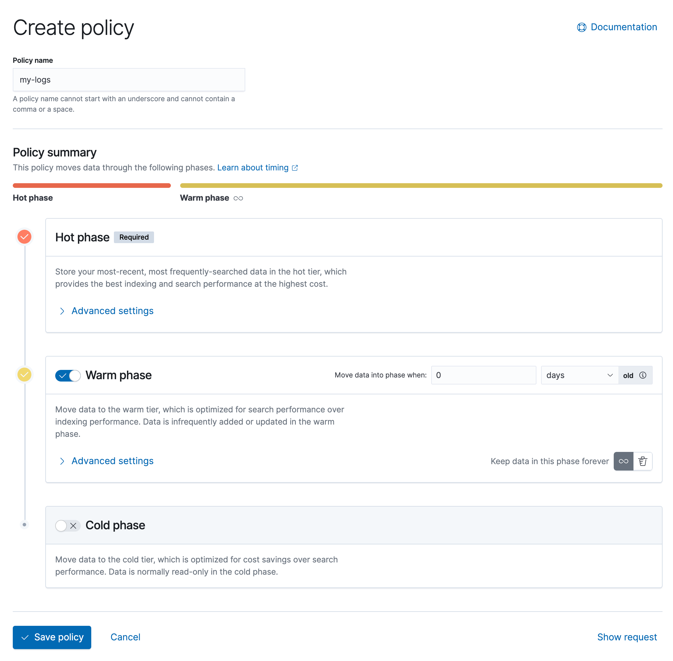

Create a lifecycle policy
editA lifecycle policy specifies the phases in the index lifecycle
and the actions to perform in each phase. A lifecycle can have up to five phases:
hot
, warm
, cold
, frozen
, and delete
For example, you might define a timeseries_policy
that has two phases:
A
hot
phase that defines a rollover action to specify that an index rolls over when it reaches either amax_primary_shard_size
of 50 gigabytes or amax_age
of 30 days. -
A
delete
phase that setsmin_age
to remove the index 90 days after rollover.
The min_age
value is relative to the rollover time, not the index creation time. Learn more.
You can create the policy through Kibana or with the create or update policy API. To create the policy from Kibana, open the menu and go to Stack Management > Index Lifecycle Policies. Click Create policy.

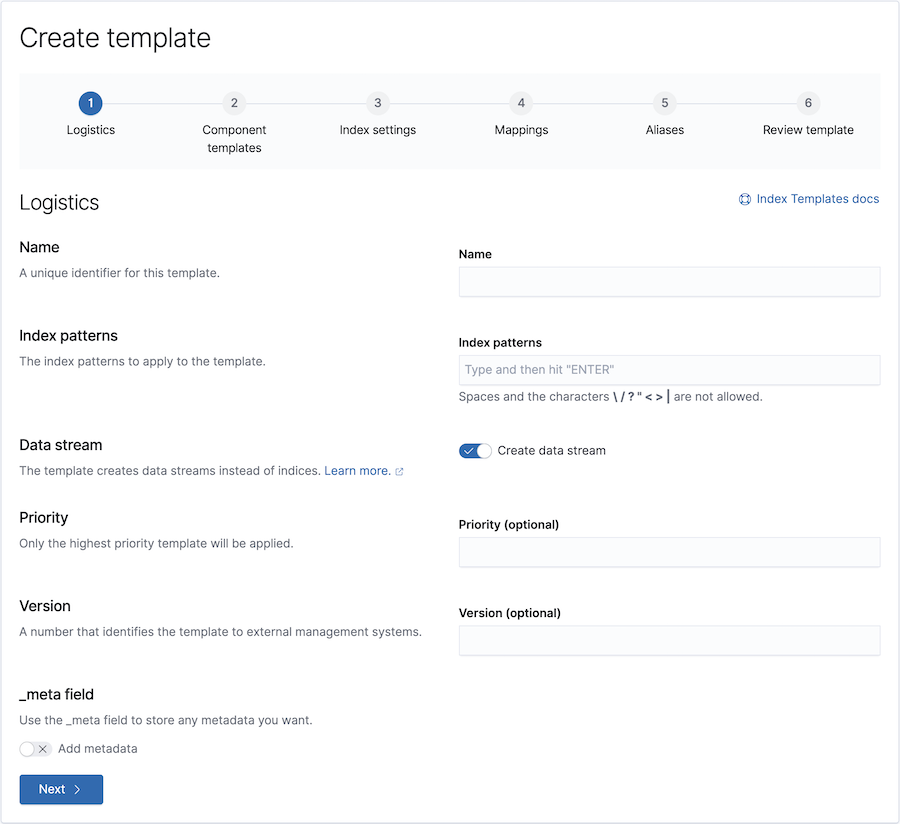

Create an index template to create the data stream and apply the lifecycle policy
editTo set up a data stream, first create an index template to specify the lifecycle policy. Because
the template is for a data stream, it must also include a data_stream
definition.
For example, you might create a timeseries_template
to use for a future data stream
named timeseries
To enable the ILM to manage the data stream, the template configures one ILM setting:
index.lifecycle.name
specifies the name of the lifecycle policy to apply to the data stream.
You can use the Kibana Create template wizard to add the template. From Kibana, open the menu and go to Stack Management > Index Management. In the Index Templates tab, click Create template.
This wizard invokes the create or update index template API to create the index template with the options you specify.

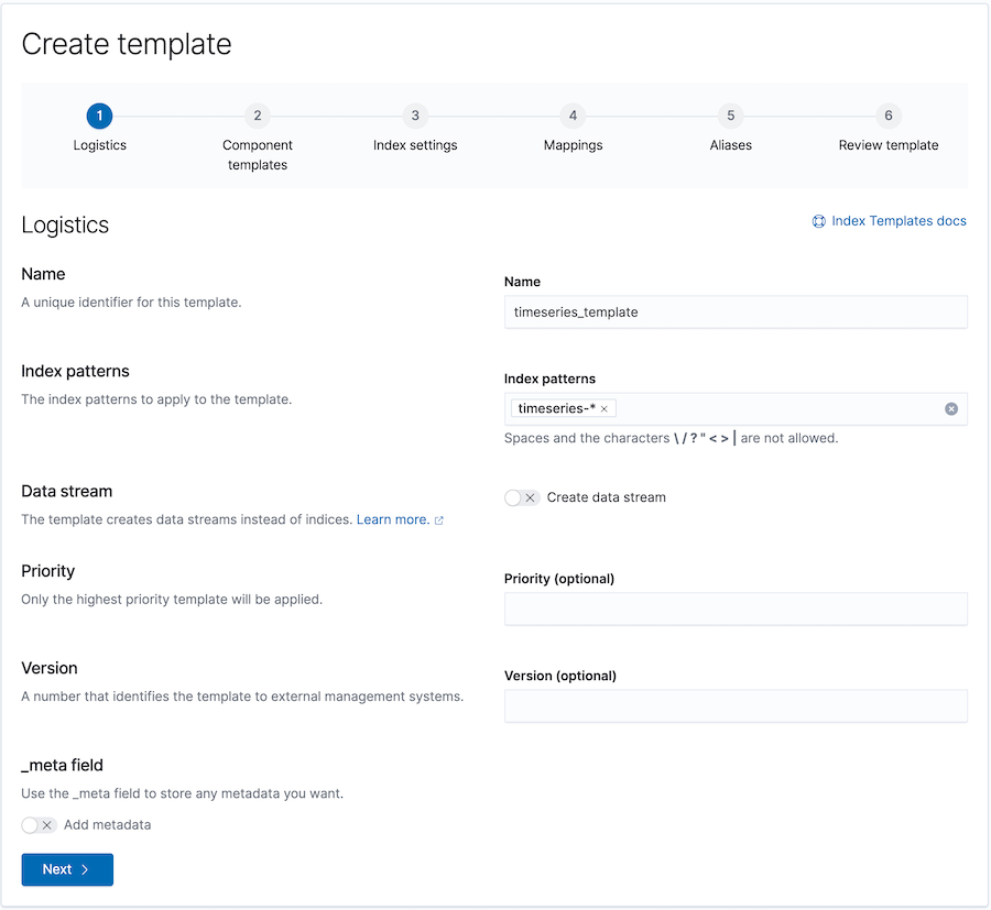

You can use the Kibana Create template wizard to add the template. To access the wizard, open the menu and go to Stack Management > Index Management. In the Index Templates tab, click Create template.
The create template request for the example template looks like this:
