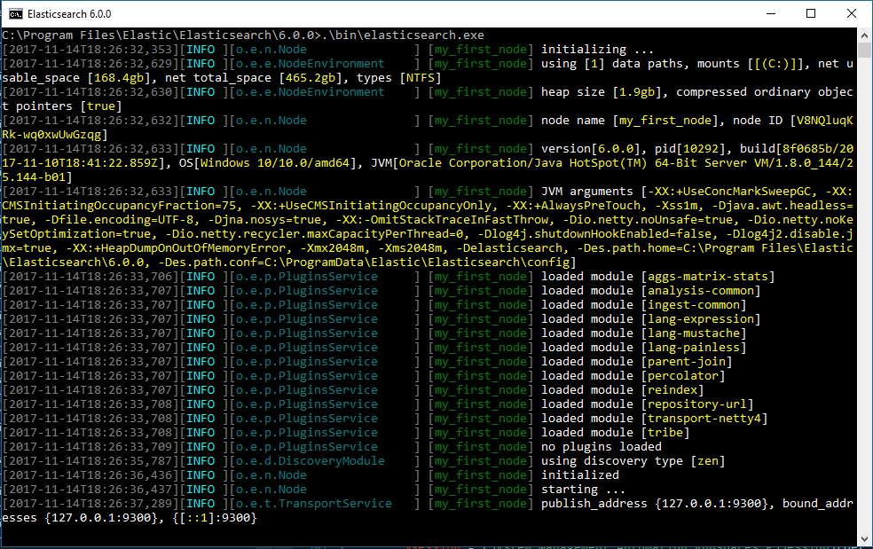

If you installed Elasticsearch on Windows using the .msi package, you can start Elasticsearch from the command line. If you want it to start automatically at boot time without any user interaction, install Elasticsearch as a Windows service.
Running Elasticsearch from the command lineedit
Once installed, Elasticsearch can be started from the command line, if not installed as a service and configured to start when installation completes, as follows:
.\bin\elasticsearch.exe
The command line terminal will display output similar to the following:
elasticsearch exe
By default Elasticsearch prints its logs to STDOUT and to the <cluster name>.log file within LOGSDIRECTORY. Elasticsearch logs some information while it is starting up, but once it has finished initializing it will continue to run in the foreground and won’t log anything further until something happens that is worth recording. While Elasticsearch is running you can interact with it through its HTTP interface which is on port 9200 by default. To stop Elasticsearch, press Ctrl-C.
