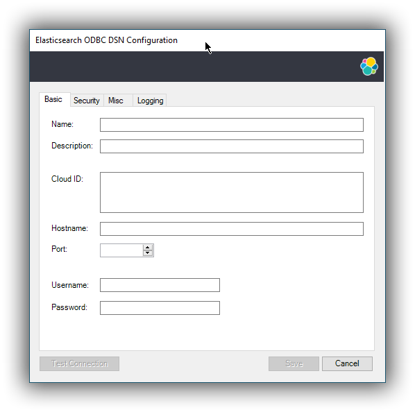

Elasticsearch SQL ODBC Driver DSN Editordsn editor basic
This new window has three tabs, each responsible for a set of configuration parameters, as follows.
2.2 Connection parametersedit
This tab allows configuration for the following items:
  • Name
    This is the name the DSN will be referred by.
    The characters available for this field are limited to the set permitted for a Registry key.
    Example: localhost
  • Description
    This field allows a arbitrary text; generally used for short notes about the configured connection.
    Example: Clear-text connection to the local [::1]:9200.
  • Cloud ID
    The Cloud ID is a string that simplifies the configuration when connecting to Elastic’s Cloud Elasticsearch Service; it is obtained from within the Cloud console of each Elasticsearch cluster and encodes the connection parameters to that cluster.
    When this field is provisioned, the Hostname, Port and the security settings are provisioned as well and their respective inputs disabled.
  • Hostname
    This field requires an IP address or a resolvable DNS name of the Elasticsearch instance that the driver will connect to.
    Example: ::1
  • Port
    The port on which the Elasticsearch listens on.
    If left empty, the default 9200 port number will be used.
  • Username, Password
    If security is enabled, these fields will need to contain the credentials of the user configured to access the REST SQL endpoint.
At a minimum, the Name and Hostname fields must be provisioned, before the DSN can be saved.

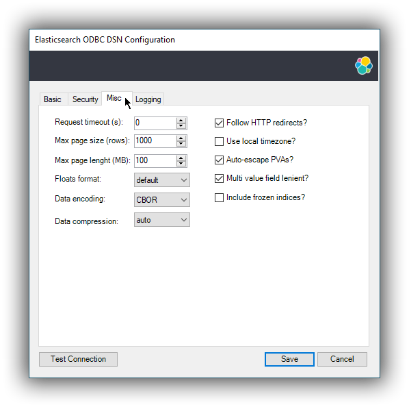

2.4 Connection parametersedit
The connection configuration can further be tweaked by the following parameters.
  • Request timeout (s)
    The maximum number of seconds for a request to the server. The value 0 disables the timeout. This corresponds to the Timeout setting in Connection string parameters.
  • Max page size (rows)
    The maximum number of rows that Elasticsearch SQL server should send the driver for one page. This corresponds to the MaxFetchSize setting in Connection string parameters.
  • Max page length (MB)
    The maximum number of megabytes that the driver will accept for one page. This corresponds to the MaxBodySizeMB setting in Connection string parameters.
  • Floats format
    How should the floating point numbers be printed, when these are converted to string by the driver. This corresponds to the ScientificFloats setting in Connection string parameters.
  • Data encoding
    How should the data between the server and the driver be encoded as. This corresponds to the Packing setting in Connection string parameters.
  • Data compression
    Should the data between the server and the driver be compressed? This corresponds to the Compression setting in Connection string parameters.
  • Follow HTTP redirects?
    Should the driver follow HTTP redirects of the requests to the server? This corresponds to the Follow setting in Connection string parameters.
  • Use local timezone?
    Should the driver use machine’s local timezone? The default is UTC. This corresponds to the ApplyTZ setting in Connection string parameters.
  • Auto-escape PVAs?
    Should the driver auto-escape the pattern-value arguments? This corresponds to the AutoEscapePVA setting in Connection string parameters.
  • Multi value field lenient?
    Should the server return one value out of a multi-value field (instead of rejecting the request)? This corresponds to the MultiFieldLenient setting in Connection string parameters.
  • Include frozen indices?
    Should the server consider the frozen indices when servicing a request? This corresponds to the IndexIncludeFrozen setting in Connection string parameters.
Connection parametersdsn editor misc

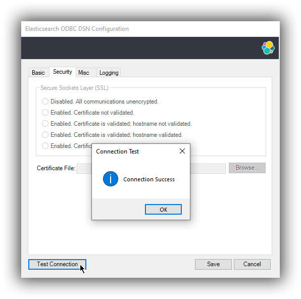

2.5 Testing the connectionedit
Once the Hostname, the Port (if different from implicit default) and the SSL options are configured, you can test if the provided parameters are correct by pressing the Test Connection button. This will instruct the driver to connect to the Elasticsearch instance and perform a simple SQL test query. (This will thus require a running Elasticsearch instance with the SQL plugin enabled.)
Connection testingdsn editor conntest
When connection testing, all the configured parameters are taken into account, including the logging configuration. This will allow early detection of potential file/directory access rights conflicts.
See Alternative logging configuration section further for an alternative way of configuring the logging.

MultiFieldLenient (default: true)
This boolean parameter controls the behavior of the server in case a multi-value field is queried. In case this is set and the server encounters such a field, it will pick a value in the set - without any guarantees of what that will be, but typically the first in natural ascending order - and return it as the value for the column. If not set, the server will return an error. This corresponds to Elasticsearch SQL’s request parameter field_multi_value_leniency (see Supported REST parameters).
AutoEscapePVA (default: true)
The pattern-value arguments make use of _ and % as special characters to build patern matching values. Some applications however use these chars as regular ones, which can lead to Elasticsearch SQL returning more data than the app intended. With the auto escaping, the driver will inspect the arguments and will escape these special characters if not already done by the application.
IndexIncludeFrozen (default: false)
If this parameter is true, the server will include the frozen indices in the query execution. This corresponds to Elasticsearch SQL’s request parameter index_include_frozen (see Supported REST parameters).
