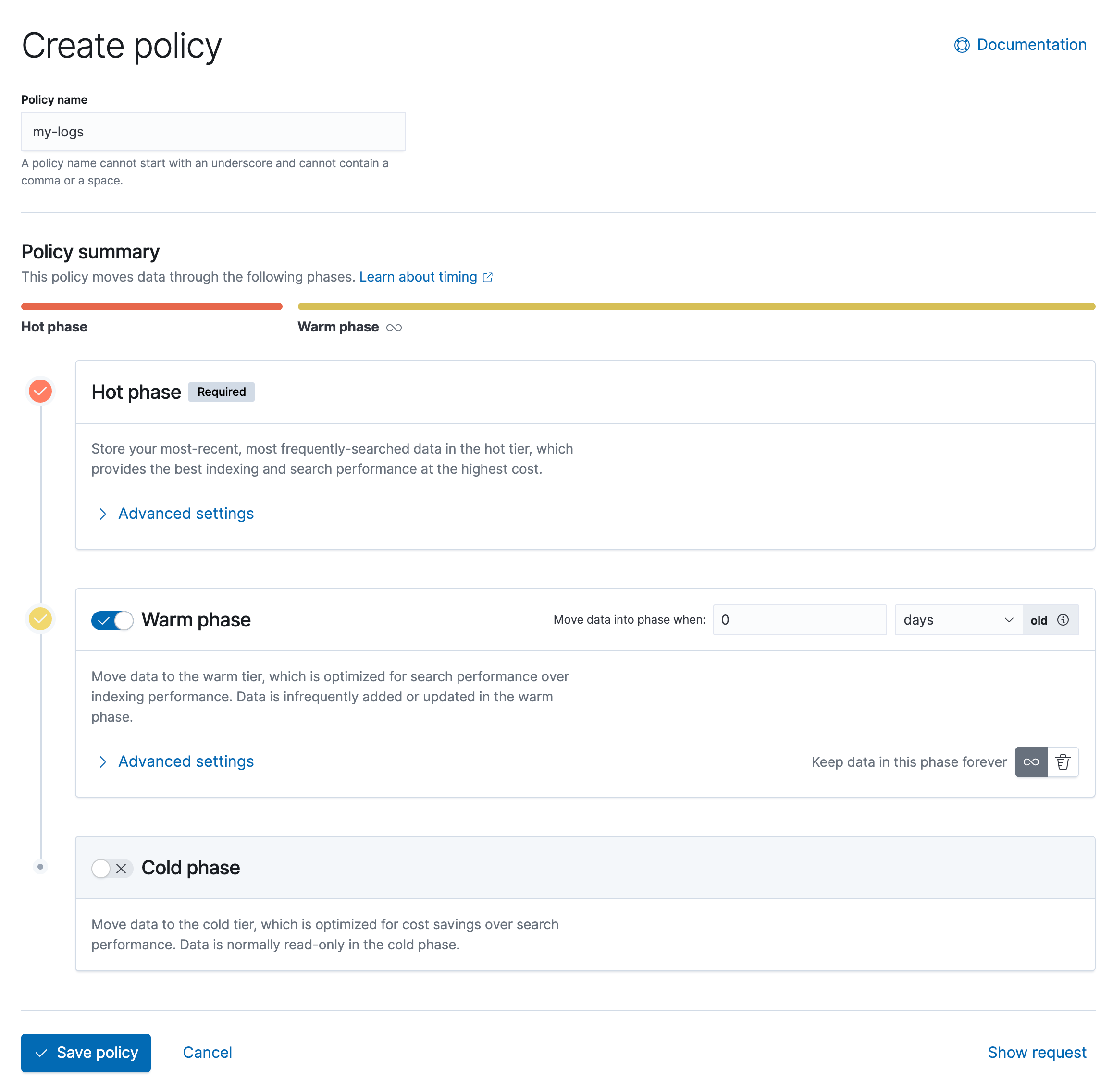

Create a lifecycle policyedit
A lifecycle policy specifies the phases in the index lifecycle and the actions to perform in each phase. A lifecycle can have up to four phases: hot, warm, cold, and delete.
For example, you might define a timeseries_policy that has two phases:
  • A hot phase that defines a rollover action to specify that an index rolls over when it reaches either a max_size of 50 gigabytes or a max_age of 30 days.
  • A delete phase that sets min_age to remove the index 90 days after rollover. Note that this value is relative to the rollover time, not the index creation time.
You can create the policy through Kibana Management or with the put policy API. To create the policy from Kibana, go to Management and click Index Lifecycle Policies.
create policy

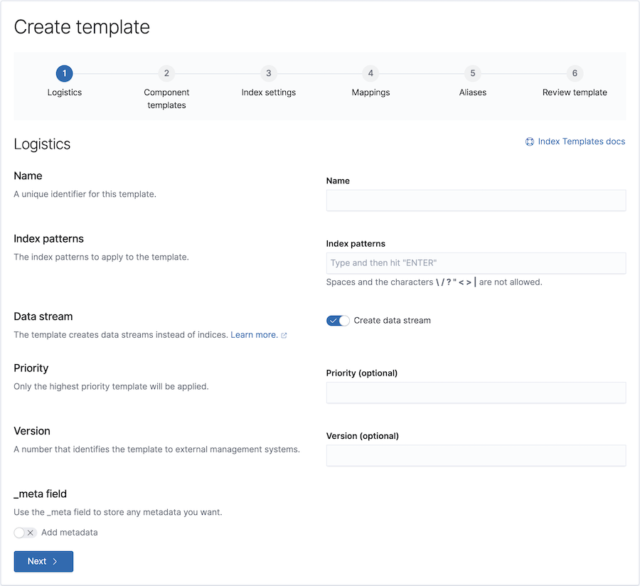

Create an index template to create the data stream and apply the lifecycle policyedit
To set up a data stream, first create an index template to specify the lifecycle policy. Because the template is for a data stream, it must also include a data_stream definition.
For example, you might create a timeseries_template to use for a future data stream named timeseries.
To enable the ILM to manage the data stream, the template configures one ILM setting:
  • index.lifecycle.name specifies the name of the lifecycle policy to apply to the data stream.
You can use the Kibana Create template wizard to add the template. This wizard invokes the put _index_template API to create the index template with the options you specify.
