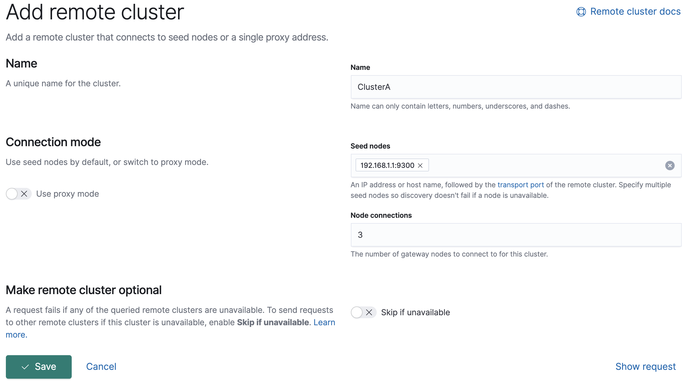

To configure a remote cluster from Stack Management in Kibana:
  1. Select Remote Clusters from the side navigation.
  2. Specify the IP address or host name of the remote cluster (ClusterB), followed by the transport port of the remote cluster (defaults to 9300). For example, 192.168.1.1:9300.
The Add remote clusters page in Kibana

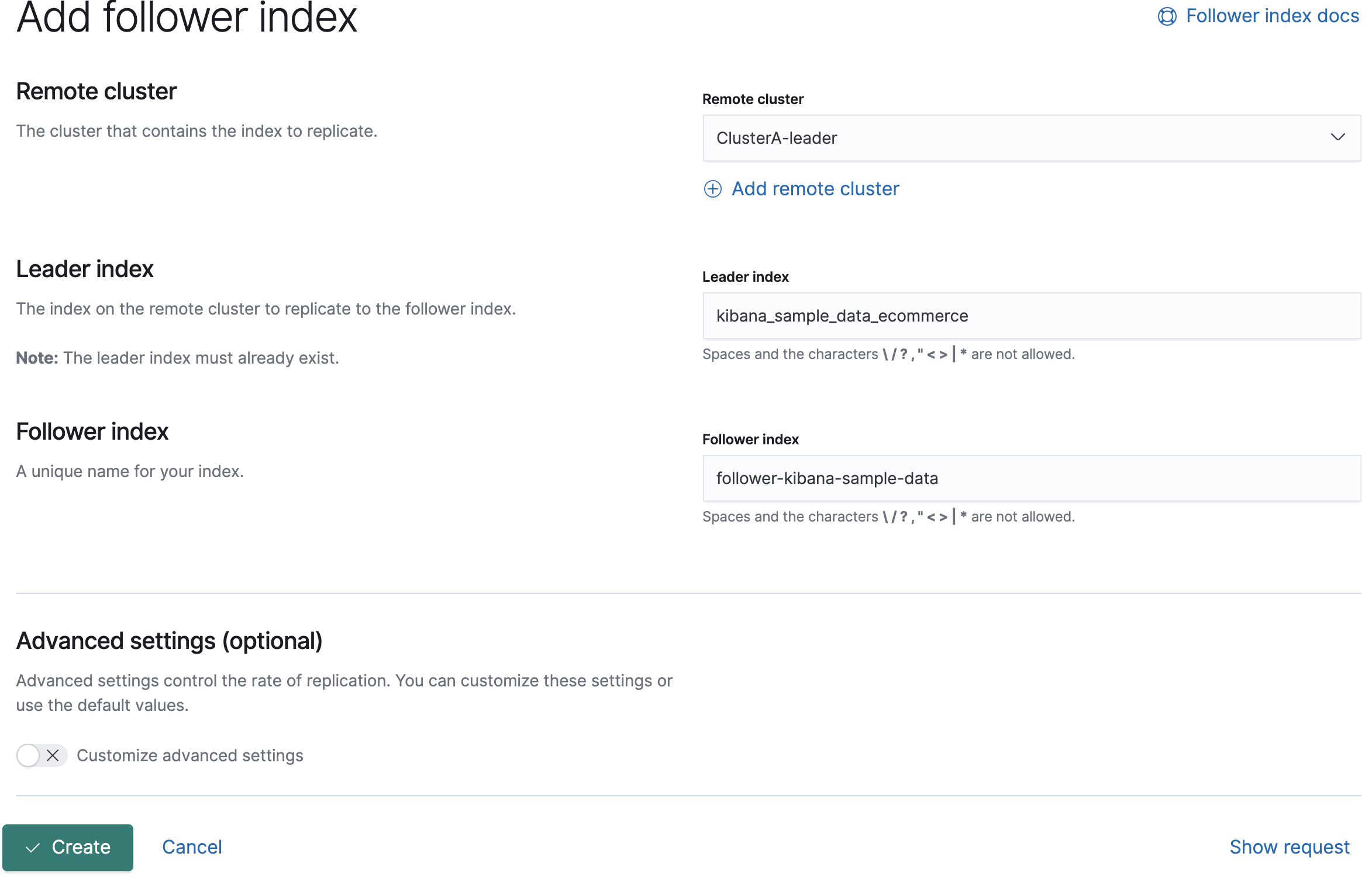

To create a follower index from Stack Management in Kibana:
  1. Select Cross-Cluster Replication in the side navigation and choose the Follower Indices tab.
  2. Choose the cluster (ClusterA) containing the leader index you want to replicate.
  3. Enter the name of the leader index, which is kibana_sample_data_ecommerce if you are following the tutorial.
  4. Enter a name for your follower index, such as follower-kibana-sample-data.
Adding a follower index named server-metrics in Kibana

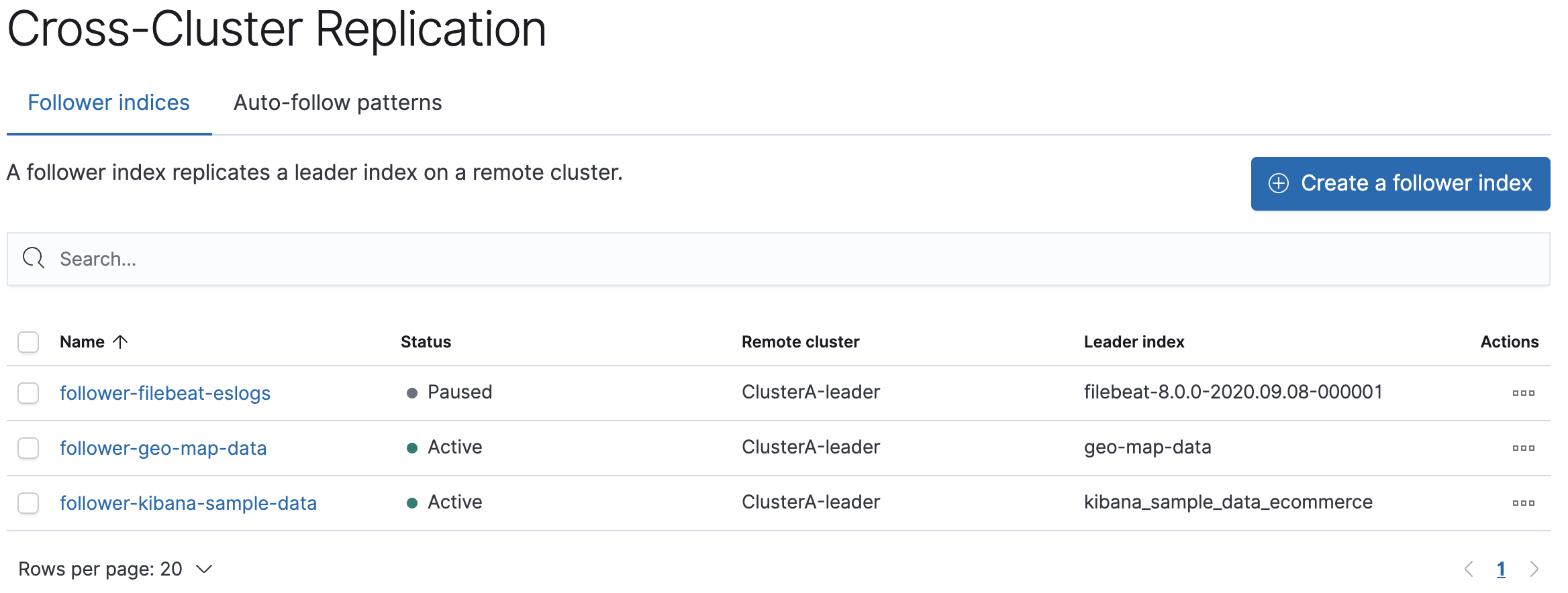

Elasticsearch initializes the follower using the remote recovery process, which transfers the existing Lucene segment files from the leader index to the follower index. The index status changes to Paused. When the remote recovery process is complete, the index following begins and the status changes to Active.
When you index documents into your leader index, Elasticsearch replicates the documents in the follower index.
The Cross-Cluster Replication page in Kibana

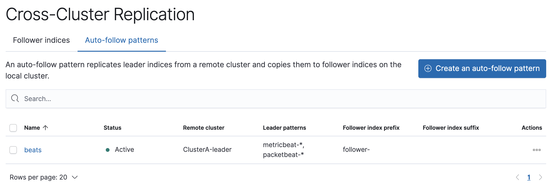

Create an auto-follow pattern to replicate time series indicesedit
You use auto-follow patterns to automatically create new followers for rolling time series indices. Whenever the name of a new index on the remote cluster matches the auto-follow pattern, a corresponding follower index is added to the local cluster.
An auto-follow pattern specifies the remote cluster you want to replicate from, and one or more index patterns that specify the rolling time series indices you want to replicate.
To create an auto-follow pattern from Stack Management in Kibana:
  1. Select Cross Cluster Replication in the side navigation and choose the Auto-follow patterns tab.
  2. Enter a name for the auto-follow pattern, such as beats.
  3. Choose the remote cluster that contains the index you want to replicate, which in the example scenario is Cluster A.
  4. Enter one or more index patterns that identify the indices you want to replicate from the remote cluster. For example, enter metricbeat-* packetbeat-* to automatically create followers for Metricbeat and Packetbeat indices.
  5. Enter follower- as the prefix to apply to the names of the follower indices so you can more easily identify replicated indices.
As new indices matching these patterns are created on the remote, Elasticsearch automatically replicates them to local follower indices.
The Auto-follow patterns page in Kibana
