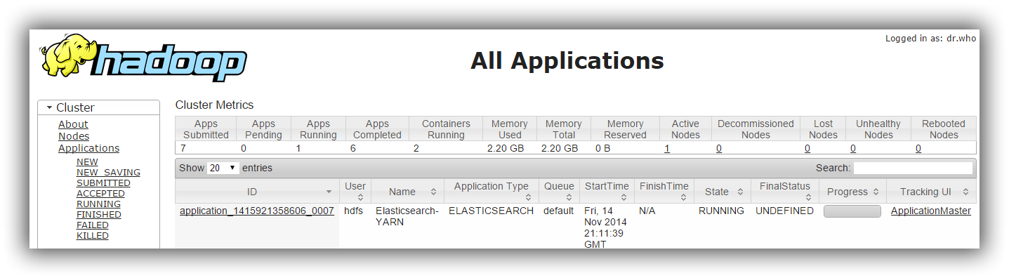

If you prefer the web ui, point your browser to the cluster console (typically on port 8088 - http://hadoop:8088/cluster) and the newly created Elasticsearch cluster, or rather its ApplicationMaster will show up:
AppManager List

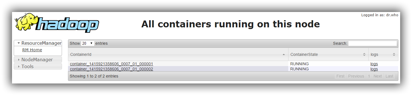

One can inspect the containers manually by checking the container list (typically by accessing the ApplicationManager UI):
Container List
You should be able to see the application and the associated containers marked as RUNNING ; if that is not the case, check out the logs to see what is wrong.
