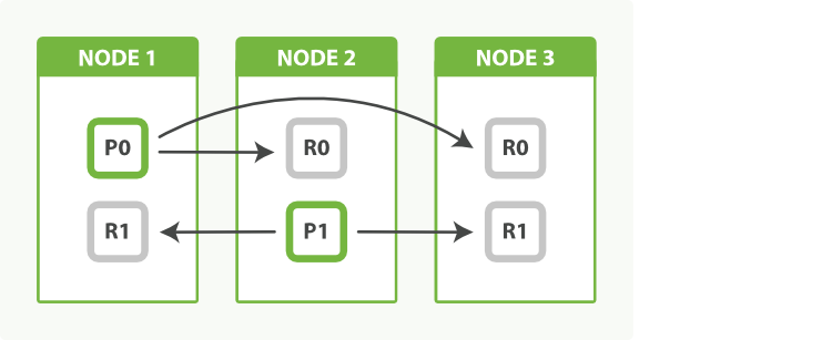

Search performance depends on the response times of the slowest node, so it is a good idea to try to balance out the load across all nodes. If we added just one extra node instead of two, we would end up with two nodes having one shard each, and one node doing double the work with two shards.
We can even things out by adjusting the number of replicas. By allocating two replicas instead of one, we end up with a total of six shards, which can be evenly divided between three nodes, as shown in Figure 52, “Adjust the number of replicas to balance the load between nodes”:
PUT /my_index/_settings
  "number_of_replicas": 2
As a bonus, we have also increased our availability. We can now afford to lose two nodes and still have a copy of all our data.
Figure 52. Adjust the number of replicas to balance the load between nodes
The fact that node 3 holds two replicas and no primaries is not important. Replicas and primaries do the same amount of work; they just play slightly different roles. There is no need to ensure that primaries are distributed evenly across all nodes.
