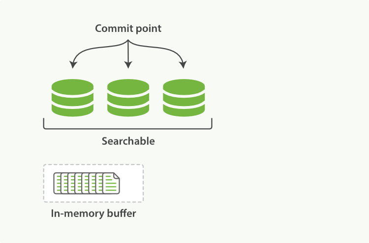

Sitting between Elasticsearch and the disk is the filesystem cache. As before, documents in the in-memory indexing buffer (Figure 19, “A Lucene index with new documents in the in-memory buffer”) are written to a new segment (Figure 20, “The buffer contents have been written to a segment, which is searchable, but is not yet commited”). But the new segment is written to the filesystem cache first—​which is cheap—​and only later is it flushed to disk—​which is expensive. But once a file is in the cache, it can be opened and read, just like any other file.
Figure 19. A Lucene index with new documents in the in-memory buffer
Lucene allows new segments to be written and opened—​making the documents they contain visible to search—​without performing a full commit. This is a much lighter process than a commit, and can be done frequently without ruining performance.
Figure 20. The buffer contents have been written to a segment, which is searchable, but is not yet commited
