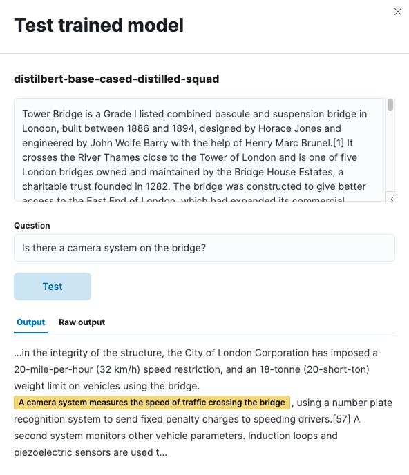

Question answering NLP taskedit
We introduce a new question answering NLP task in 8.3. This task extracts the relevant section that answers a specific question from a larger context. This is especially suited to search requests against large documents. You can see an example of extracting an answer from a larger wiki article about Tower Bridge below.
A screenshot of a question answering NLP task in Kibana
