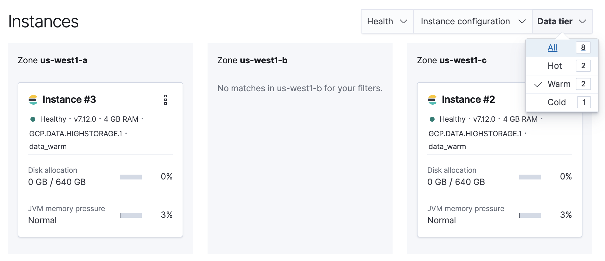

Determine which nodes will be removed from the cluster.
- Log in to the Elasticsearch Service Console.
From the Deployments page, select your deployment.
On the deployments page you can narrow your deployments by name, ID, or choose from several other filters. To customize your view, use a combination of filters, or change the format from a grid to a list.
Filter the list of instances by the Data tier you want to disable.
Note the listed instance IDs. In this example, it would be Instance 2 and Instance 3.

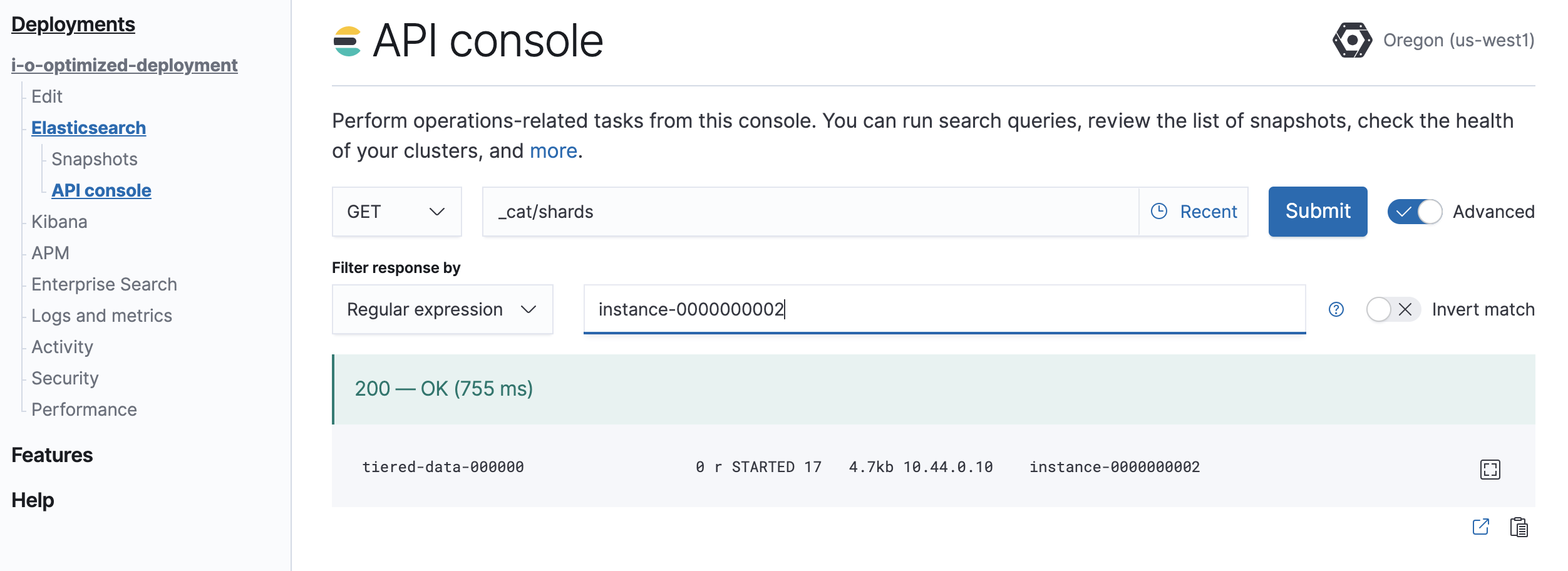

Determine which shards need to be moved.
GET /_cat/shards
Parse the output, looking for shards allocated to the nodes to be removed from the cluster. Note that
Instance #2
is shown asinstance-0000000002
in the output. -

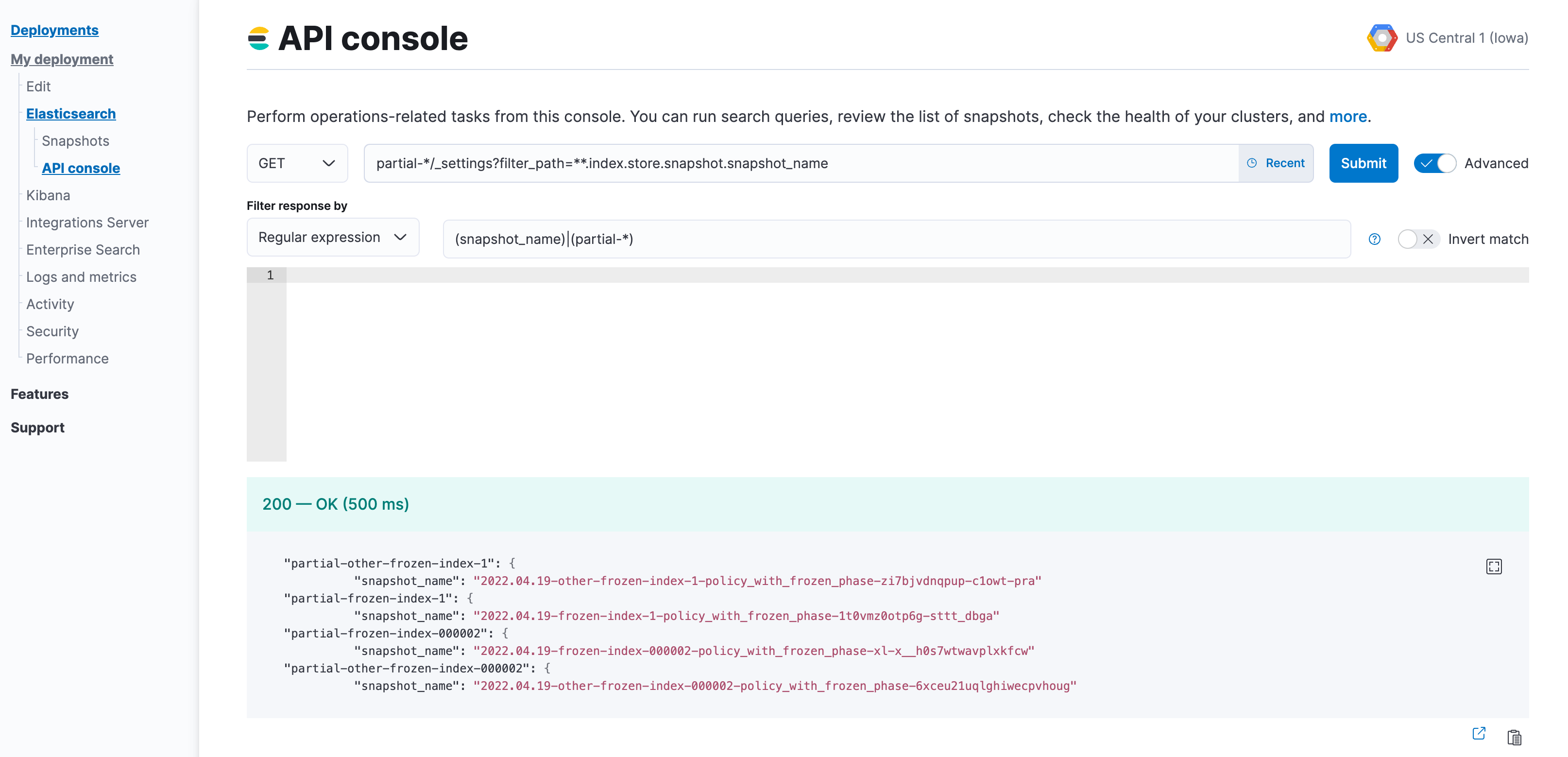

Capture a comprehensive list of index and searchable snapshot names.
The index name of the searchable snapshots may differ based on the data tier. If you intend to disable the cold tier, then perform the following request with the
restored-*
prefix. If the frozen tier is the one to be disabled, use thepartial-*
prefix.GET <searchable-snapshot-index-prefix>/_settings?filter_path=**.index.store.snapshot.snapshot_name&expand_wildcards=all
In the example we have a list of 4 indices, which need to be moved away from the frozen tier.

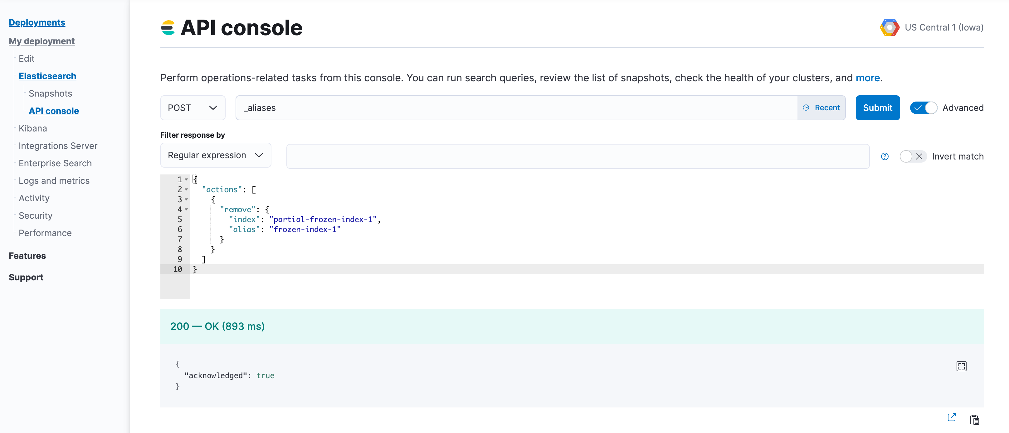

Remove the aliases that were applied to searchable snapshots indices. Use the index prefix from step 2.
POST _aliases { "actions": [ { "remove": { "index": "<searchable-snapshot-index-prefix>-<index_name>", "alias": "<index_name>" } } ] }
If you use data stream, you can skip this step.
In the example we are removing the alias for the
frozen-index-1
index. -

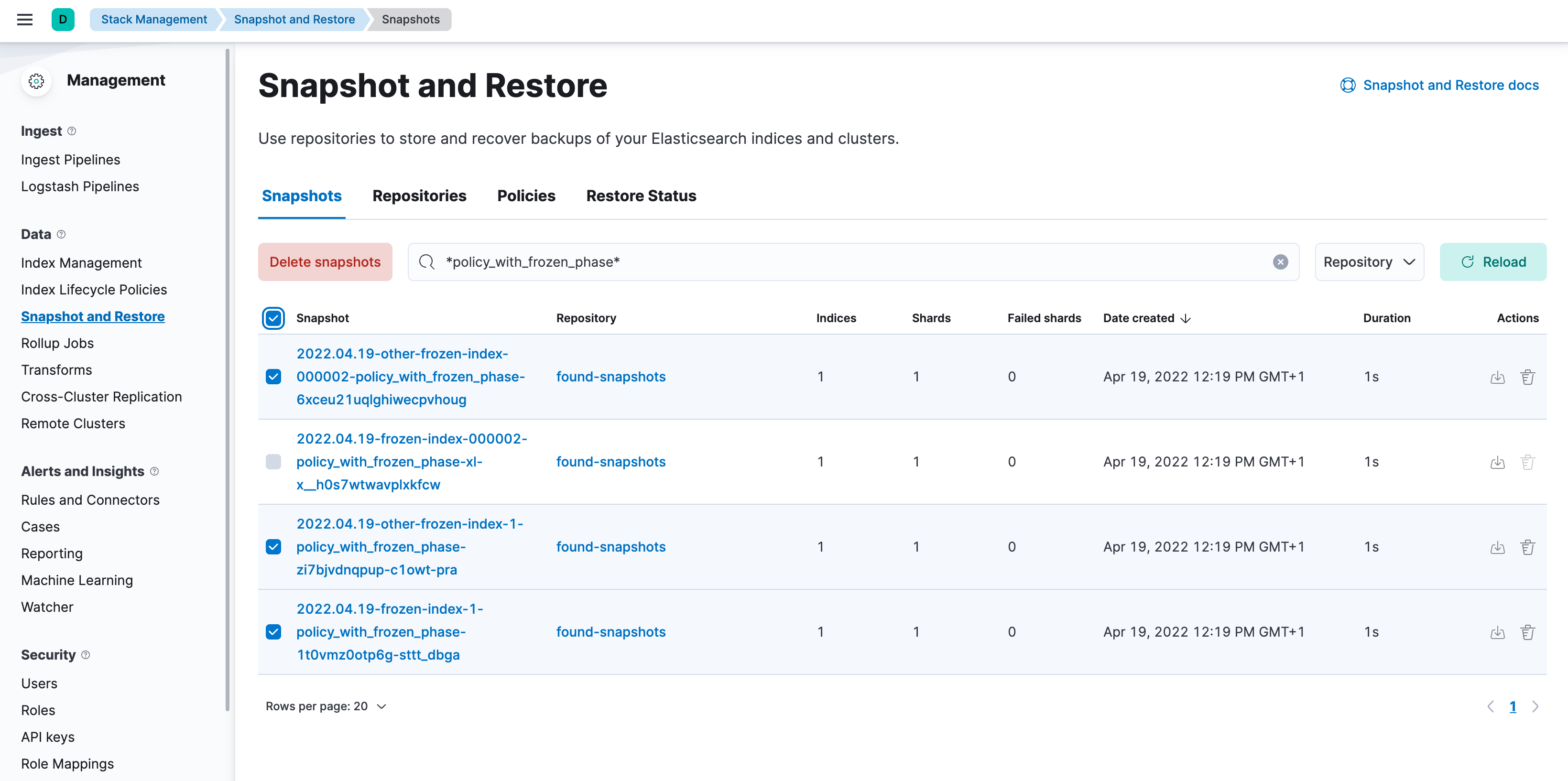

Delete the searchable snapshots by following these steps:
Open Kibana and navigate to Management > Data > Snapshot and Restore > Snapshots (or go to
<kibana-endpoint>/app/management/data/snapshot_restore/snapshots
Search for
*<ilm-policy-name>*
Bulk select the snapshots and delete them
In the example we are deleting the snapshots associated with the
policy_with_frozen_phase
