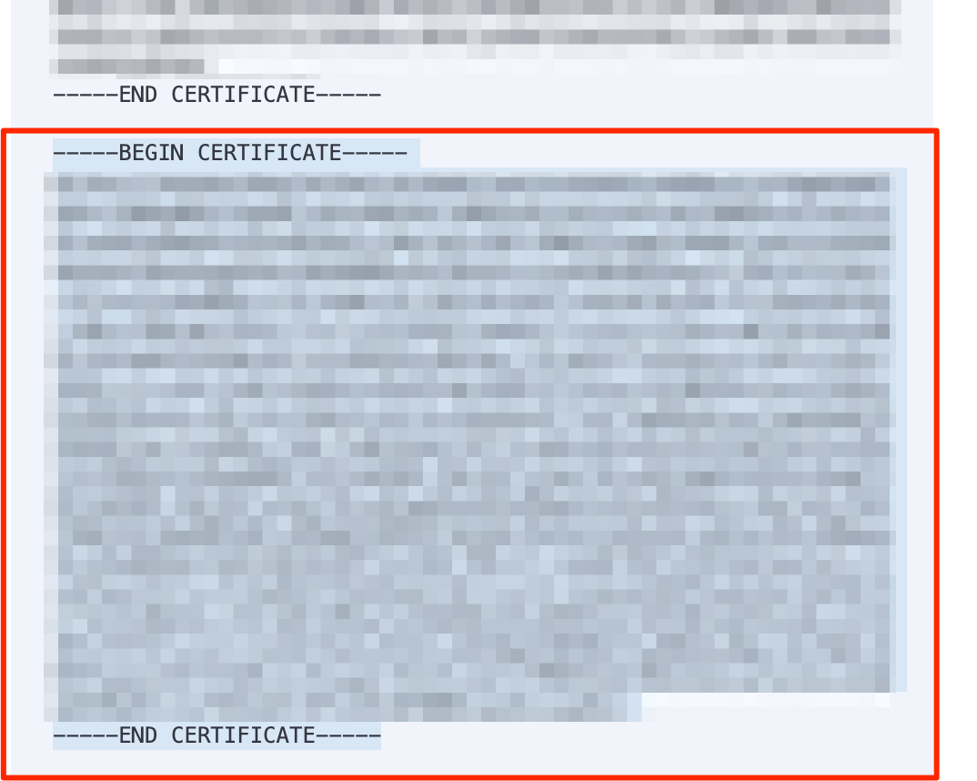

Before configuring the local deployment, retrieve the CA certificate of the remote ECE proxy. To find this certificate:
In the remote ECE environment, go to Platform > Settings > TLS certificates.
Select Show certificate chain under Proxy.
Click Copy root certificate and paste it into a new file. The root certificate is the last certificate shown in the chain.
Save the file as
.crt.
You can now proceed to configure the local deployment. The CA file you saved will be used in one of the following steps.
