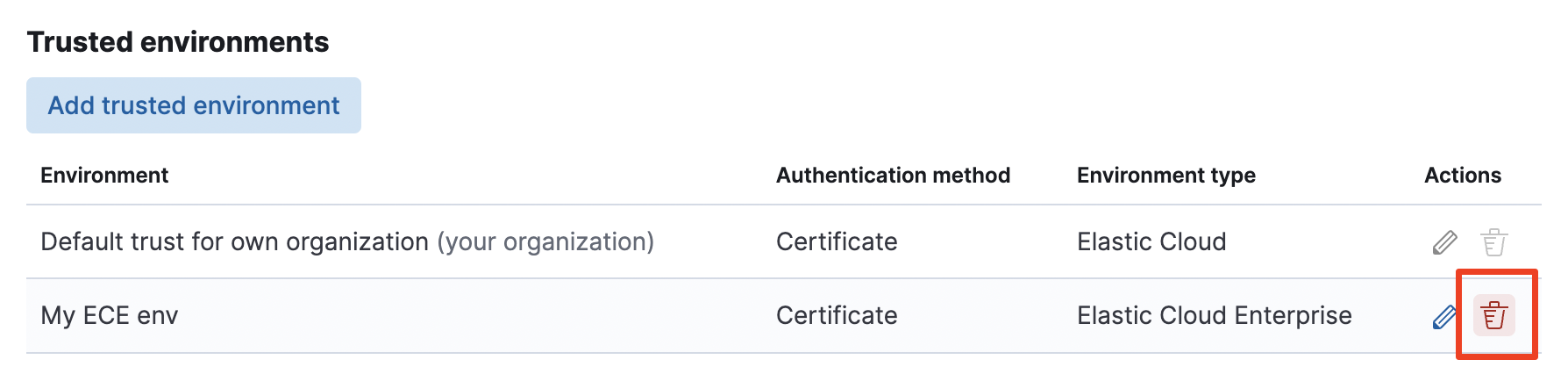

Remove a trusted environment
editBy removing a trusted environment, this deployment will no longer be able to establish remote connections using certificate trust to clusters of that environment. The remote environment will also no longer be able to connect to this deployment using certificate trust.
With this method, you can only remove trusted environments relying exclusively on certificates. To remove remote connections that use API keys for authentication, refer to Update the access level of a remote cluster connection relying on a cross-cluster API key.
- Go to the deployment’s Security page.
- In the list of trusted environments, locate the one you want to remove.
Remove it using the corresponding
deleteicon.
- In Kibana, go to Stack Management > Remote Clusters.
- In the list of existing remote clusters, delete the ones corresponding to the trusted environment you removed earlier.

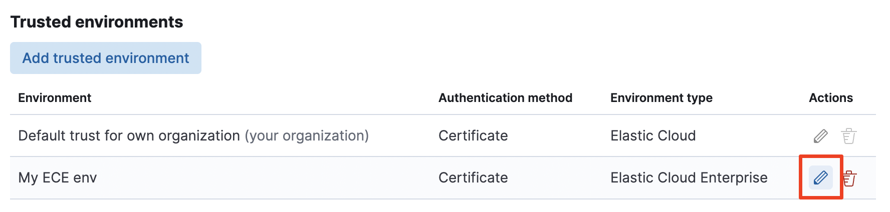

Update a certificate-based trusted environment
edit- Go to the deployment’s Security page.
- In the list of trusted environments, locate the one you want to edit.
Open its details by selecting the
Editicon.
Edit the trust configuration for that environment:
- From the Trust level tab, you can add or remove trusted deployments.
- From the Environment settings tab, you can manage the certificates and the label of the environment.
- Save your changes.
