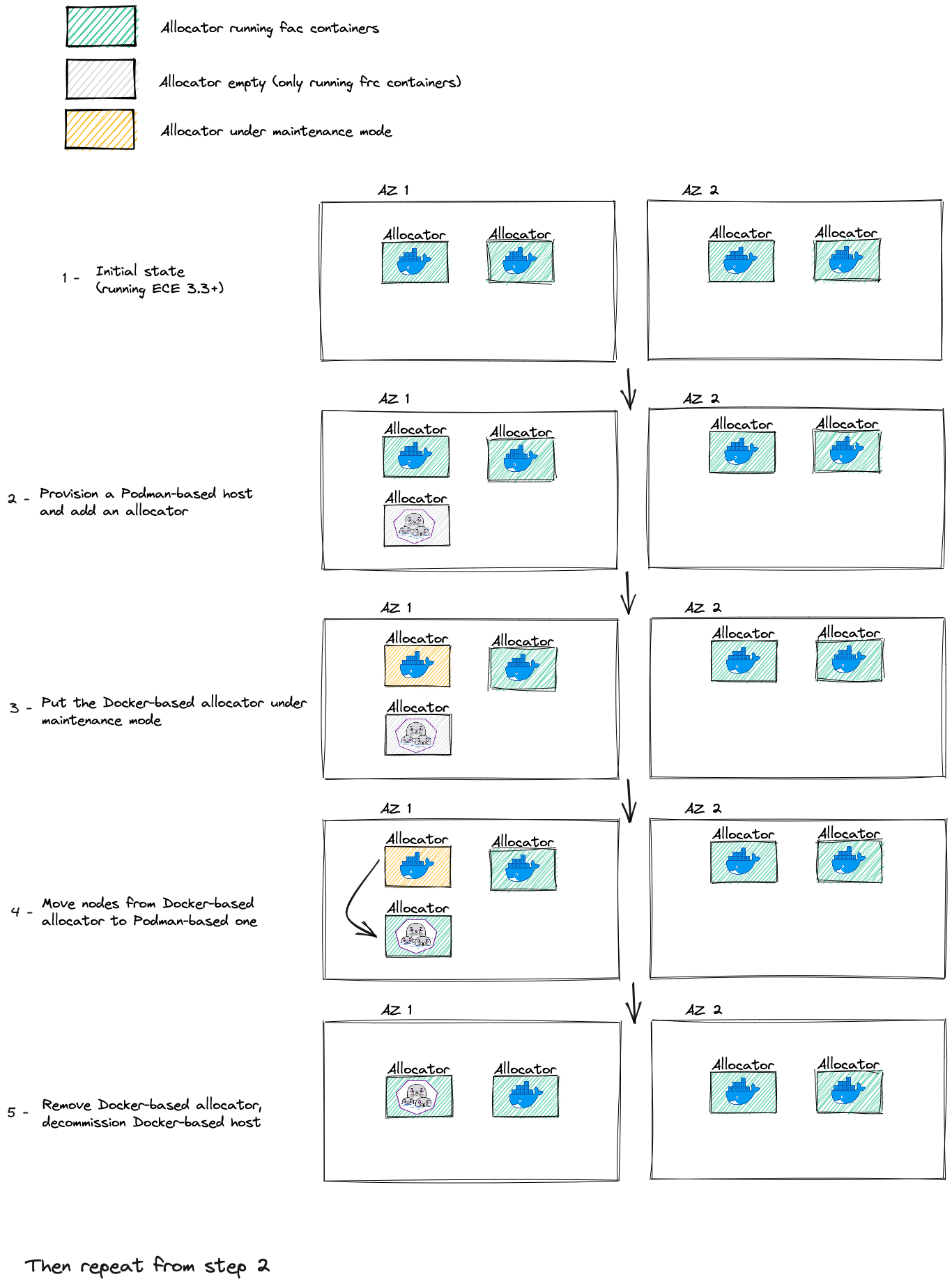

Step 3: Migrate each host one by one from Docker to Podman. This allows you to move workloads from Docker-based hosts to Podman-based ones without downtime. We highly recommend to allocate the additional Podman allocator to the same zone as the Docker allocator you want to replace. The following diagram shows the conceptual steps.

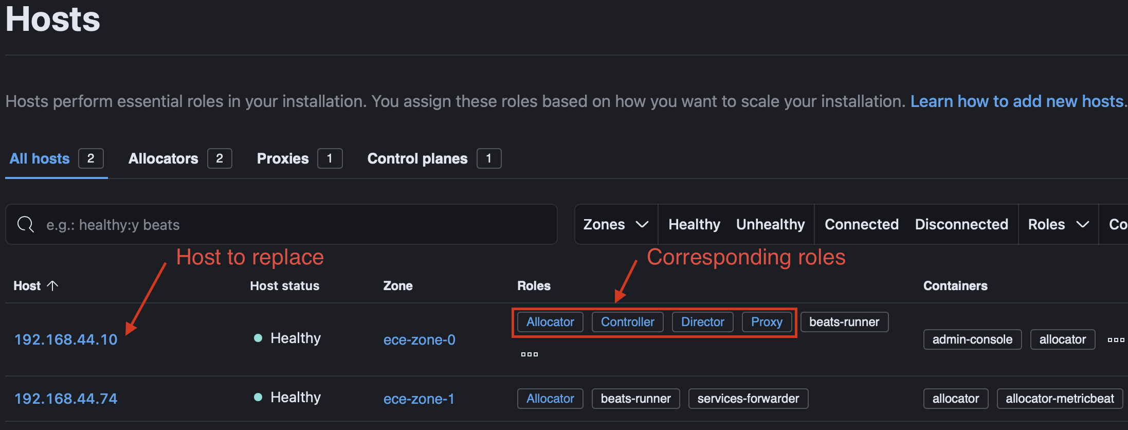

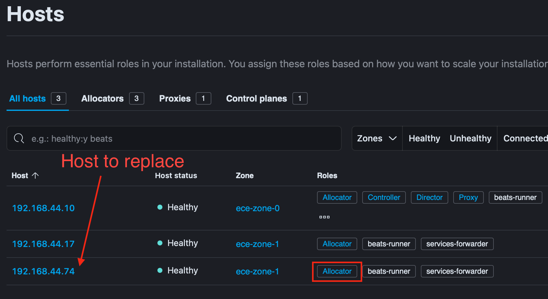

  5. Identify the host you want to replace with a podman-based host and copy the associated roles.
    Example 1 You want to migrate the Docker host 192.168.44.74 with the role Allocator to a podman host. Copy the role allocator.
    Migrate Allocator
    Example 2 You want to migrate the Docker host 192.168.44.10 with the roles Allocator, Controller, Director, and Proxy to a podman host. Copy the roles allocator, coordinator, director, proxy.

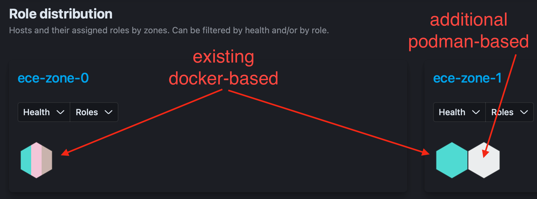

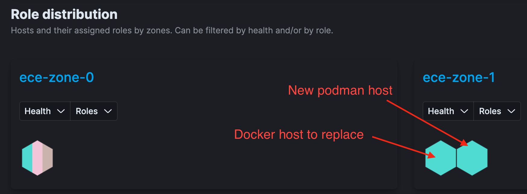

    Verify that the new podman host has the same roles (same coloring of the hexagon) as the Docker host you want to replace.
    The following screenshot shows the state where the correct roles have been applied. Both hosts in ece-zone-1 have the same color.
    Correct role
    The following screenshot shows the state where incorrect roles have been applied. The hosts in ece-zone-1 do not have the same coloring.
    Wrong role
  9. Put the docker-based allocator you want to replace with a podman allocator in maintenance mode by following the Enable Maintenance Mode documentation.
    As an alternative, use the Start maintenance mode API.

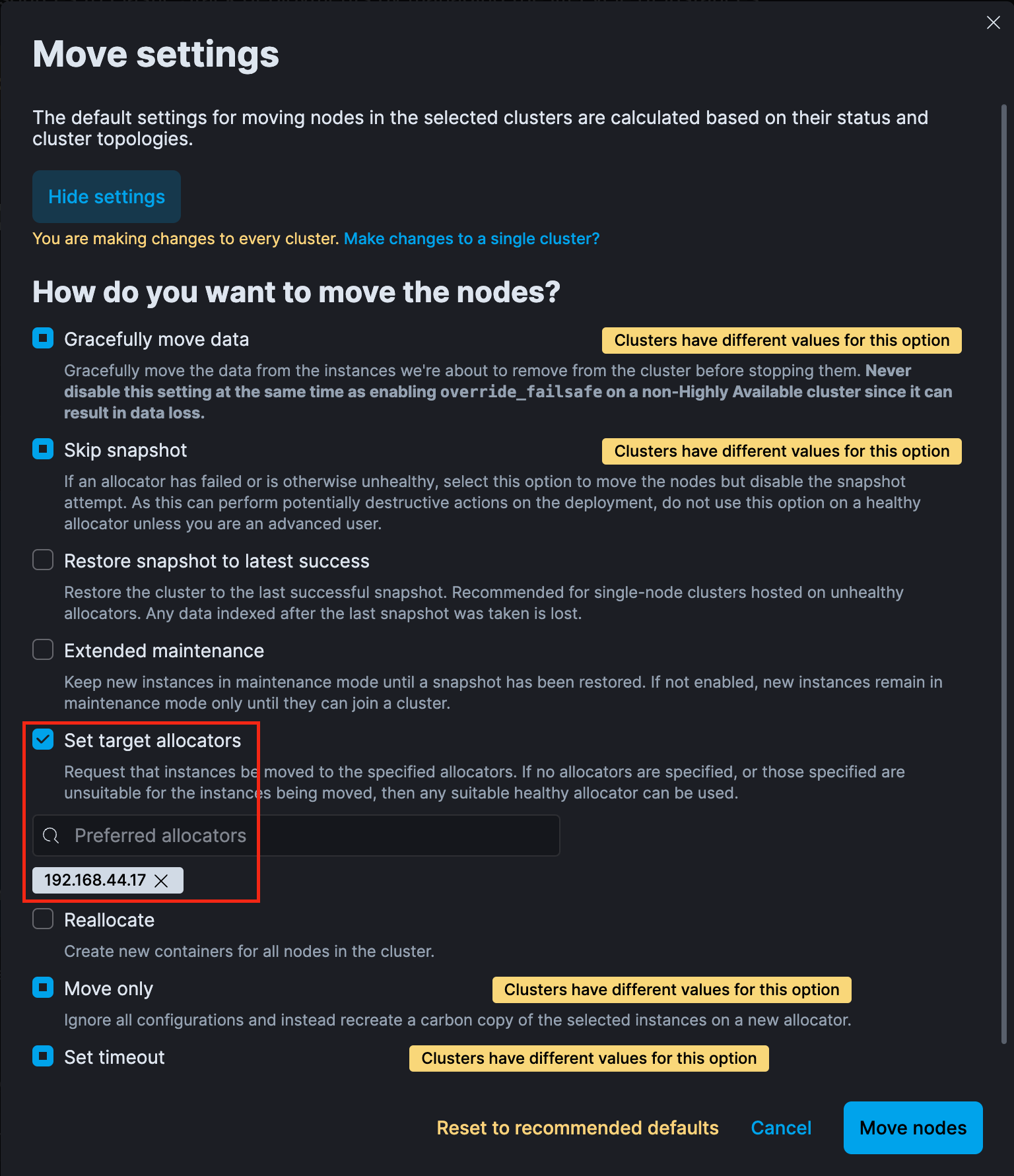

  10. Move all instances from the Docker allocator to the podman allocator by following the Move Nodes From Allocators documentation.
    Make sure to specify the target podman allocator using the option “Set target allocators”.

    Move instances
    As an alternative, use the Move clusters API.
    To identifying the correct target allocator, the following APIs might be helpful:
    • Get allocators
    • Get allocator metadata
