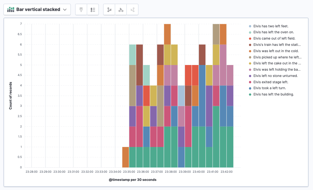

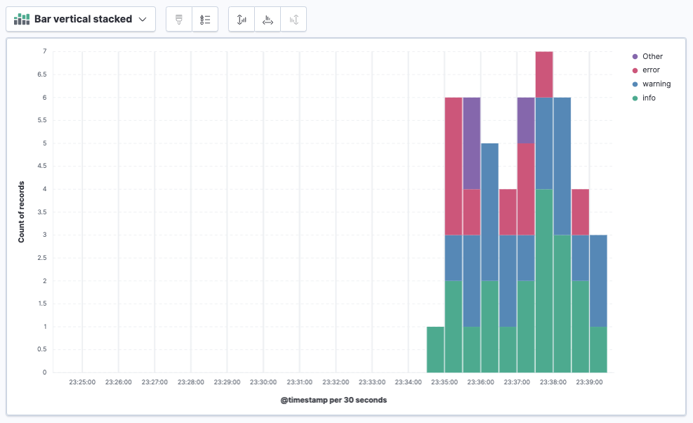

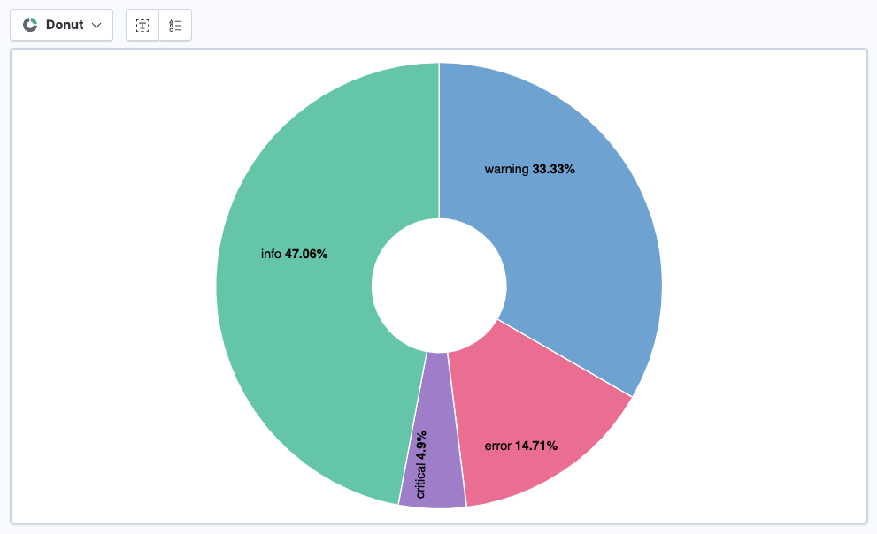

Create log visualizations in Kibana
Now it’s time to create visualizations based off of the Python application log data.
  1. Open the Kibana main menu and select Dashboard, then Create dashboard.
  2. Select Create visualization. The Lens visualization editor opens.
  3. In the data view dropdown box, select filebeat-, if it isn’t already selected.
  4. In the Visualization type dropdown, select Bar vertical stacked, if it isn’t already selected.

  6. From the Available fields list, drag and drop the @timestamp field onto the visualization builder.
  7. Drag and drop the log.level field onto the visualization builder.
  8. In the chart settings area, under Break down by, select Top values of log.level and set Number of values to 4. Since there are four log severity levels, this parameter sets all of them to appear in the chart legend.
  9. Select Refresh. A stacked bar chart now shows the relative frequency of each of the four log severity levels over time.
    A screen capture of the Kibana "Bar vertical stacked" visualization with several bars. The X axis shows "Count of records" and the Y axis shows "@timestamp per 30 seconds". Each bar is divided into the four log severity levels.

  3. From the Available fields list, drag and drop the @timestamp field onto the visualization builder.
  4. Drag and drop the http.request.body.content field onto the visualization builder.
  5. In the chart settings area, under Break down by, select Top values of http.request.body.content and set Number of values to 12. Since there are twelve different log messages, this parameter sets all of them to appear in the chart legend.
  6. Select Refresh. A stacked bar chart now shows the relative frequency of each of the log messages over time.
    A screen capture of the visualization builder

  2. In the Visualization type dropdown dropdown, select Donut.
  3. From the list of available fields, drag and drop the log.level field onto the visualization builder. A donut chart appears.
    A screen capture of a donut chart divided into four sections
  4. Select Save and return to add this visualization to your dashboard.
