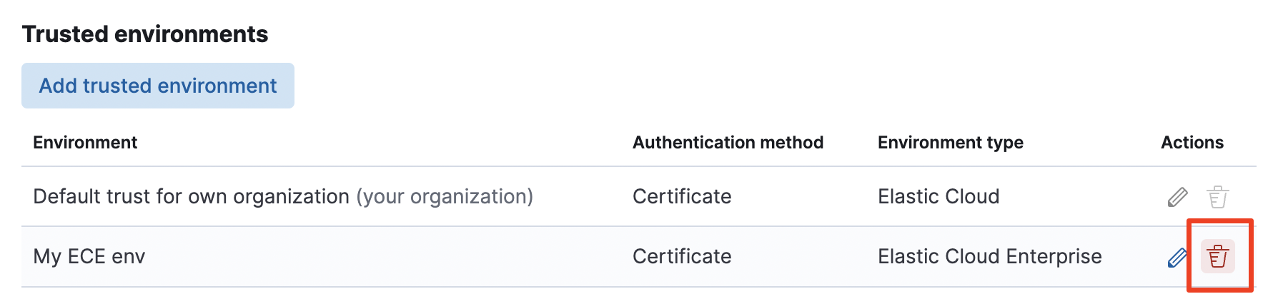

  1. Go to the deployment’s Security page.
  2. In the list of trusted environments, locate the one you want to remove.
  3. Remove it using the corresponding delete icon.
    button for deleting a trusted environment
  4. In Kibana, go to Stack Management > Remote Clusters.
  5. In the list of existing remote clusters, delete the ones corresponding to the trusted environment you removed earlier.

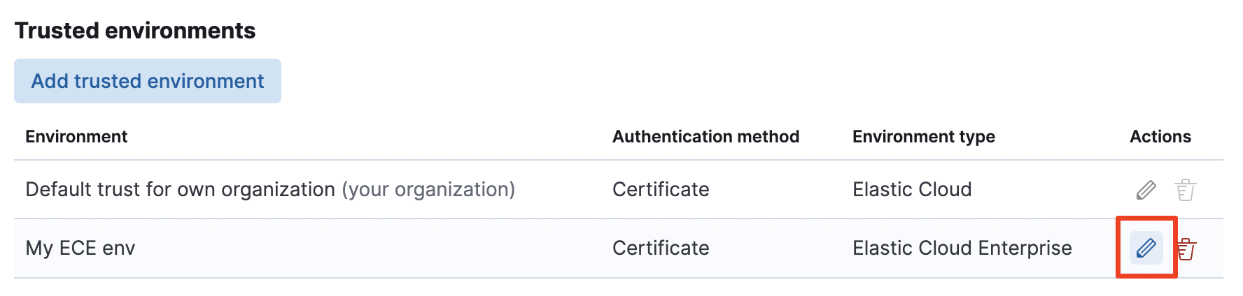

  2. In the list of trusted environments, locate the one you want to edit.
  3. Open its details by selecting the Edit icon.
    button for editing a trusted environment
  4. Edit the trust configuration for that environment:
    • From the Trust level tab, you can add or remove trusted deployments.
    • From the Environment settings tab, you can manage the certificates and the label of the environment.
  5. Save your changes.
