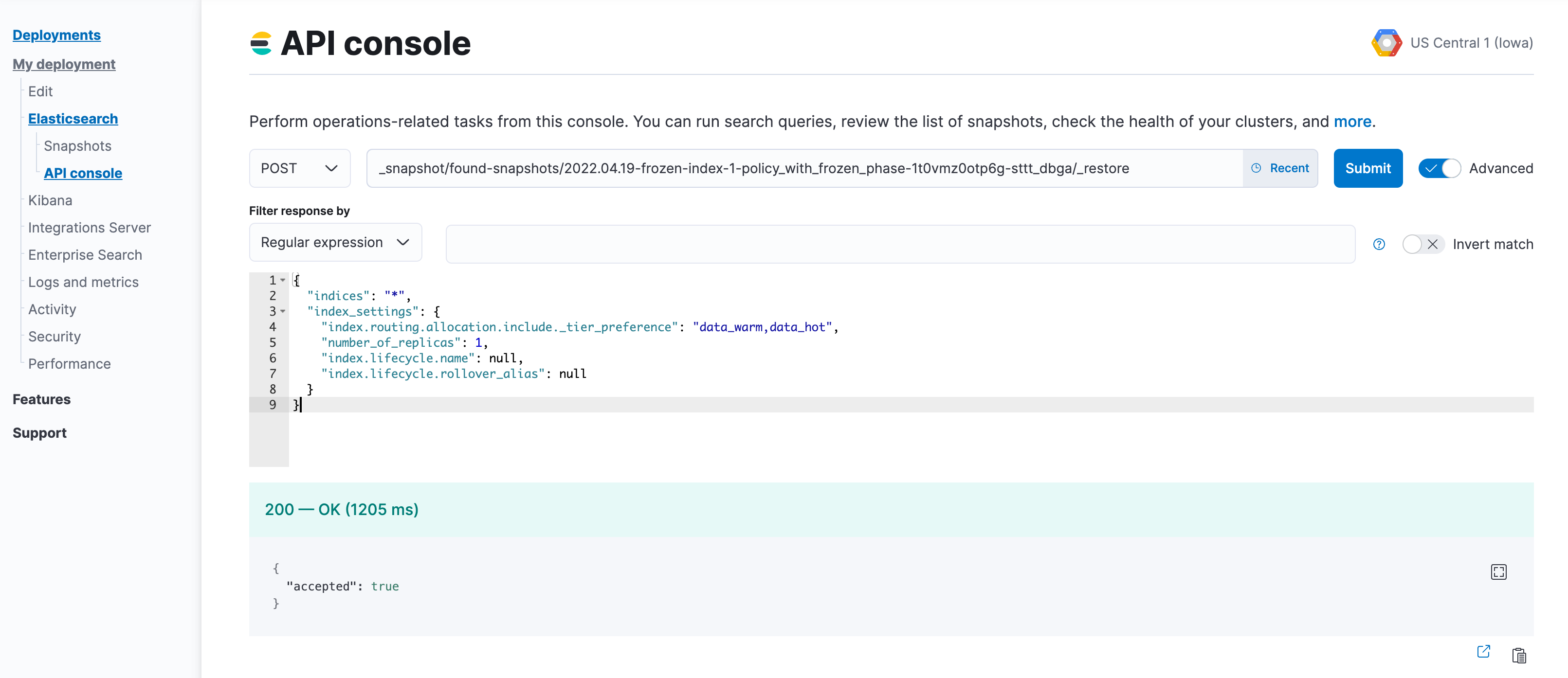

      POST _snapshot/found-snapshots/<searchable_snapshot_name>/_restore
        "indices": "*",
        "index_settings": {
          "index.routing.allocation.include._tier_preference": "<data_tiers>",
          "number_of_replicas": X,
          "index.lifecycle.name": "<new-policy-name>",
          "index.lifecycle.rollover_alias": "<alias-for-rollover>"
      The <searchable_snapshot_name> refers to the above-mentioned step: "Capture a comprehensive list of index and searchable snapshot names".
      In the example we are restoring frozen-index-1 from the snapshot in found-snapshots (default snapshot repository) and placing it in the warm tier.
      A screenshot showing the process of restoring a searchable snapshot to a regular index
