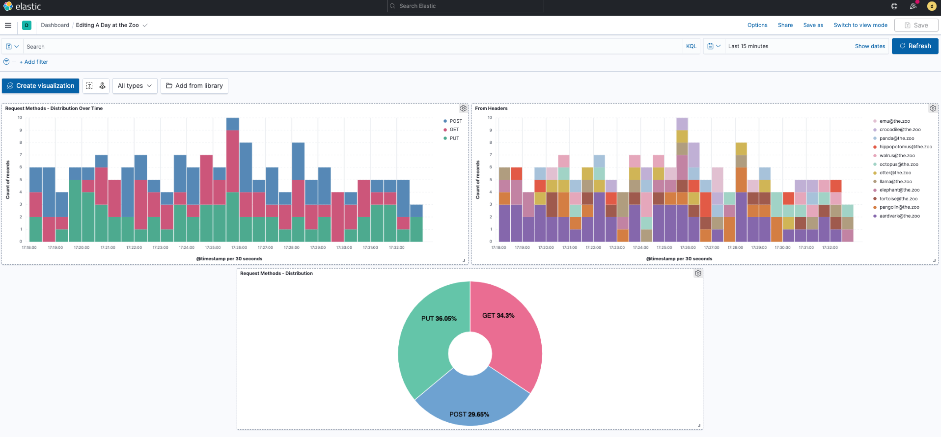

Create log visualizations in Kibanaedit
Now it’s time to create visualizations based off of the application log data.
- Open the Kibana main menu and select Dashboard, then Create dashboard.
- Select Create visualization. The Lens visualization editor opens.
- In the data view dropdown box, select filebeat-*, if it isn’t already selected.
- In the CHART TYPE dropdown box, select Bar vertical stacked, if it isn’t already selected.
- Check that the time filter is set to Last 15 minutes.

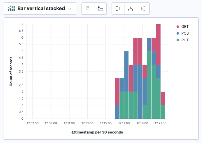

- From the Available fields list, drag and drop the @timestamp field onto the visualization builder.
- Drag and drop the http.request.method field onto the visualization builder.
A stacked bar chart now shows the relative frequency of each of the three request methods used in our example, measured over time.
- Select Save and return to add this visualization to your dashboard.
Let’s create a second visualization.
- Again, make sure that CHART TYPE is set to Bar vertical stacked.

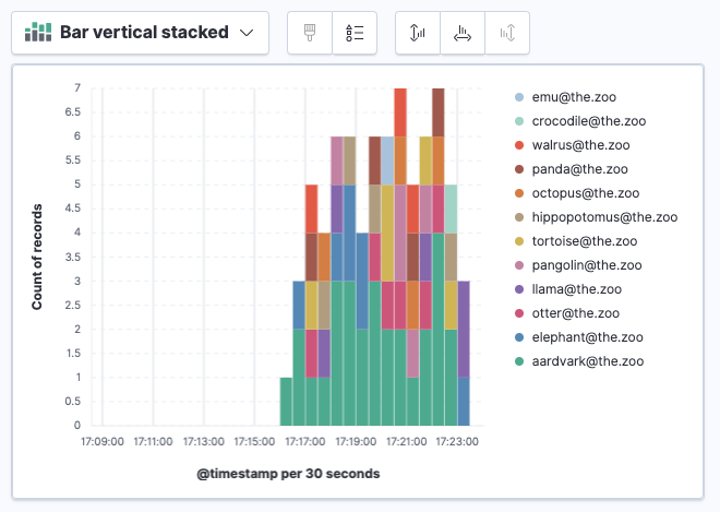

- Drag and drop the http.request.headers.from field onto the visualization builder.
- In the chart settings area, under Break down by, select Top values of http.request.headers.from and set Number of values to 12. In this example there are twelve different email addresses used in the HTTP from header, so this parameter sets all of them to appear in the chart legend.
Select Refresh. A stacked bar chart now shows the relative frequency of each of the HTTP from headers over time.
And now for the final visualization.

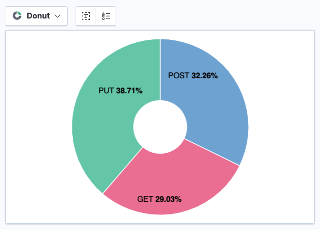

- In the CHART TYPE dropdown box, select Donut.
From the list of available fields, drag and drop the http.request.method field onto the visualization builder. A donut chart appears.
- Select Save and add a title to save your new dashboard.
You now have a Kibana dashboard with three visualizations: a stacked bar chart showing the frequency of each HTTP request method over time, another stacked bar chart showing the frequency of various HTTP from headers over time, and a donut chart showing the relative frequency of each HTTP request method type.
You can add titles to the visualizations, resize and position them as you like, and then save your changes.

continues to generate log data, and your Kibana visualizations update with that data with each page refresh. - As your final step, remember to stop Filebeat, the Node.js web server, and the client. Enter CTRL + C in the terminal window for each application to stop them.
You now know how to monitor log files from a Node.js web application, deliver the log event data securely into an Elastic Cloud Enterprise deployment, and then visualize the results in Kibana in real time. Consult the Filebeat documentation to learn more about the ingestion and processing options available for your data. You can also explore our documentation to learn all about working in Elastic Cloud Enterprise.
