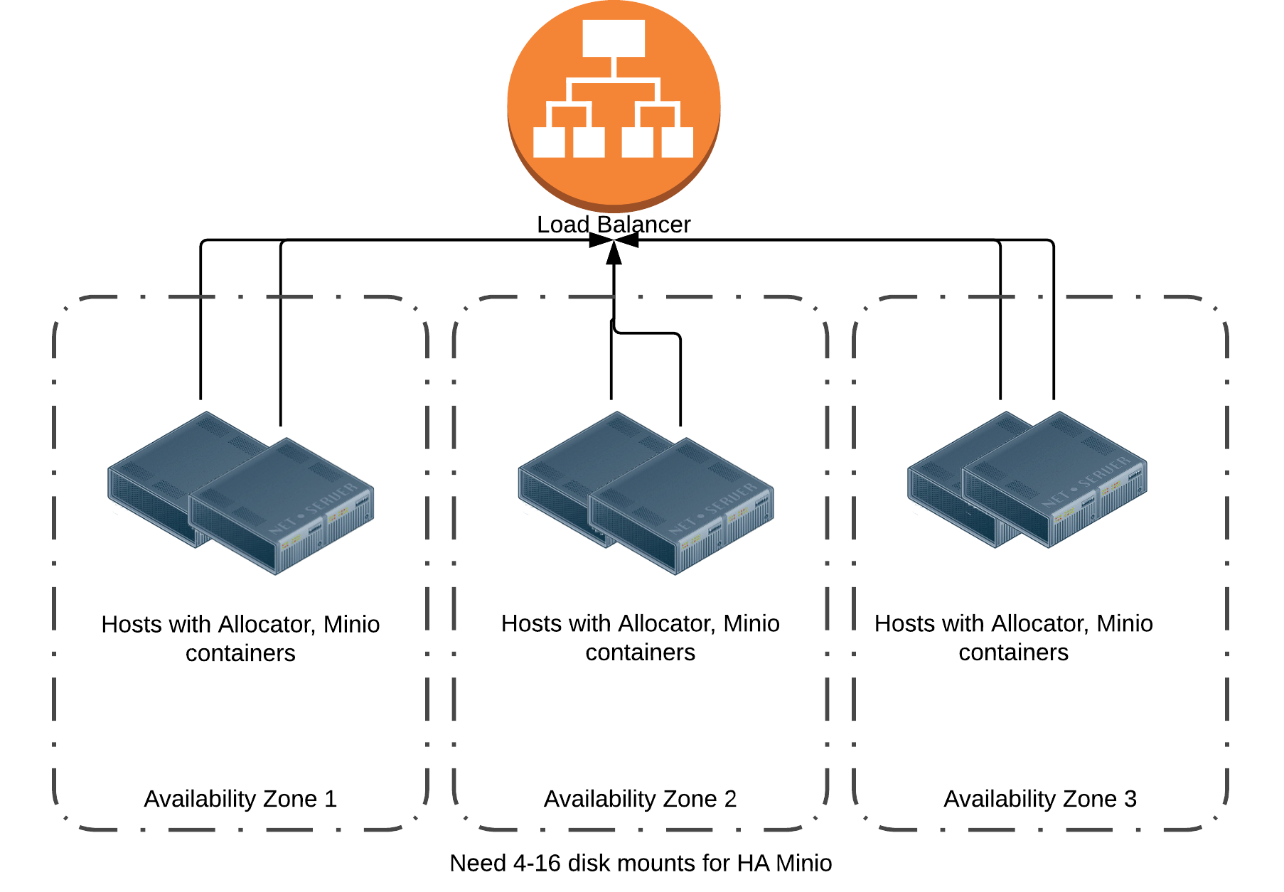

Installing Minio for production requires a high-availability configuration where Minio is running in Distributed mode.
As mentioned in the Minio documentation, you will need to have 4-16 Minio drive mounts. There is no hard limit on the number of Minio nodes. It might be convenient to place the Minio node containers on your ECE hosts to ensure you have a suitable level of availability, but those can not be located on the same hosts as ECE proxies since they both listen on the same port.
The following illustration is a sample architecture for a large ECE installation. Note that there is at least one MinIO container in each availability zone.
There are a number of different ways of orchestrating the Minio deployment (Docker Compose, Kubernetes, and so on). We suggest you use the method most familiar to you.
We recommend:
- Using a single Minio endpoint with the Elastic Cloud Enterprise installation, to simplify repository management.
- Securing access to the Minio endpoint with TLS.
![Architecture diagram](images/ece-minio-large-arch.png)

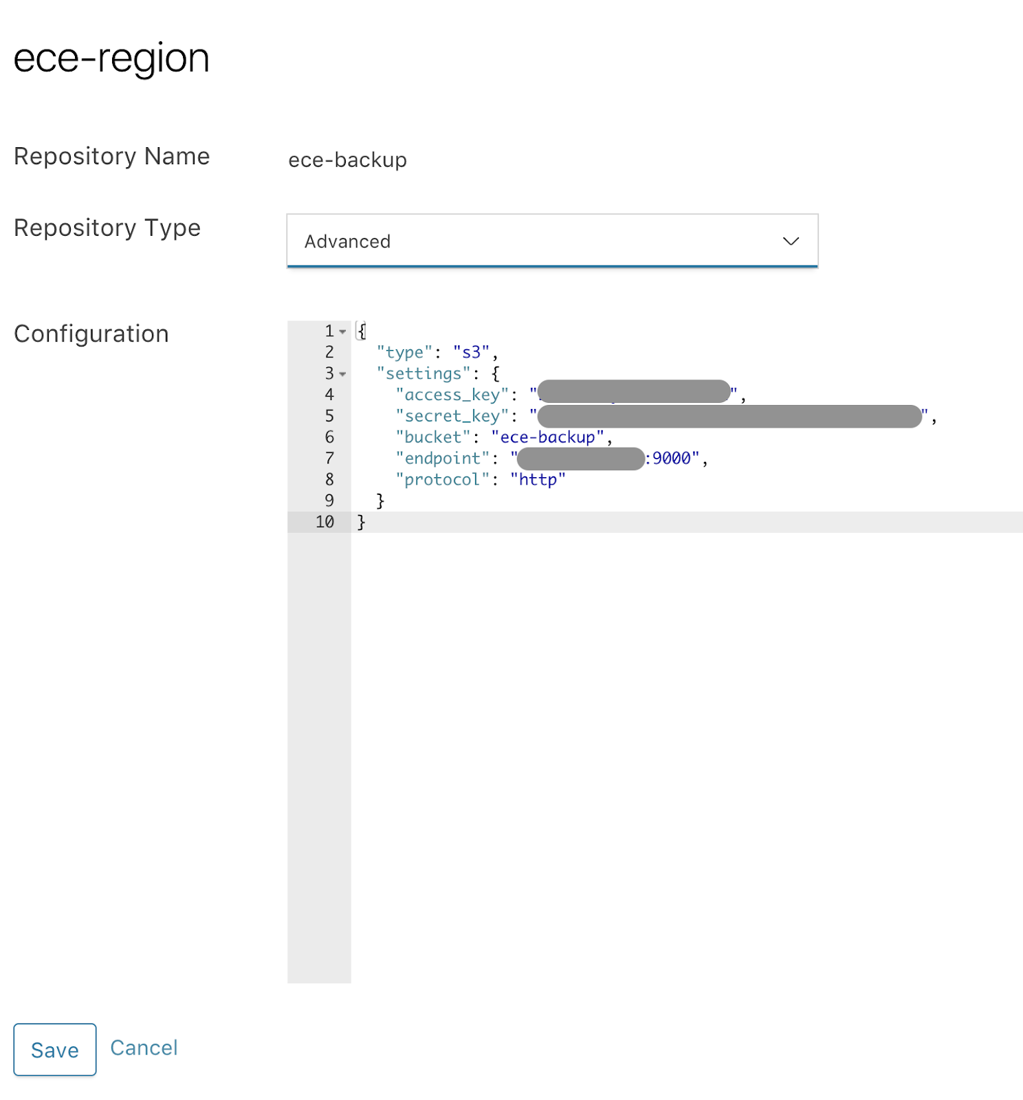

Add the repository to Elastic Cloud Enterpriseedit
You must add the new repository to Elastic Cloud Enterprise before it can be used with your Elasticsearch clusters.
- Log into the Cloud UI.
- From the Platform menu, select Repositories.
- Select Add Repository.
- From the Repository Type drop-down list, select Advanced.
In the Configuration text area, provide the repository JSON. You must specify the bucket, access_key, secret_key, endpoint, and protocol.
{ "type": "s3", "settings": { "bucket": "ece-backup", "access_key": "<your Minio AccessKey>", "secret_key": "<your Minio SecretKey>", "endpoint": "<your Minio endpoint URL>:9000", "path_style_access": "true", "protocol": "http" } }
- Select Save to submit your configuration.

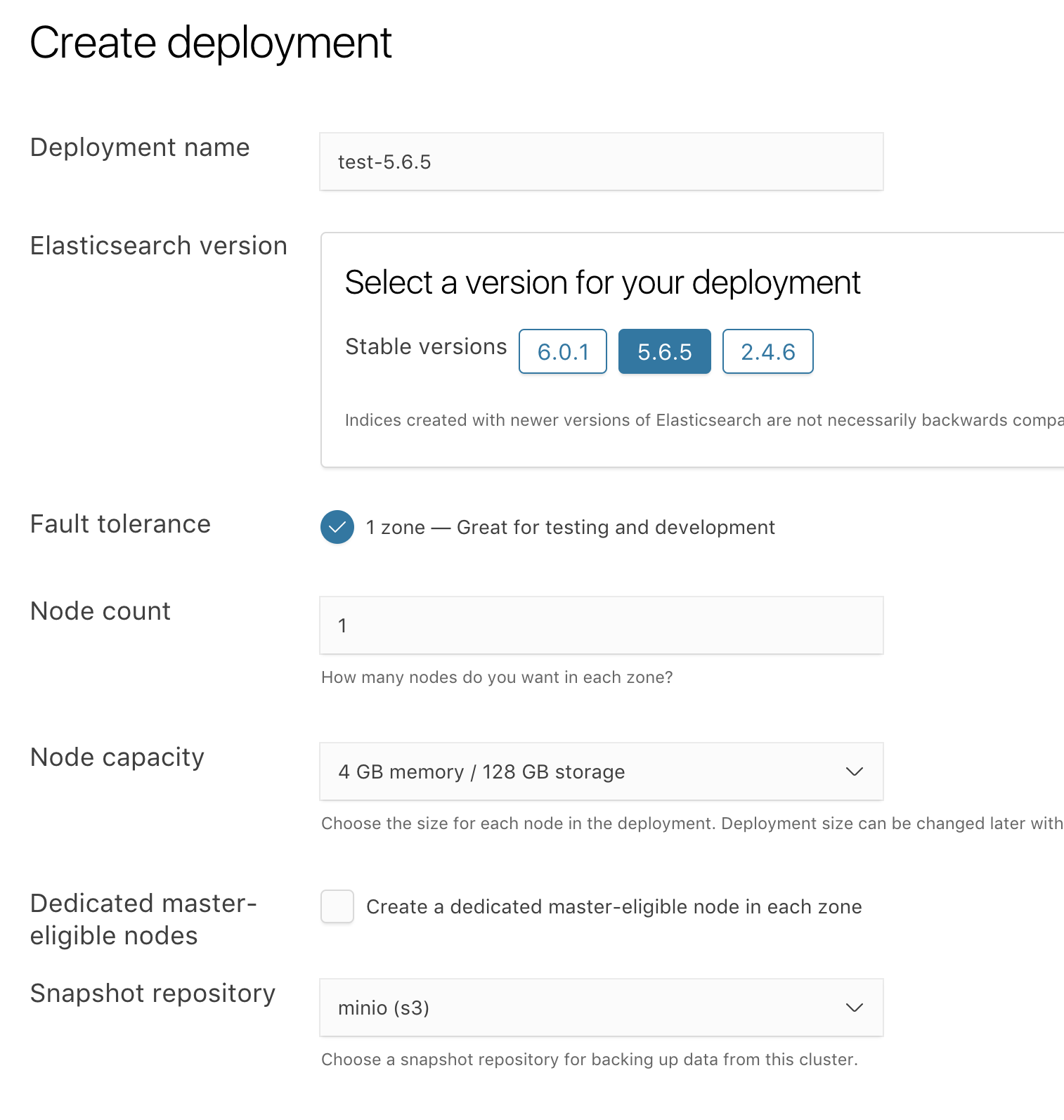

The Minio repository is now available from the drop-down list of repositories when creating deployments.
![Create deployment](images/ece-minio-deployment.png)
