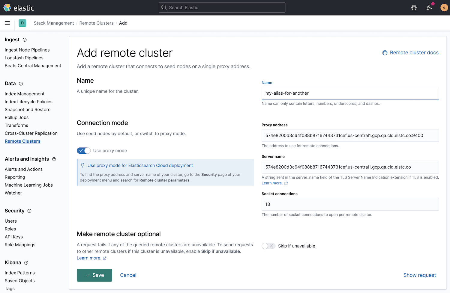

Configure remote clusters using Kibana
editYou can configure remote clusters in Kibana starting with version 7.7.0 (for any deployment except deployments using the deprecated CCS deployment template):
Open the Stack Management section and select Remote Clusters from the side navigation.
To add a new remote cluster, fill in the following fields:
- Name: this is the alias you will use to run CCS queries.
- Proxy Address: This value can be found on the Security page of the deployment you want to use as a remote.
- Server Name: This value can be found on the Security page of the deployment you want to use as a remote.
This mechanism will work for remote clusters in other ECE environments as long as they trust each other.
This configuration of remote clusters uses the Proxy mode and it requires that the allocators can communicate via http with the proxies.
