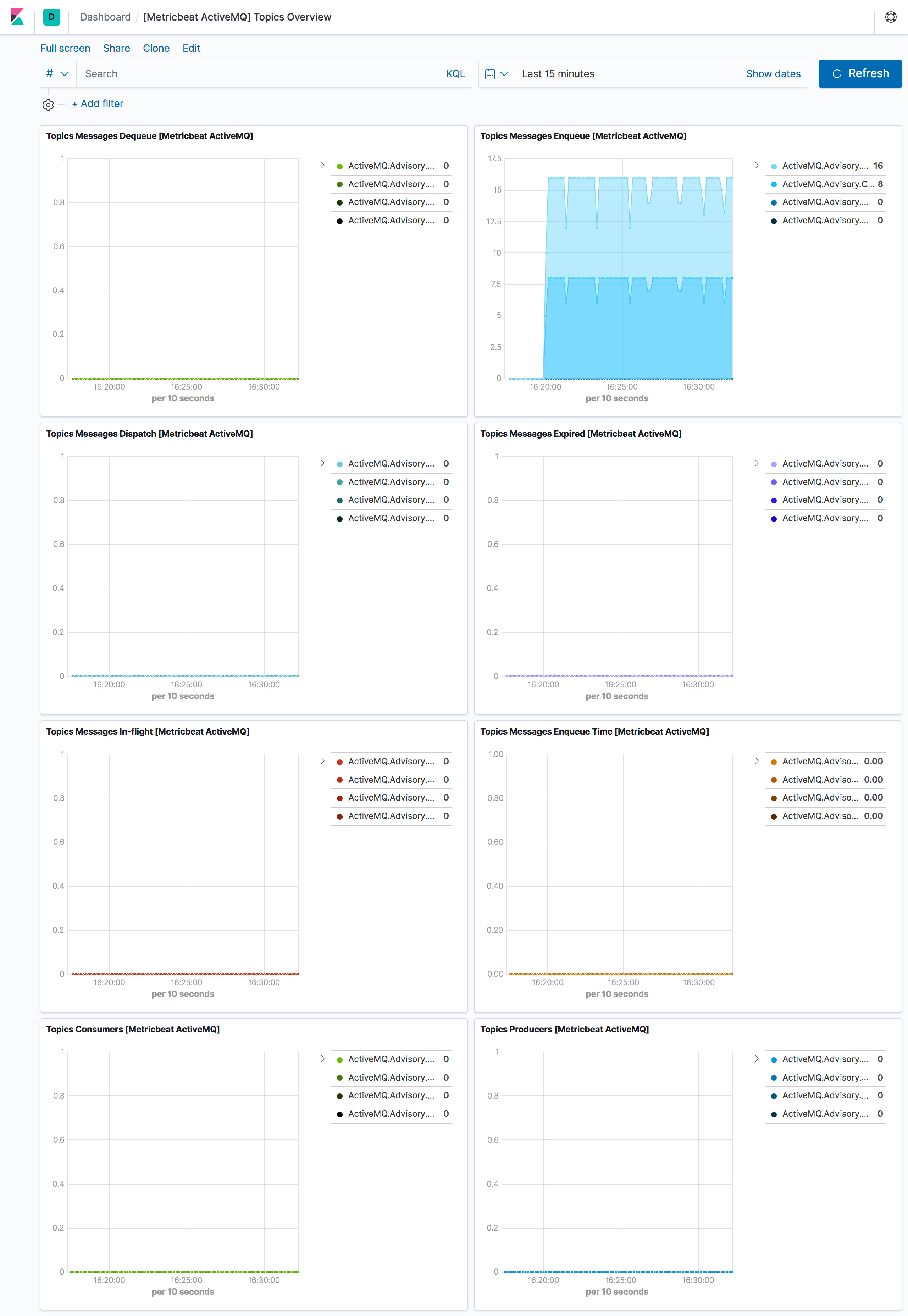

The topic metricset comes with a predefined dashboard:
