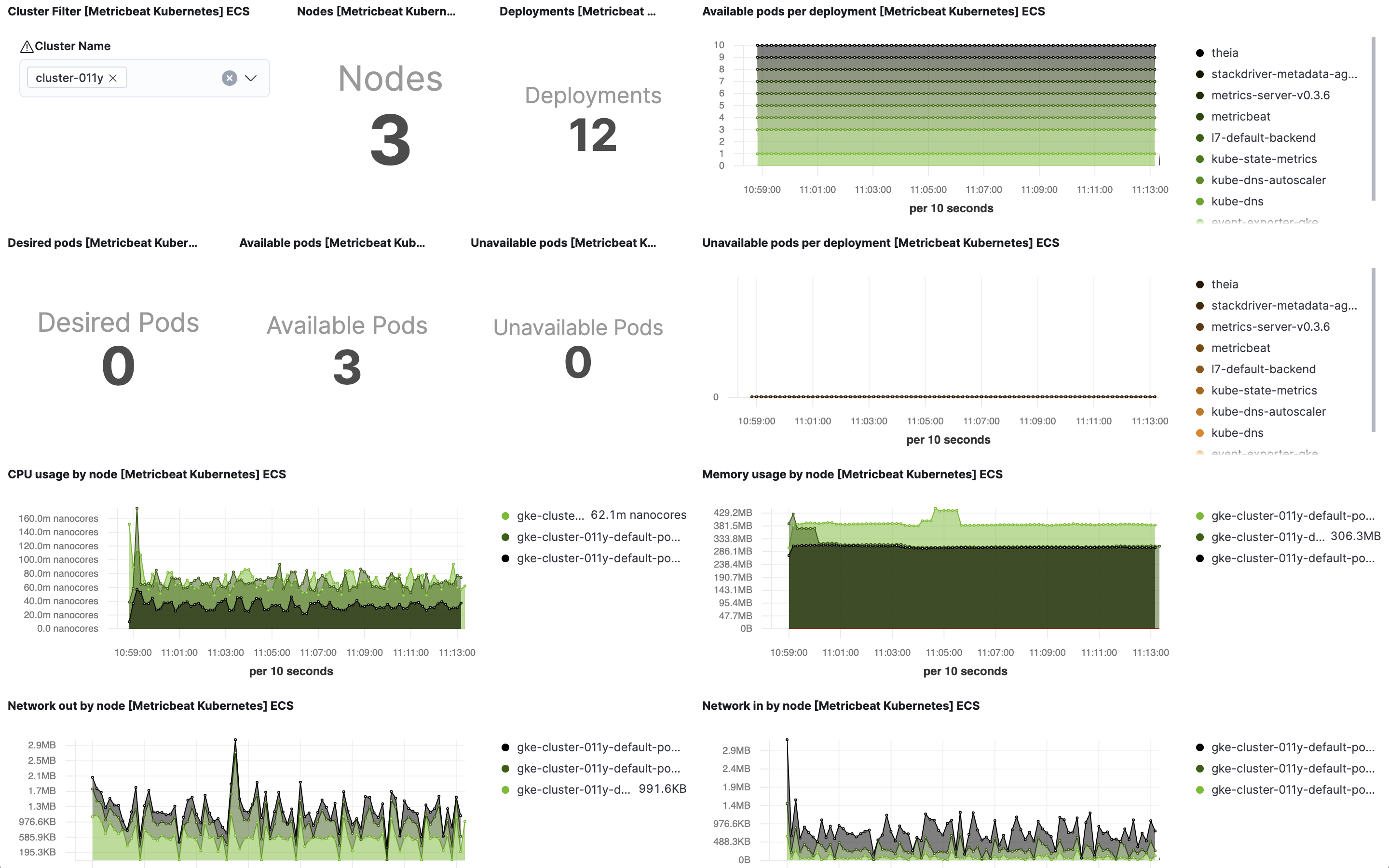

Kubernetes cluster overview example:
If you are setting collection period to a value bigger than 2m
you will need to increase
the Interval (in Panel Options) for "Desired Pods", "Available Pods" and "Unavailable Pods" visualisations.

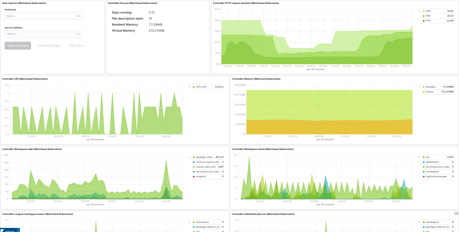

Kubernetes controller manager example:

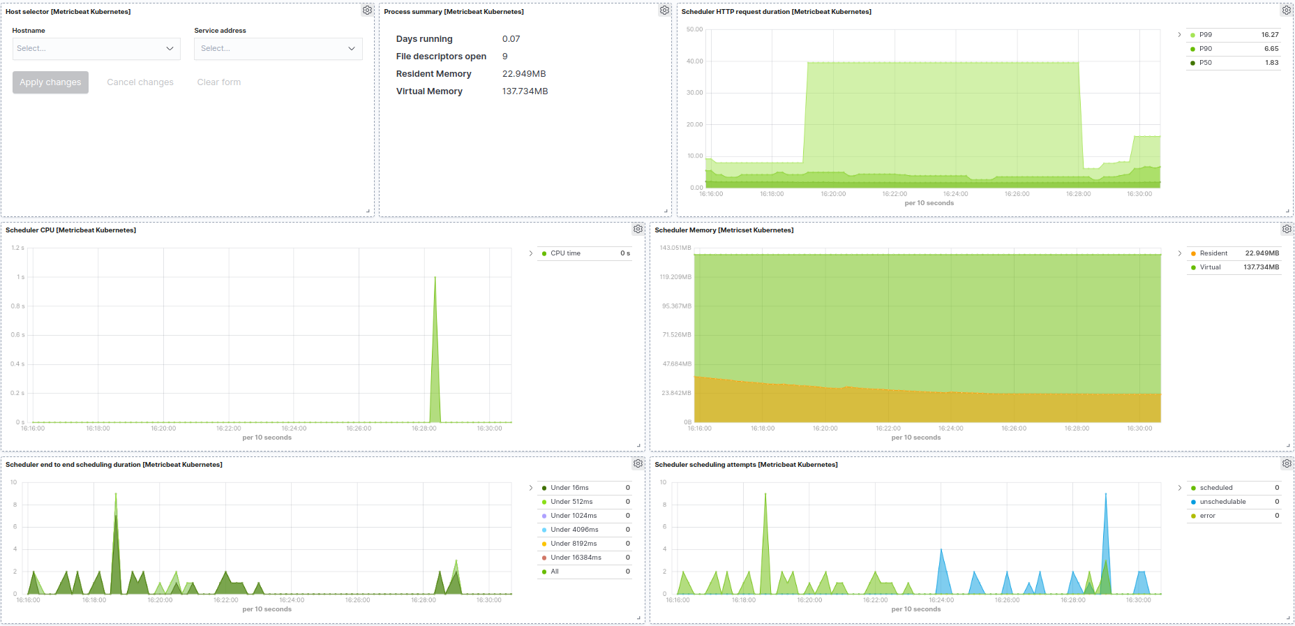

Kubernetes scheduler example:

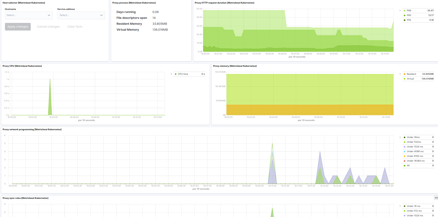

Kubernetes proxy example:
