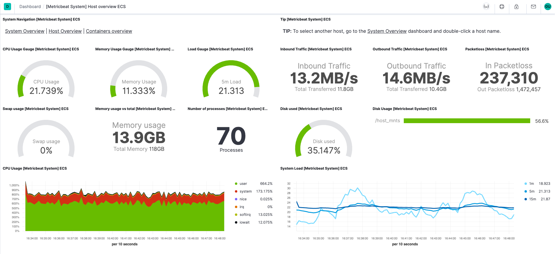

Metricbeat System dashboard

Step 6: View your data in Kibanaedit
Metricbeat comes with pre-built Kibana dashboards and UIs for visualizing log data. You loaded the dashboards earlier when you ran the setup command.
To open the dashboards:
  1. Launch Kibana:
    1. Log in to your Elastic Cloud account.
    2. Navigate to the Kibana endpoint in your deployment.
  2. In the side navigation, click Discover. To see Metricbeat data, make sure the predefined metricbeat-* index pattern is selected.
    If you don’t see data in Kibana, try changing the time filter to a larger range. By default, Kibana shows the last 15 minutes.
  3. In the side navigation, click Dashboard, then select the dashboard that you want to open.
