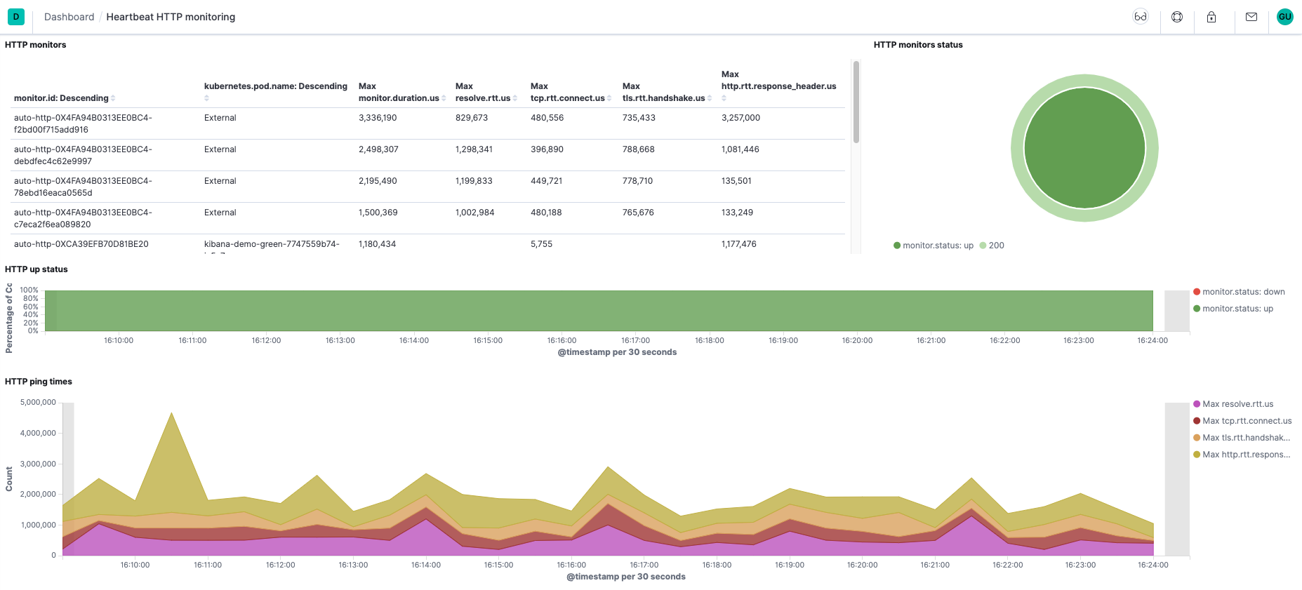

Step 7: View your data in Kibana
editHeartbeat comes with pre-built Kibana dashboards and UIs for visualizing the status of your services. The dashboards are available in the uptime-contrib GitHub repository.
If you loaded the dashboards earlier, open them now.
To open the dashboards:
Launch Kibana:
- Log in to your Elastic Cloud account.
- Navigate to the Kibana endpoint in your deployment.
Point your browser to http://localhost:5601, replacing
localhost
with the name of the Kibana host. -
In the side navigation, click Discover. To see Heartbeat data, make sure the predefined
heartbeat-*
data view is selected.If you don’t see data in Kibana, try changing the time filter to a larger range. By default, Kibana shows the last 15 minutes.
- In the side navigation, click Dashboard, then select the dashboard that you want to open.
