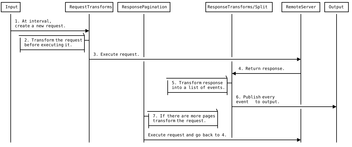

HTTP JSON inputedit
Use the httpjson
input to read messages from an HTTP API with JSON payloads.
This input supports:
Auth
- Basic
- OAuth2
- Retrieval at a configurable interval
- Pagination
- Retries
- Rate limiting
- Proxying
- Request transformations
- Response transformations

Input stateedit
The httpjson
input keeps a runtime state between requests. This state can be accessed by some configuration options and transforms.
The state has the following elements:
last_response.url.value
: The full URL with params and fragments from the last request with a successful response. -
last_response.url.params
: A map containing the params from the URL inlast_response.url.value
last_response.header
: A map containing the headers from the last successful response. -
last_response.body
: A map containing the parsed JSON body from the last successful response. This is the response as it comes from the remote server. -
last_response.page
: A number indicating the page number of the last response. -
first_event
: A map representing the first event sent to the output (result from applying transforms tolast_response.body
last_event
: A map representing the last event sent to the output (result from applying transforms tolast_response.body
url
: The last requested URL as a rawurl.URL
Go type. -
header
: A map containing the headers. References the next request headers when used inrequest.transforms
orresponse.pagination
configuration sections, and to the last response headers when used inresponse.transforms
,response.split
, orrequest.rate_limit.limit
configuration sections. -
body
: A map containing the body. References the next request body when used inrequest.transforms
configuration sections, and to the last response body when used inresponse.transforms
orresponse.split
cursor
: A map containing any data the user configured to be stored between restarts (Seecursor
All of the mentioned objects are only stored at runtime, except cursor
, which has values that are persisted between restarts.
Transformsedit
A transform is an action that lets the user modify the input state. Depending on where the transform is defined, it will have access for reading or writing different elements of the state.
The access limitations are described in the corresponding configuration sections.

Request life cycleedit
- At every defined interval a new request is created.
The request is transformed using the configured
request.transforms
. - The resulting transformed request is executed.
- The server responds (here is where any retry or rate limit policy takes place when configured).
The response is transformed using the configured
response.transforms
andresponse.split
. - Each resulting event is published to the output.
If a
response.pagination
is configured and there are more pages, a new request is created using it, otherwise the process ends until the next interval.
