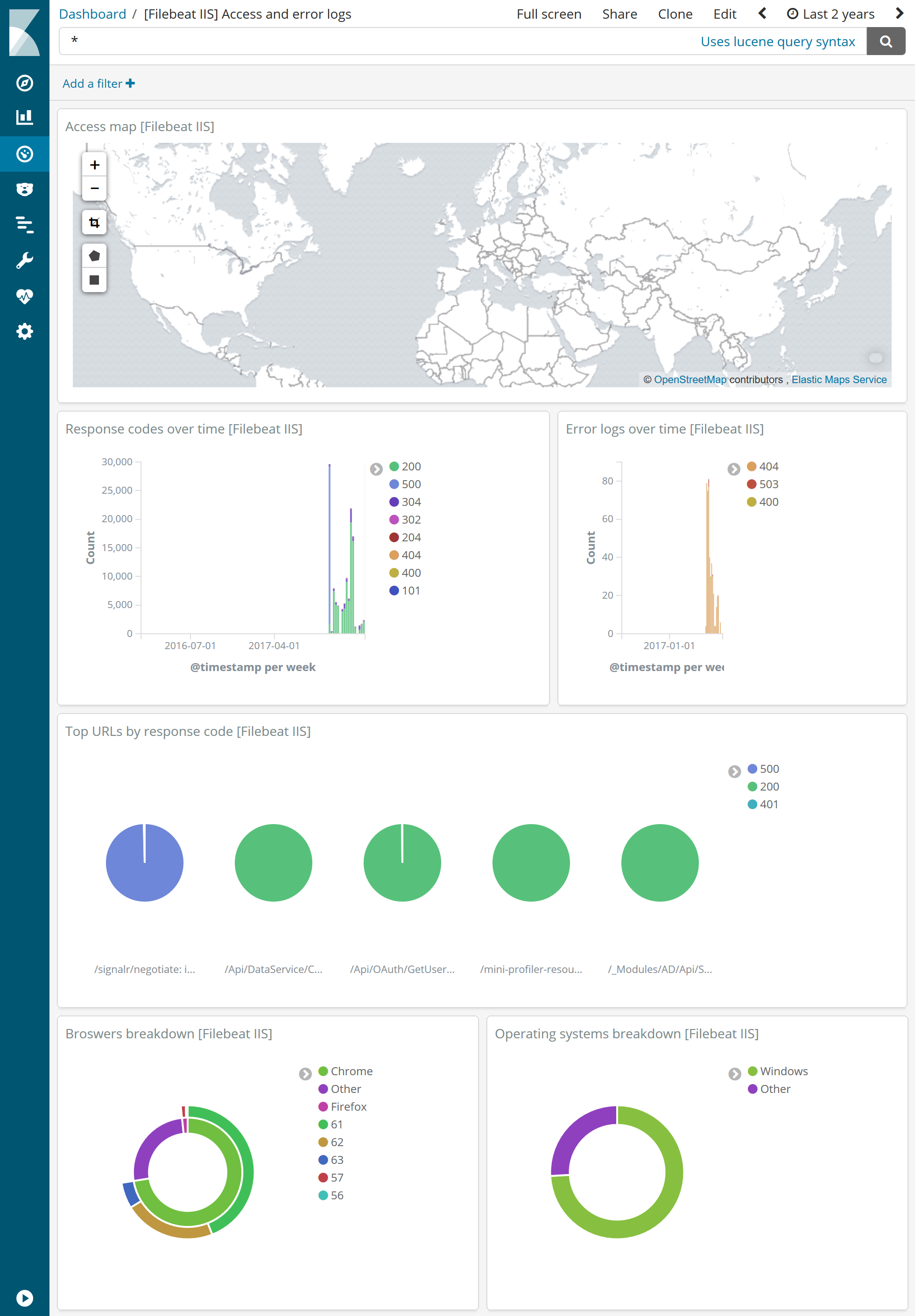

Example dashboard
editThis module comes with a sample dashboard. For example:
