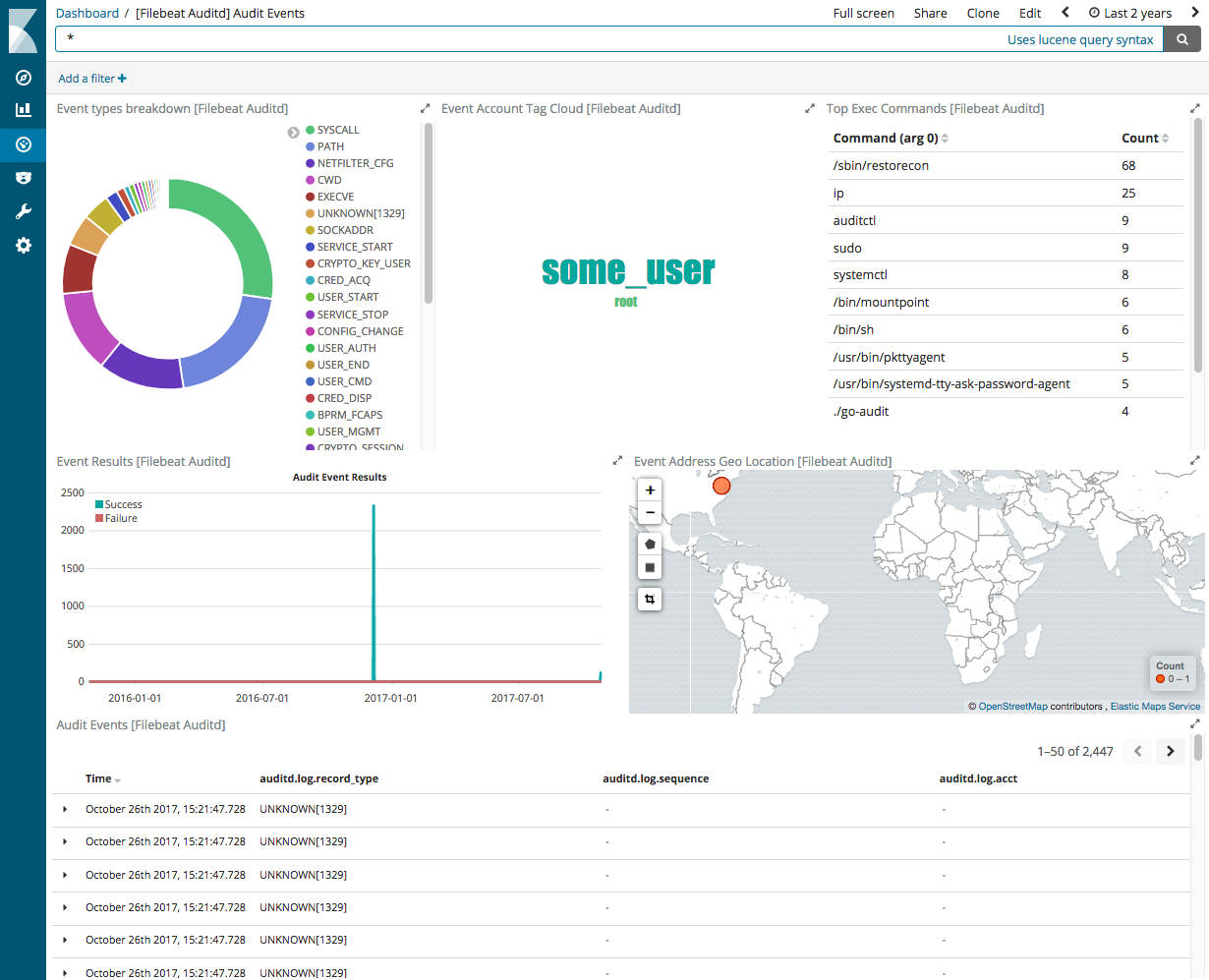

Example dashboard
editThis module comes with a sample dashboard showing an overview of the audit log data. You can build more specific dashboards that are tailored to the audit rules that you use on your systems.
