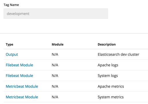

A configuration tag is a group of configuration blocks that you can apply to
one or more Beats. A tag can have configuration blocks for different types of
Beats. For example, you might have a tag called development
that you use to
group all configurations that are valid for running Beats in your development
environment. The development
tag might have:
- Two Metricbeat module configuration blocks: one that reads system metrics and another that reads metrics from Apache HTTP servers
- Two Filebeat module configuration blocks: one that reads Apache HTTP server logs and another that reads system logs
- One Elasticsearch output configuration block that sends the output to your Elasticsearch development cluster

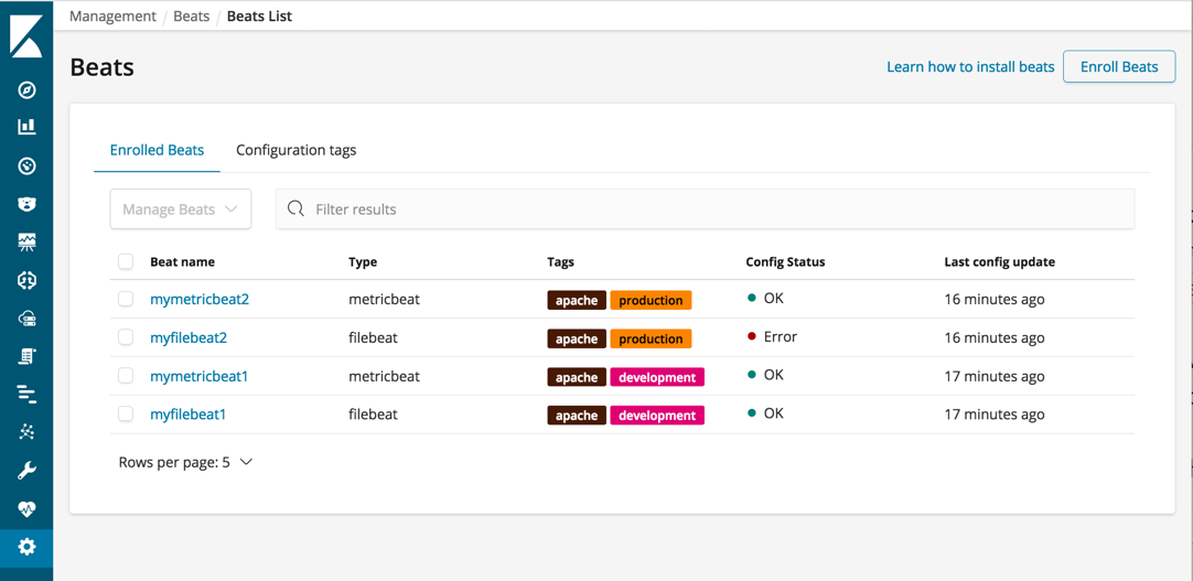

You apply the tag to any Beats that will use the configurations defined in the tag.
When the enrolled Beats run, each Beat uses the configuration blocks that are valid for its type.

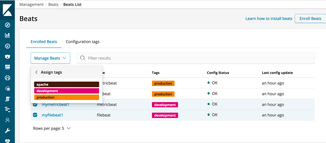

You can add or remove tags to change the set of configuration blocks applied to
your Beats. For example, after you’ve tested configurations in your
development
environment, you can remove the development
tag and add a
production
tag that has an Elasticsearch output configuration block for sending the
data to your production cluster.

You can apply as many tags as you need. Just keep in mind that the configurations for all assigned tags are merged, which means that you should not specify conflicting configurations. If there are errors in the configuration, you’ll see an Error status in the Central Management UI and need to look at the logs for the Beat to troubleshoot the problem.
