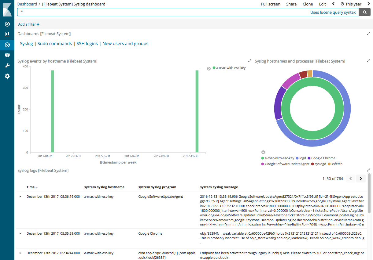

Example dashboardsedit
This module comes with sample dashboards. For example:
![kibana system](./images/kibana-system.png)
